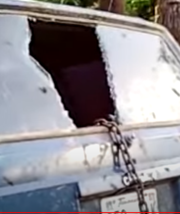

That's been my experience as well. My understanding was the line has to store energy by elastic stretching in order to whip and chains don't have much elasticity and lots of inertia to overcome which soaks up what little elasticity it has
/ Pulling tree out with wheel & chain?
#40
I've not experienced a chain whipping, it pretty much just drops. Now wire rope, that would be a different story.
A chain can definitely "fly", but I doubt it'll gain aerodynamic properties like a flying cable can... but it can go rapidly from the break point which can result in upward motion
Here's a worse example - screenshot from (
Note in both of these cases, they "jerked" the chain hard.
I suspect in most cases of a properly used chain (no jerking) that the chain will just drop flat, but it's definitely worthwhile to blanket or otherwise limit the ability of a broken puller (chain, strap, cable, rope) from flying.
