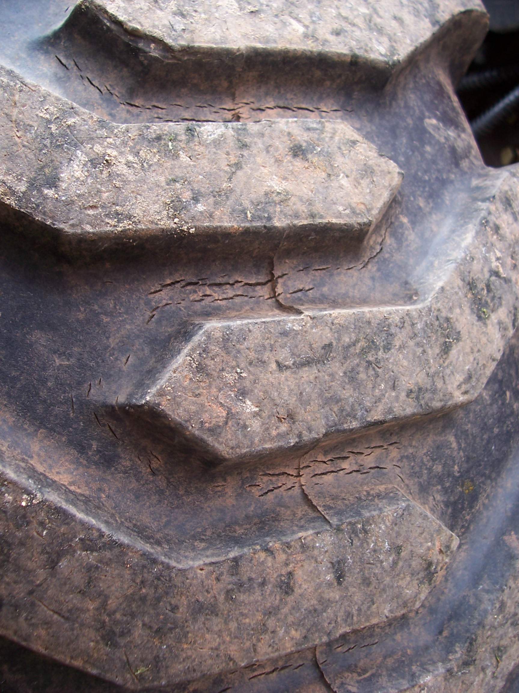

The front tires on my brand new Kioti DK45SC started showing cracks between the treads the first winter I owned it. The dealer said it was superficial rubber shrinkage...yeah, right.
BOB

/ Treating Tires For Weathering #7
I replaced a 25 yr old set of Goodyears on a trailer with a new set of rubber. Three years later the new tires looked worse for cracks than the old Goodyears...

/ Treating Tires For Weathering #13
BOB
Those tires are probably fine, do you park it outside? I park mine in a sealed outbuilding. Aside from dirt and a bit of rust on the cutting edge of the FEL, its in like new contition.
Got it in one! I have hopes of getting a shop/storage building up in the next year or two, but for now the tractor and all the implements are out in the weather.
BOB
