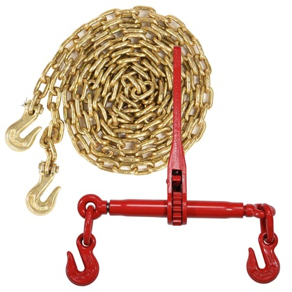

When it comes to purchasing chains and binders for hauling my JD 2150 tractor (approximately 7000lbs with FEL and Ballast), are the 5/16 - G70 chains and binders from https://www.uscargocontrol.com/collections/transport-chain-and-binder-packages sufficient, or have any of you had bad luck with imported chains? With a 4,700 WLL, I imagine four chains is more than sufficient to bind it properly, even if the chain is inferior to US made chain?

I am aware of the under/over 10k load rule, and the requirements it entails, my main concern is whether or not the import chain and/or binders (boomers) are a problem. It's enough money even for the cheaper stuff that I don't want to do it twice. Is it sensible to buy cheaper chain, but better binders? Do the Chinese ones function well?
On a separate note, what is the most practical length of chain for two or four way binding. Could I buy two 20' or 25' chains, and four extra hooks, and end up with four 10-12' chains for the corners? Or are those too short to be practical? Or should I get two long chains for the front and the back, and only two binders? I have plenty of 10k rated straps for the FEL and attachments.

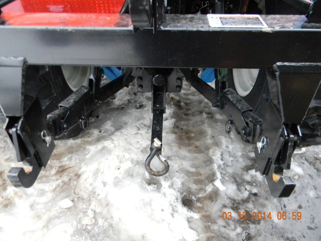

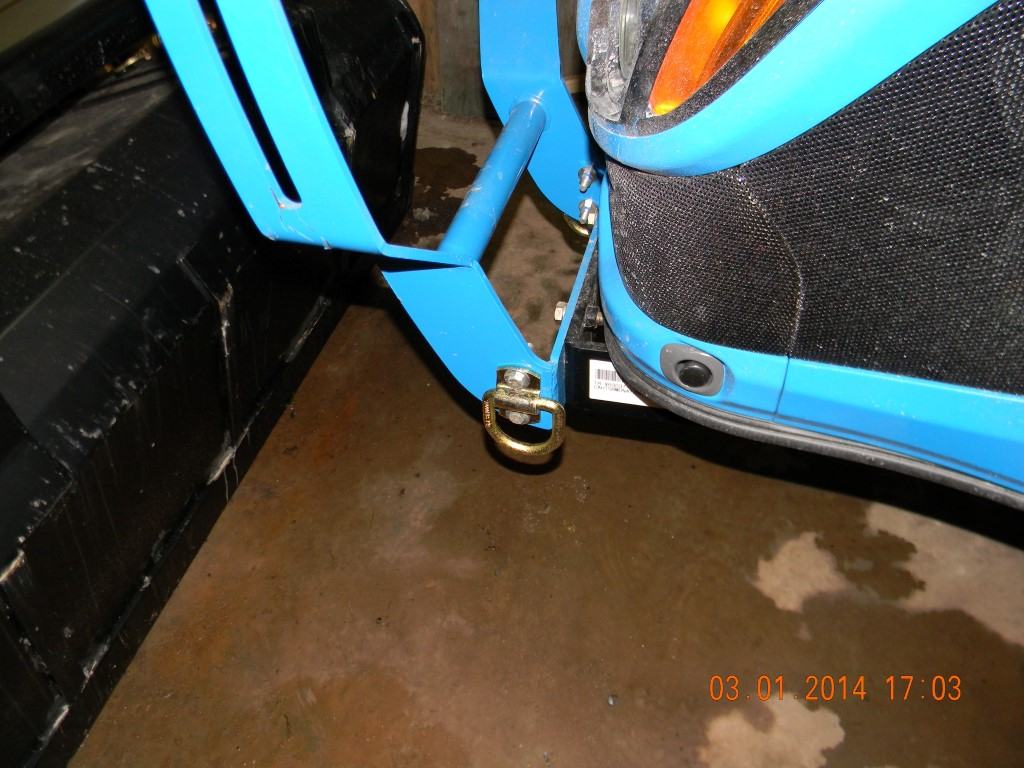

Yes, 10'ers are plenty long. My trailer is 22' tilt bed (actually 23 1/2' with tail). It has a rub rail along each side plus stake pockets so I have several places to loop the chain through. I also have drop in D-rings I can put in the pockets. I also bolted D-rings on the front tractor frame sides and a twisted clevis on the rear draw bar.
