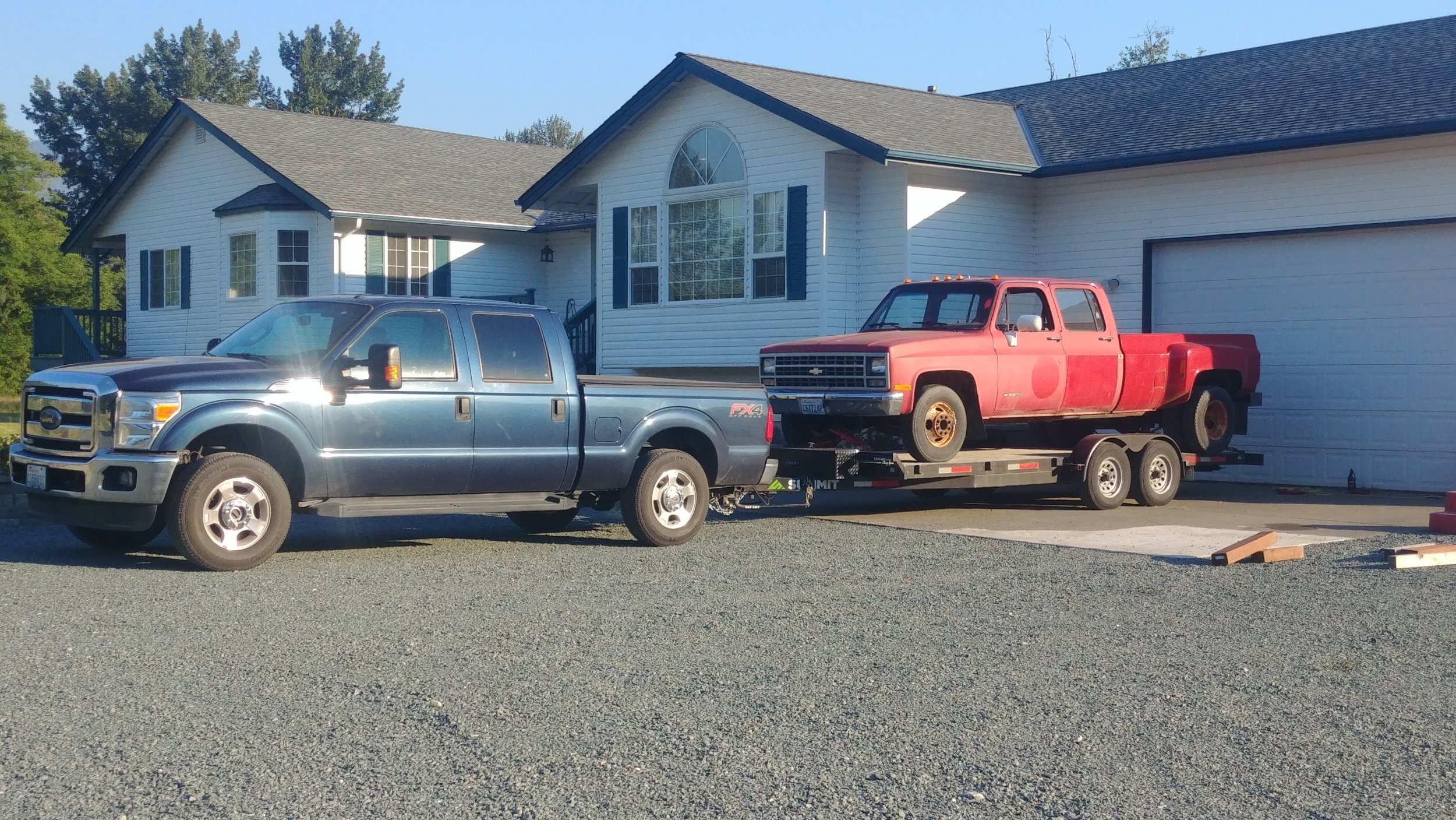

I hauled a one ton dually over here from Puget Sound and I had to cross chain it which worked out well for me. I had no one to guide me when I loaded it, so I used the cross ratchet binders to pull the truck sideways to center it.
I don’t like grease on them. It’s nasty. I hit them with spray lube but that doesn’t last very long. One of my trailers has a toolbox. That pretty much eliminates the problem. My other trailer doesn’t have a box.

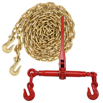

I ended up ordering two 20' "Made in USA" 5/16 G70 chains from US Truck Supply, which I plan to split into four corner chains, several extra hooks, two ratcheting binders, and two of the new style cam binders which have the soft release. The binders are imports, but for the amount they'll actually be used, I think it's worth going cheaper on them - at least until I figure out if they work well or not. Free shipping on everything, and considerably less than Tractor Supply or Orschelns.
