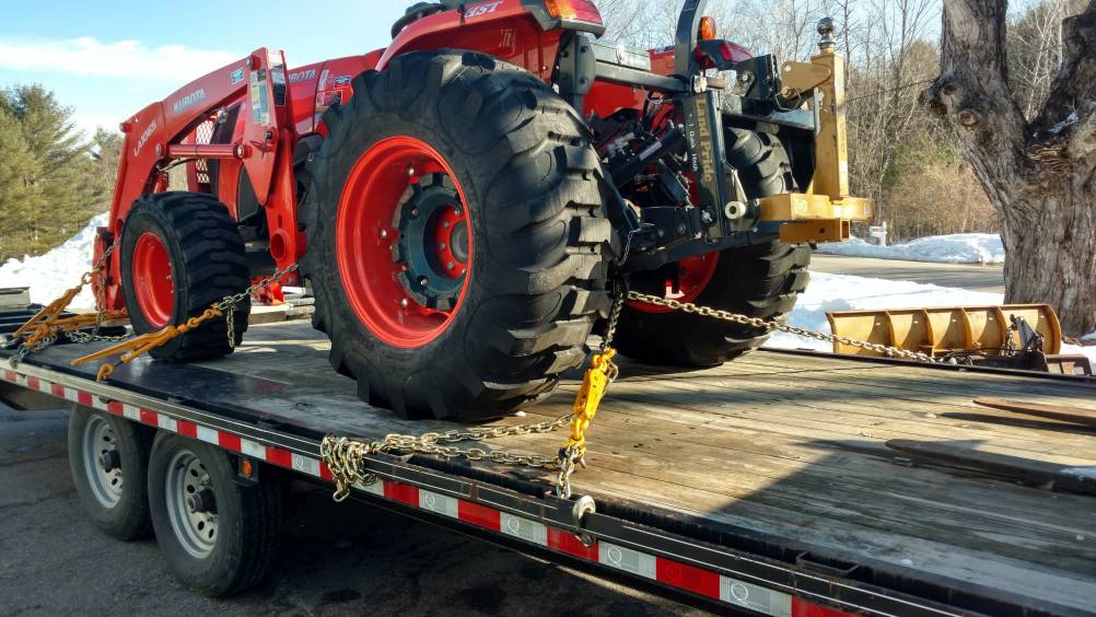

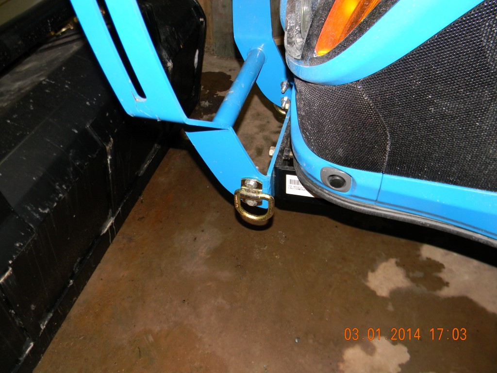

Mine's not 50HP but tie down would be the same. I have D rings in front and twisted clevis in back. 4 Chains drop through them easily, 2 front ,2 back with ratchet binders. Chains over bucket and rear implement.
Do you just run one chain through the back clevis and hook to each side or do you have a separate chain for each side? I often have an implement on and have no drawbar for the clevis so then what?
On the front, is that OK to bolt to the brush guard? It seems that enough tension would bend the guard? I don't know, I'm just tossing that out. A chain puts a lot of tension on things.

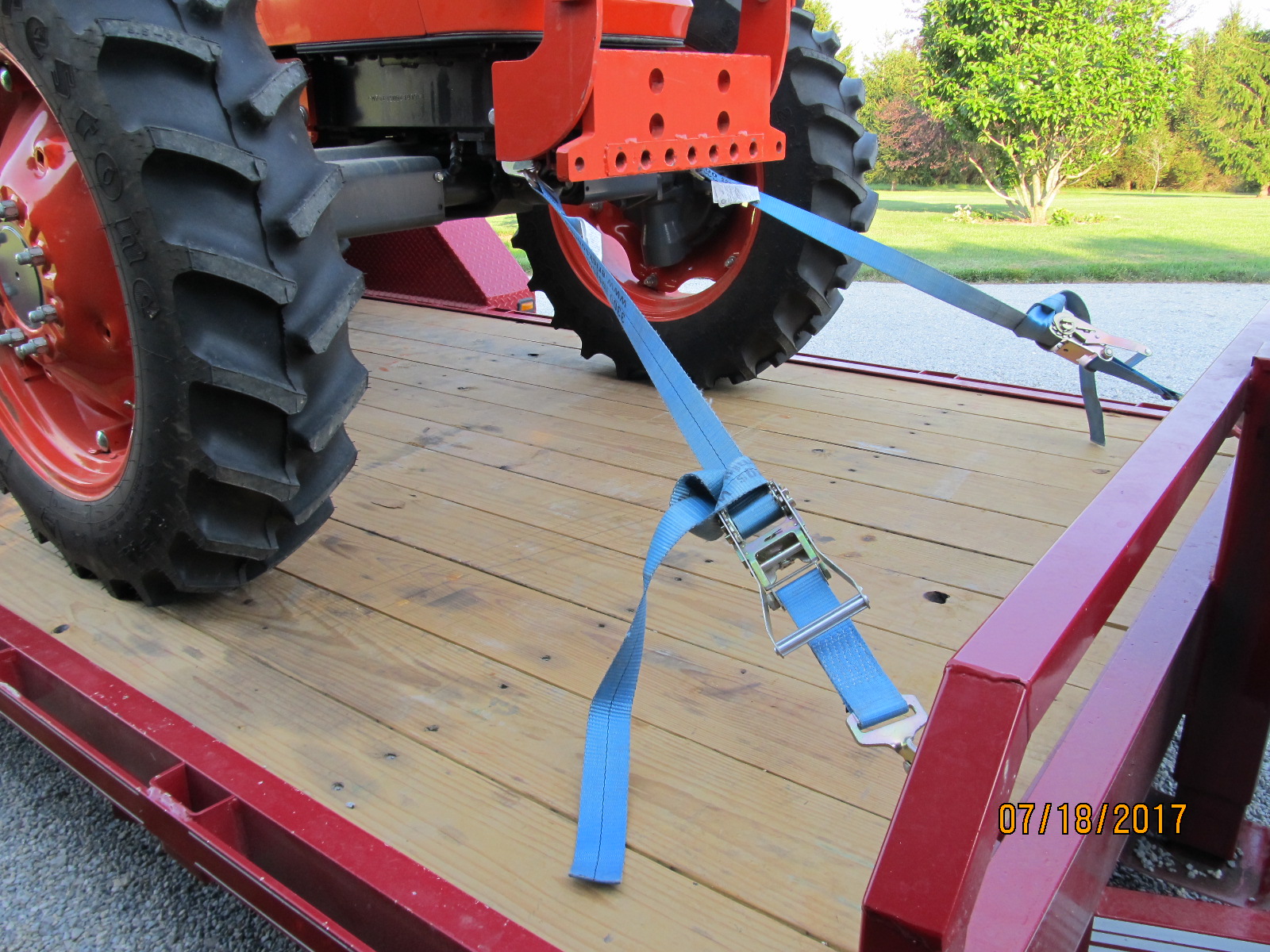

Here are some samples with straps and just going to a back road. I do use the blue straps up front and in back I also use the blue straps with the lock hook.

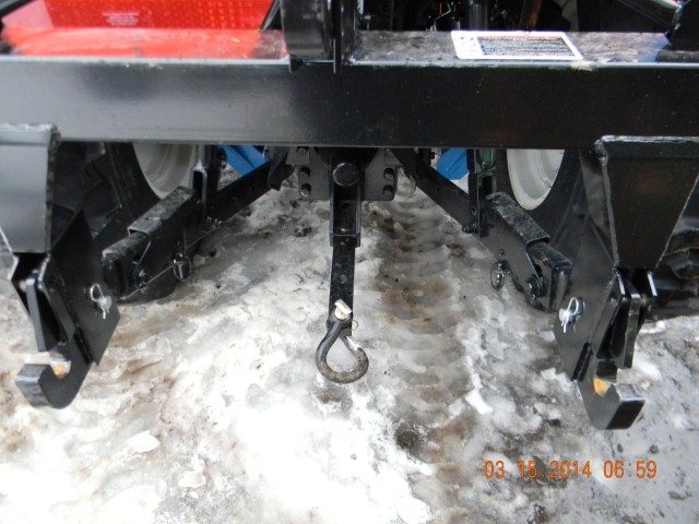

Six,
You can use the pin hole(s) for the draw bar to attach one or even two clevis for a rear attachment point. I typically use one chain but two would be easy.
   / How do you chain down your 50 HP tractor for transport?
Six,
Any closer pics of that clevis? Is one chain just as good as two? Sometimes I get up around 8,000 lbs.
   / How do you chain down your 50 HP tractor for transport? #7
Nothing better right now. It's just a big 'ol clevis that the pin fit through the housing where the drawbar pin would go.

I do 6 chains. 3 on the tractor frame. 1 on the loader frame. 1 chain on the 3pt implement or QH. 1 chain on the loader attachment.
My personal theory is that, assuming you have enough chains, it is better if the go from one side of the trailer to the other. Here's why: If a chain only goes to midline and becomes unfastened there seems to be a huge potential for an unbalanced load as the other side maintains tension. :2cents:

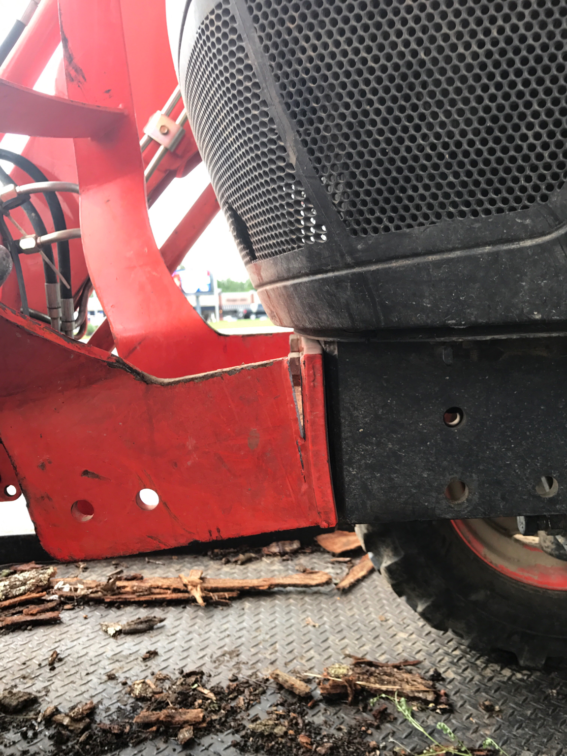

Here is the front without a bucket.
I could definitely be talked into two lateral rear chains to that clevis if you have a better argument.
I don't like his setup because the bolts and D-rings look wimpy. I usually just throw a chain across the brush guard and feel pretty good about that. I did manage to pull the brush guard 1/2 off with my rollback winch. IMG_0133.JPG

4570Man--So would I be OK to put a clevis into my front weight bracket and chain to that? One chain through and hooked to each side? It would take enormous pressure to damage that because it's bolted to the tractor and can hold 1100 lbs.
