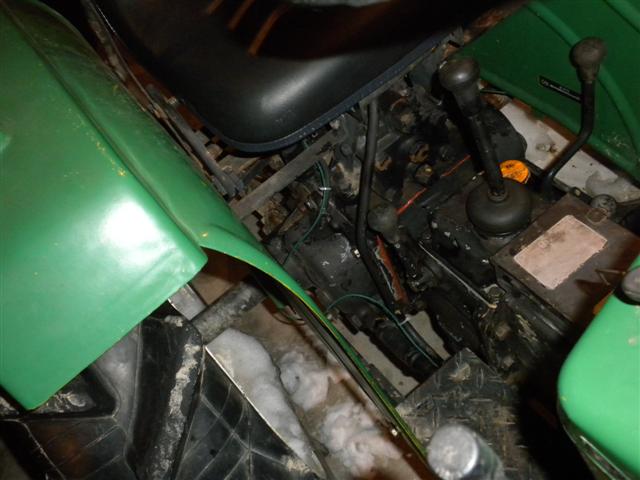

Here are some pictures of my engine. No holes on top of the valve cover. Only holes on the side. Had to straighten the bracket for it to work
I also took some pics of where the diff lock would be. No lever, or anything.

/ Transmission sheared gears #69
I'm a believer:confused:, must be a really early model. Valve cover is certainly different, and if there were a diff lock, the shaft should exit the case right above the brake. Is there a plugged hole there?

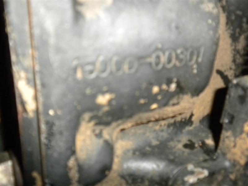

/ Transmission sheared gears #70
I reiterate that I would really like to see the serial number stamped on the left side of the transmission case. By the left ankle when you are sitting on the tractor. In a clear spot should be a number which "should" start with "YM"
Mike

OK Here is a picture of the serial number on the tranny.
It says 1500D - 00301
/ Transmission sheared gears #74
Is that cast in, or stamped?
I thought they all started with YM, YM1500D etc.
If that #301 is the production sequence then it seems to be one of the earliest ones. Does anyone know when production began on these?
/ Transmission sheared gears #76
Does anyone know when production began on these?[/QUOTE said:
i believe they ran from 1975 to 1979. that is what some of the papers state that i had gotten with mine.
