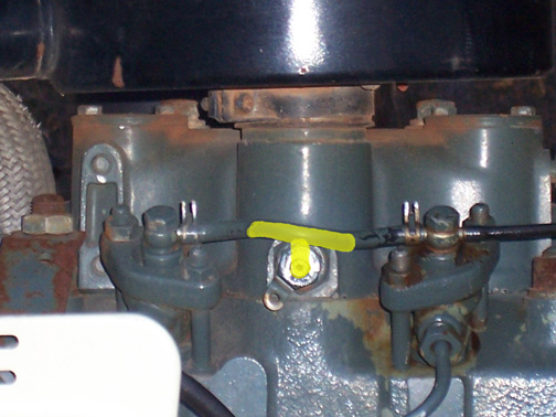

That is what I was thinking. Putting a tee just above the plug so that the fuel that is in the return line (the one going back to the tank) could feed the plug
Any one else consider this?

I will try again
/ Transmission sheared gears #56
In principle that should do it.
But I think the space is too tight there, so I would put the T over by the right edge of your photo.
I haven't tried this so I don't know if it will really work. Before cutting anything, I would buy enough hose to restore the original plumbing - just in case this won't work for some reason.
If you do it, take some photos!
