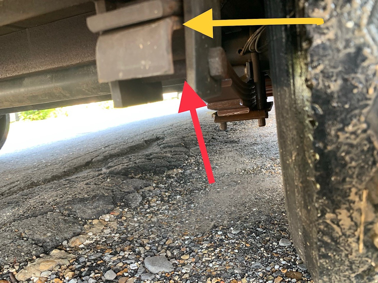

This is on a delta goosekneck flat bed. It has single wheels with two axles. I had a blow out last summer with about 10,000lbs on the trailer. Replaced the tire and after that the trailer wants to shake, enough to rattle the dash in the truck. Its fine until it gets up to around 60MPH. I did replace the other tire on the same axle which didn't help and I haven't touched the tires on the back axle. It doesn't seem nearly as bad when the trailer is loaded.
Would this be a problem with the first new tire I bought??
Do I need to replace the two tires on the back axle? They are the original tires on the trailer when it was new in 2009.
I guess my next step is to take that one tire back off and take it up to the shop and see if its really out of balance. I just didn't think a tire out of balance would cause that much shaking.
I had a similar issue on a 20' heavy duty bumper pull trailer. The dealer and I fought it for 2.5 years. We changed, rotated, and balanced tires several times and none of that solved the problem.
I was ready to trade the trailer, when my dealer called the factory to see if they could help. It turns out the bolt that the spring is supposed to rest on had been tightened too much and the spring could not rest on the bolt. After we opened up the shackle and allowed the spring to rest on the bolt, the bouncing went away.
In this picture taken before we opened up the shackle, you can see at the red arrow that the shackle is squeezed just a little and did not allow the spring to rest on the bolt.
I'm trying to reason out what you are saying but I'm not having much luck at it. The bolts only purpose is to keep the spring from coming out of the shackle, not to hold up the spring. Maybe the bolt was tight enough to squeeze the shackle into the sides of the spring?
I'm sure I am missing something.
I don't fully understand it either. The 'shackle' that the bolt runs through at the red arrow in the picture, had been tightened too much and it had squeezed the 'shackle' which did not allow the spring to function properly.
When we opened up the 'shackle' the bounce went away.

So the spring would come up (like under weight compression) and would not freely release back down because shackle squeezes too much. Restricted movement.
The best reasoning I can come up with is when running over a bump the spring would move down within the shackle then wedge in the lower position. That would cause the axle to be low on one side so it wouldn't track right. Future bumps or a load would free up the spring.
