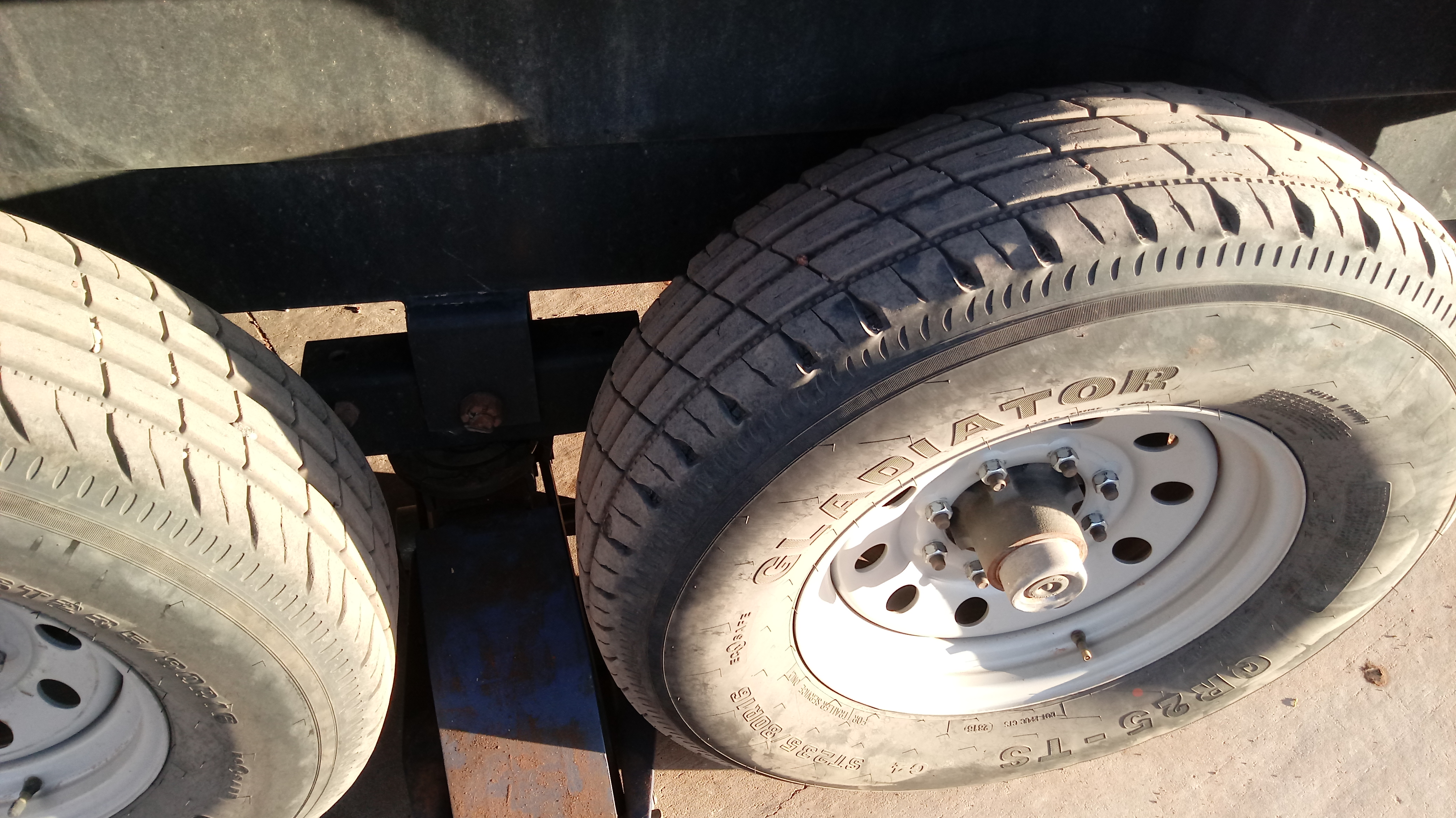

This is on a delta goosekneck flat bed. It has single wheels with two axles. I had a blow out last summer with about 10,000lbs on the trailer. Replaced the tire and after that the trailer wants to shake, enough to rattle the dash in the truck. Its fine until it gets up to around 60MPH. I did replace the other tire on the same axle which didn't help and I haven't touched the tires on the back axle. It doesn't seem nearly as bad when the trailer is loaded.
Would this be a problem with the first new tire I bought??
Do I need to replace the two tires on the back axle? They are the original tires on the trailer when it was new in 2009.
I guess my next step is to take that one tire back off and take it up to the shop and see if its really out of balance. I just didn't think a tire out of balance would cause that much shaking.

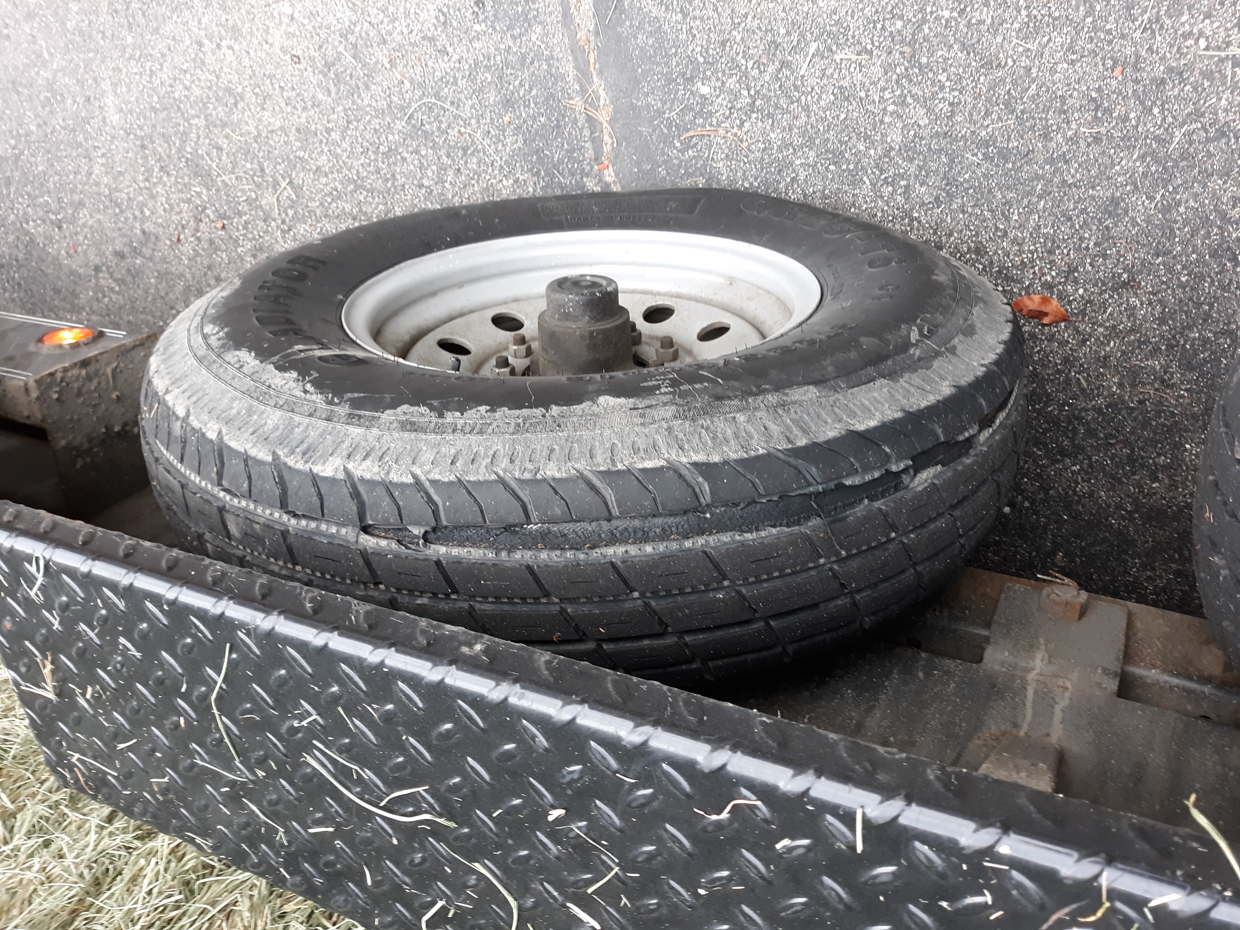

I would replace the tires on the rear axle, they are 11-12 years old. Probably out of round/cupping or they may have some broken belts. The rear axle will wear faster than the front so I always rotate my trailer tires. Mine get a lot of miles tho.
