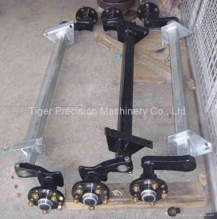

Not sure what a boogie axle is, but you might want to consider a torsion axle. I put a 5000# (gross) capacity under a 5x8 box trailer on D-range tires (left picture). But since shipping is one of your concerns, you can get it in stub version too (right picture). Either way, you've got a decent carrying capacity on one axle instead of two. The advantage being that you can partially dump a single axle trailer by just unhooking it from the hitch, a feat that I cannot perform with my tandem trailer.
//greg//
