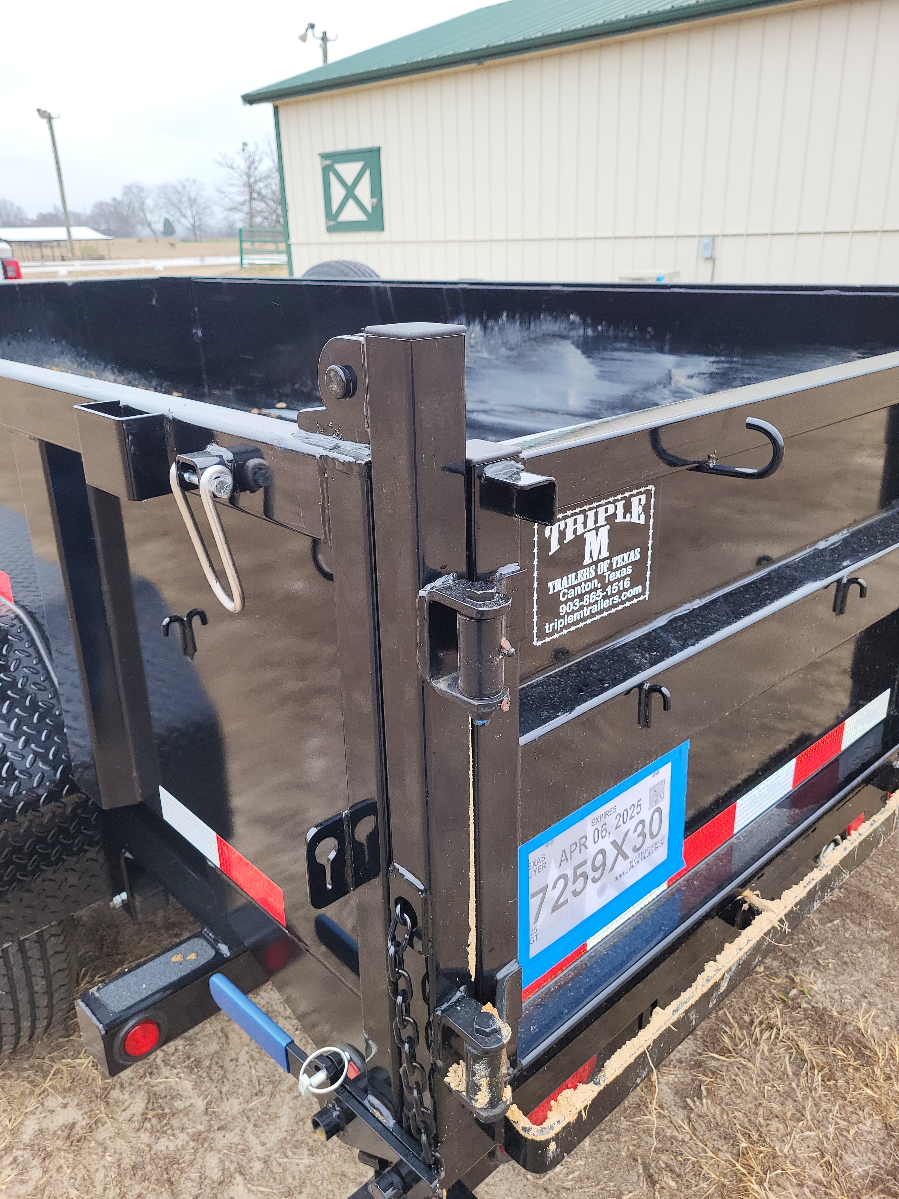

Anyone have any experience with Texas Pride trailers? They have a dealer reasonably close to me.
Does the rear spreader gate work well? I saw a couple of videos of the rear doors failing when trying to use the spreader gate, not sure the trailer brand on the videos.
Mine work fine. I have only used them once. I just retopped part of my driveway with recycled asphalt. For that I dump the pile, spread it with the tractor, and level it with my landplane.
My dump trailer came with ramps and rear jacks. I haven't used them. But they are there if I need them. I have utility trailers to haul tractors and such.
Here is the spreader chains and latch release to use the spreader gate.

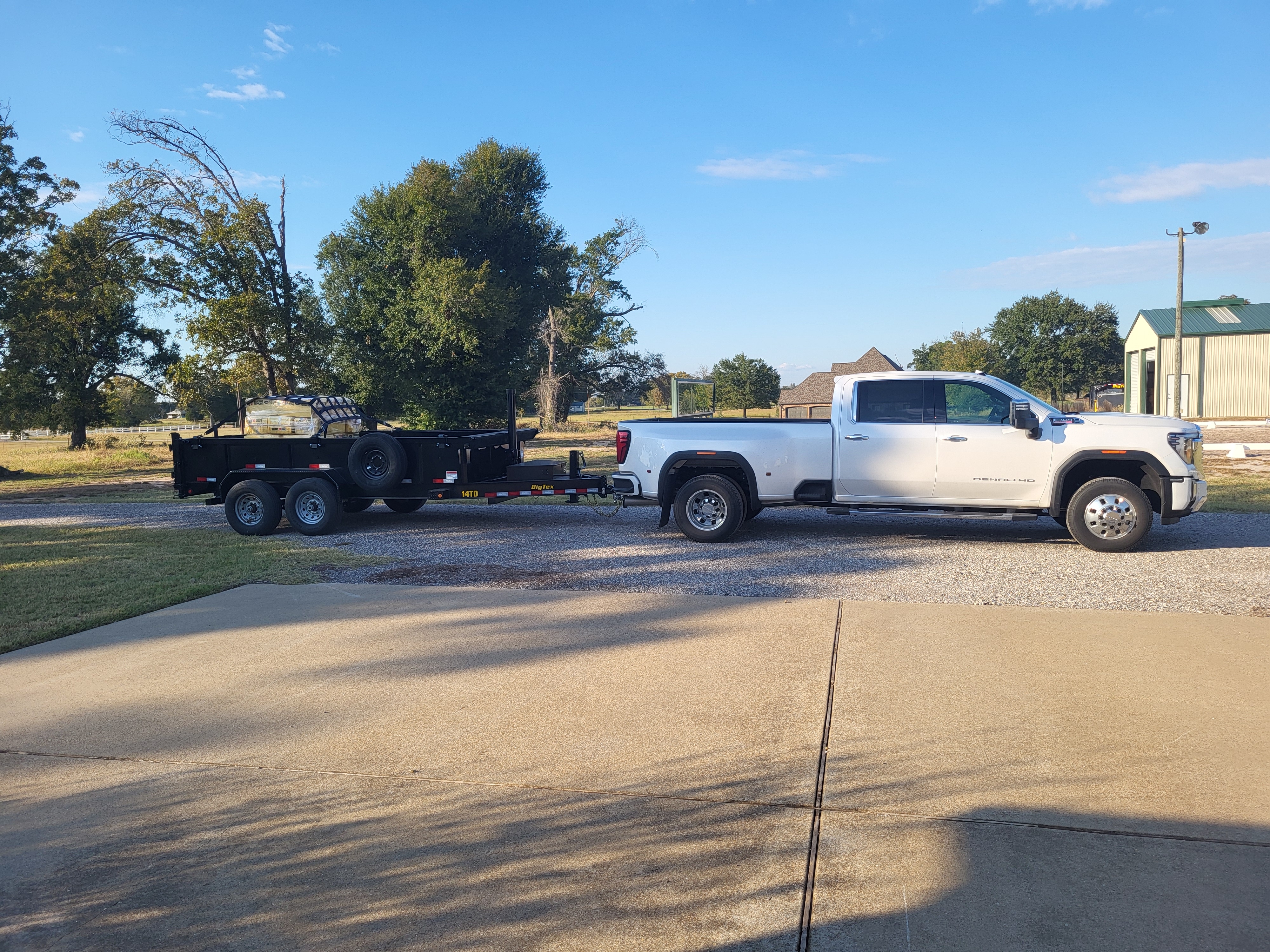

The majority of what I haul is 6 yards of pine mulch for the arena, 600 lbs/yard or 3,600 lbs total weight. A little more if it is wet. I was hauling 6 yds of topsoil occasionally at 2,000 lbs - 2,200 lbs per yard to fill in around the stables. That definitely is more than my rated capacity of 10,030 lbs. I will probably cut down to 5 yards on future loads. I also haul recycled asphalt for the driveway, 4 yards at 2,600 -2,800 lbs/yard. That also puts me at the upper limit.
I have some wiggle room. On paper my 14TD with 7,000 lb axles has a GVWR of 14,000 lbs. Specs shows the trailer weighs 3970 lbs and has a payload capacity of 10,030 lbs. But there is no additional weight capacity for the 10% tongue weight. The newer model 14TD with 7,000 lb axles shows an empty weight of 4,570 lbs, cargo capacity of 10,830 lbs, and a GVWR of 15,400 lbs. That would include the 10% tongue weight of 1,400 lbs. So I am OK with going a little over the 10,030 lb capacity.
/ Dump Trailers #46
Unless you have a CDL I’d stick with a 14k.
I agree with stating under CDL requirements. My 2024 GMC 3500HD DRW has a GVWR of 10,500 lbs. The only trailer I have that would put me in CDL territory is my Big Tex 14GN at 15,900 lbs. Texas allows you to tow a trailer with farm tags up to 20,000 lbs GVWR on a Class C license, so I covered there. My dump trailer is at 14,000 lbs GVWR so under CDL territory. Even the new model 14TD is at 15,400 lbs GVWR so I would still be under CDL requirements.

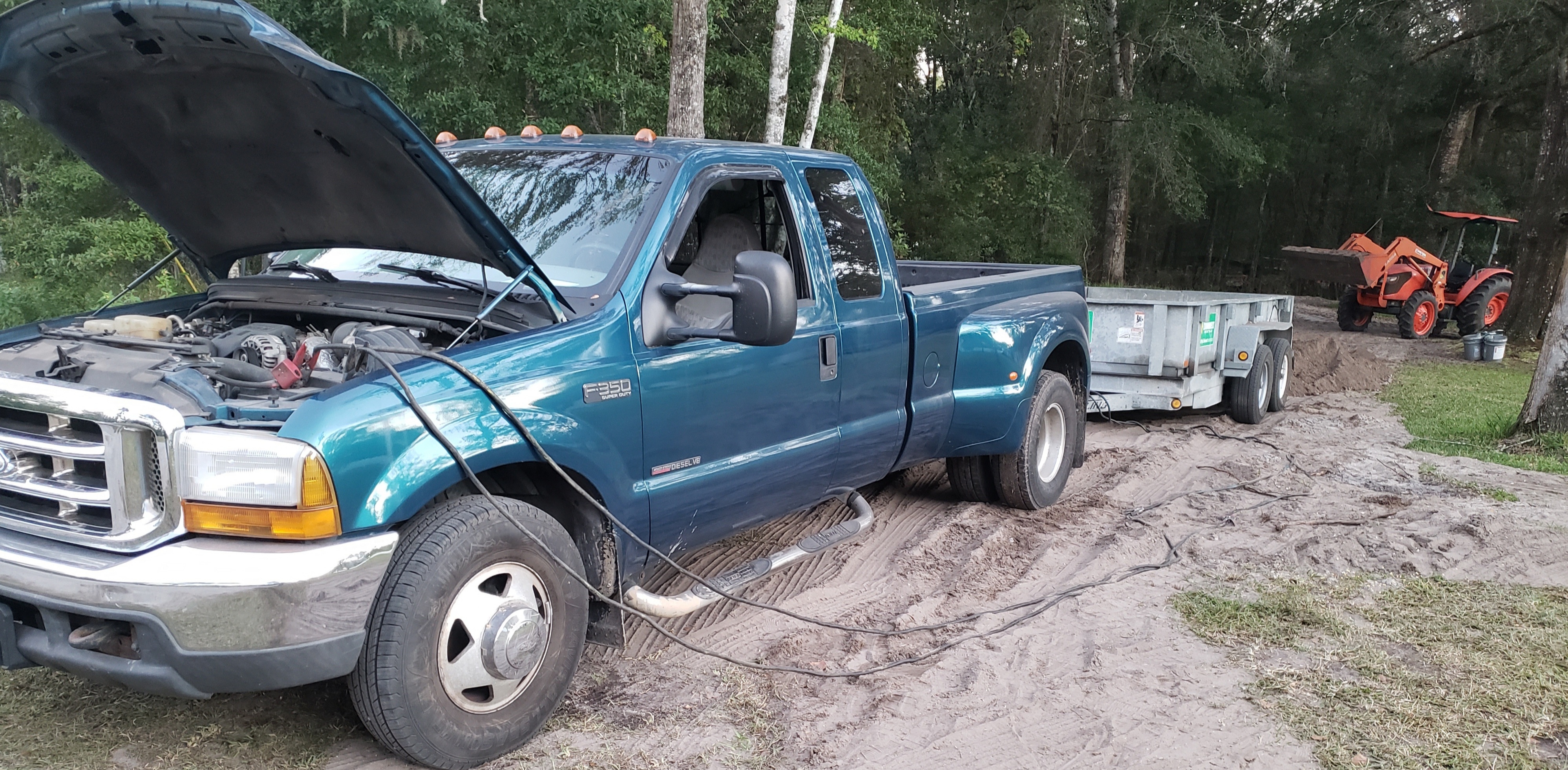

I rented a dump trailer and thought it was nice having it, and with this thread, I decided to take a look at the trailer manufacturer that I rented. Sticker Shock! I had no idea that new dump trailers had gone up in price that much!
I think if I need one regularly that I will convert "*ugly dump trailer" to something that hauls dirt, meaning to add sides to it.
David from jax
* ugly dump trailer was a twisted tongue 45' commercial boat trailer a friend and I converted to a 20' flatbed that the rear 13' dumps.

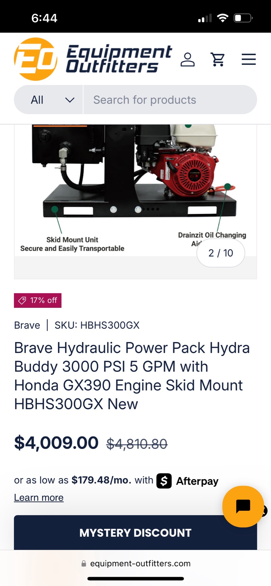

Can you order it with a gas engine and pump to help with the speed issue plus you could run unlimited cycles daily?
/ Dump Trailers #58
Uh huh.
$8,000 option.
No thanks. I’ll wait.
/ Dump Trailers #59
Uh huh.
$8,000 option.
I wouldn’t have expected that. A 11hp Honda GX with electric start is about a grand and you could downgrade to knockoff motors for $300-400. You could easily put together the hydraulic part for under a grand. I wouldn’t expect the whole setup to cost a lot more than an electric pump with dual batteries. This is no bargain. You could buy all the parts and assemble it yourself cheaper and it’s still half that cost. Even if you downsized to a 5hp motor to save money I’m sure a 5 hp would still outperform a battery pump by a good margin.
