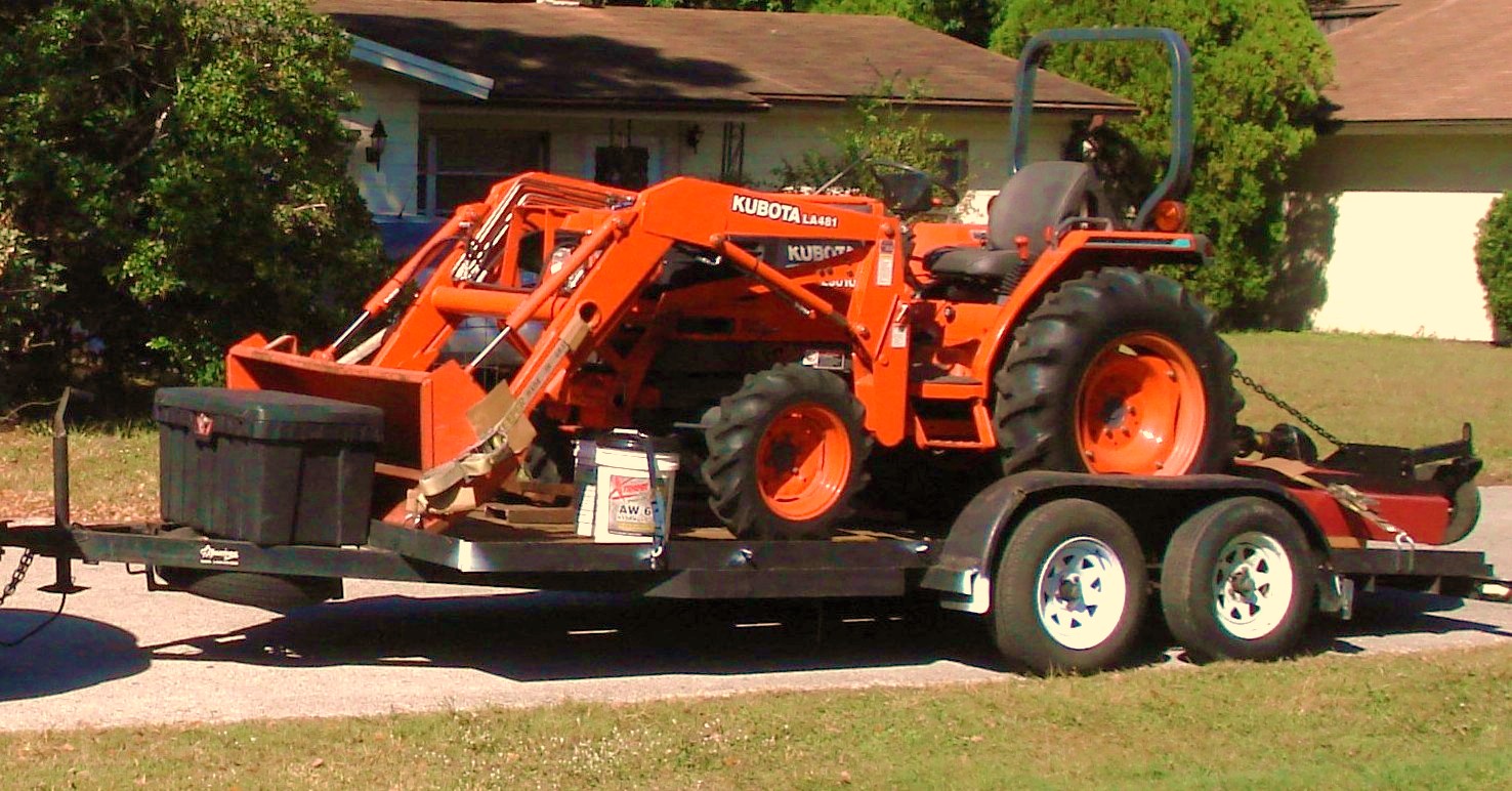

I keep learning from you guys...thanks. I know (because I replaced 2) that the tires are St 205/70/15's The rating was 1800# something...? After this picture was taken I bought a "dropped" tow hitch which lowered the front and raised the rear about 3". Again, I'll check when I get up there.and THANKS

Very nice pic :)thumbsup:), but it appears that your tractor may weigh more than 3,800 lbs.. Also, it looks like the axle centerlines are only slightly below the frame rails, suggesting the trailer has torsion block suspension, in which case it wouldn't be practical to do any trailer surgery to lift it. Sorry.
Judging from the light scantlings, that trailer is rated no more than 7,000 lbs.

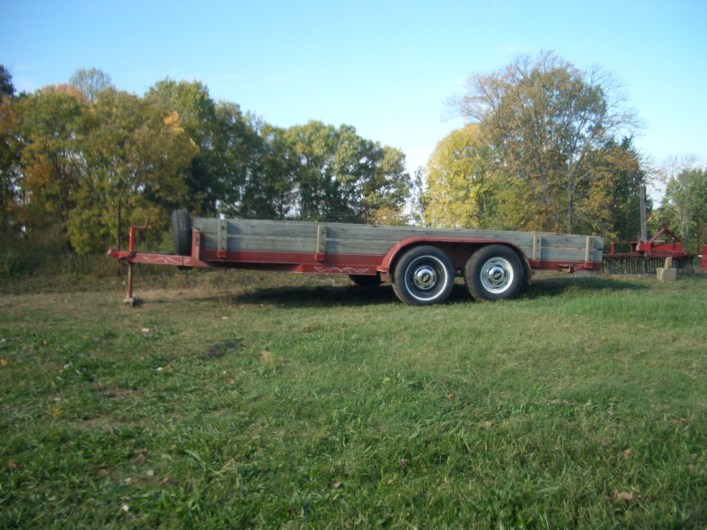

Probably less. Here's my 16 footer, rated at 7500# gross. Note the larger tongue and frame members. Leaf springs are barely visible between the tires. On the Boeing trailer, I see a similar shadow between the tires, suggesting a leaf spring suspension as well
