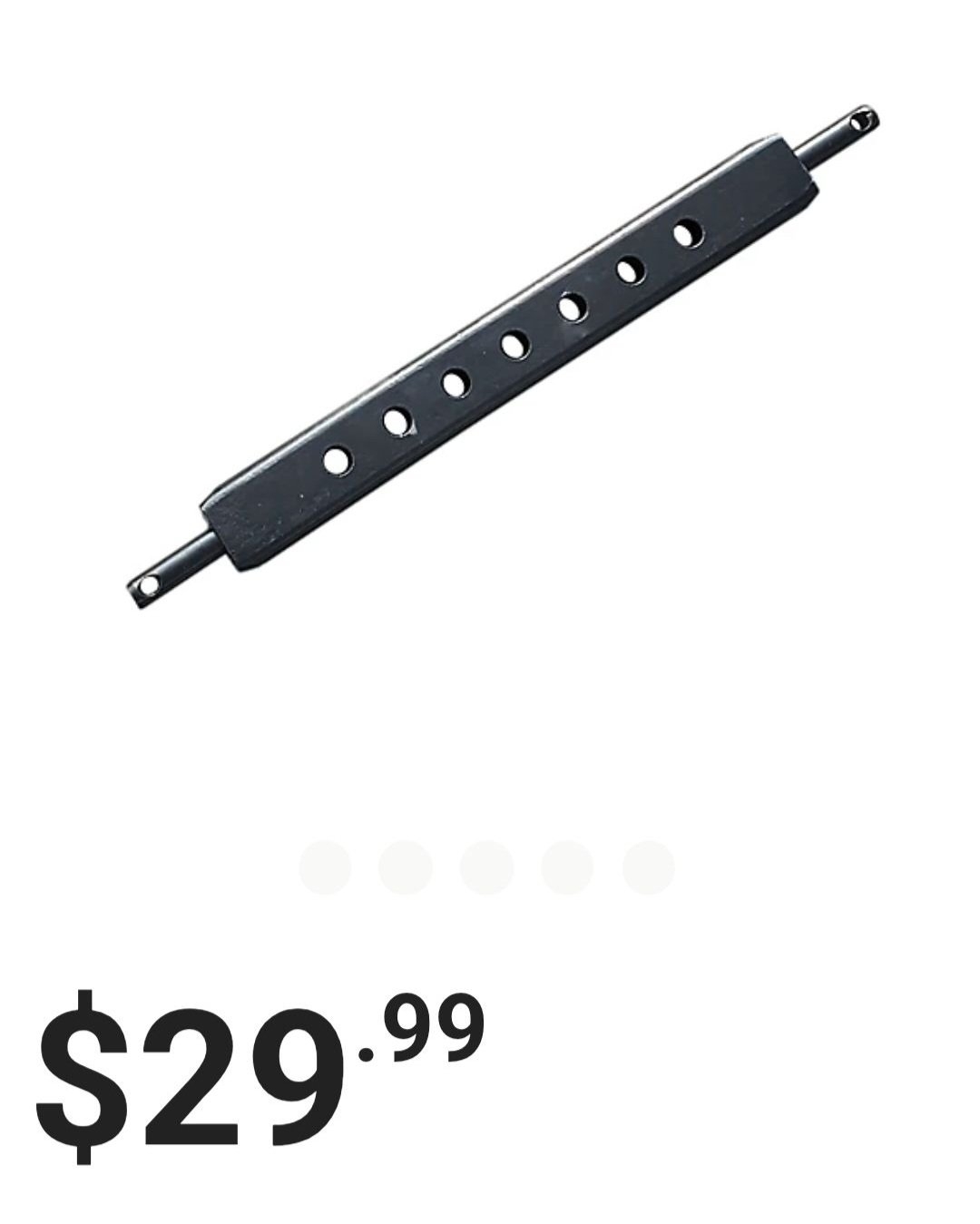

The tractors fixed draw bar is often the best and simplest way.

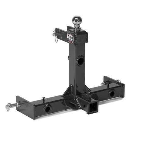

I have a 5x8 trailer and this got me thinking, I'll probably just get this & put a ball on it.
I don't understand those things. Used with a typical coupler they must be very hard on the coupler.
Or is there an easy way too keep that bar from rotating?

Okay, I think I know what those bars are for. My dinky dump trailer came with a "fork" meant for a vertical pin.
If so, that the bar can rotate is a big plus since it allows the connection to pivot in two planes instead of just one.
