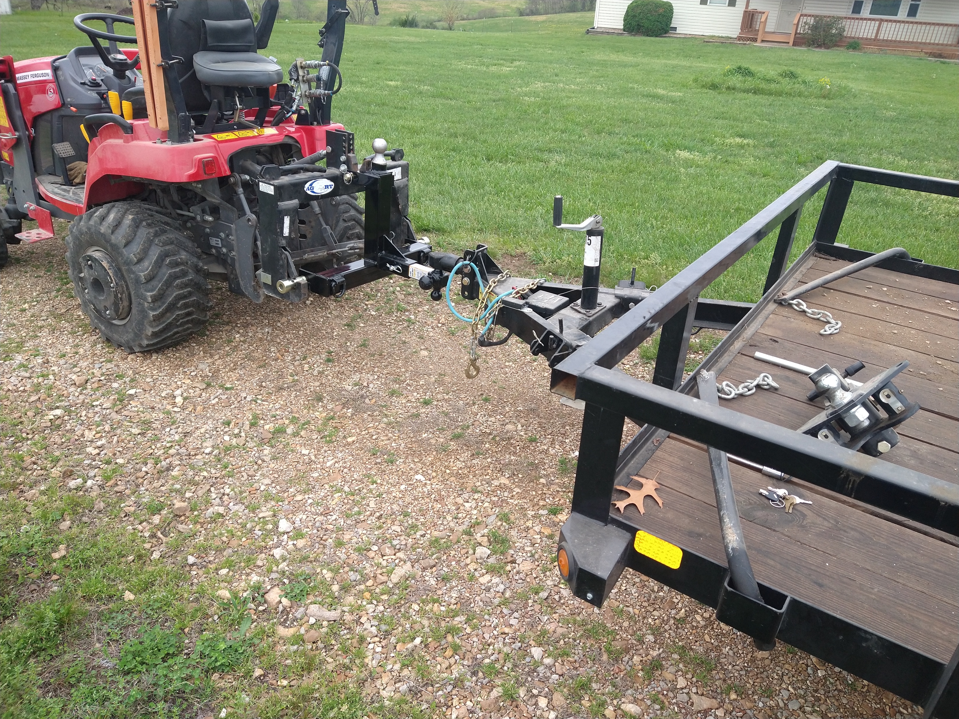

I have a fairly heavy-duty 5'x8' utility trailer that I am sure I am going to want to pull behind my tractor from time to time. Have used it a lot for hauling cut/split firewood behind the truck.
What's your preferred method? Favorite 3pt hitch receiver? Something I am probably not even thinking about? :ROFLMAO:

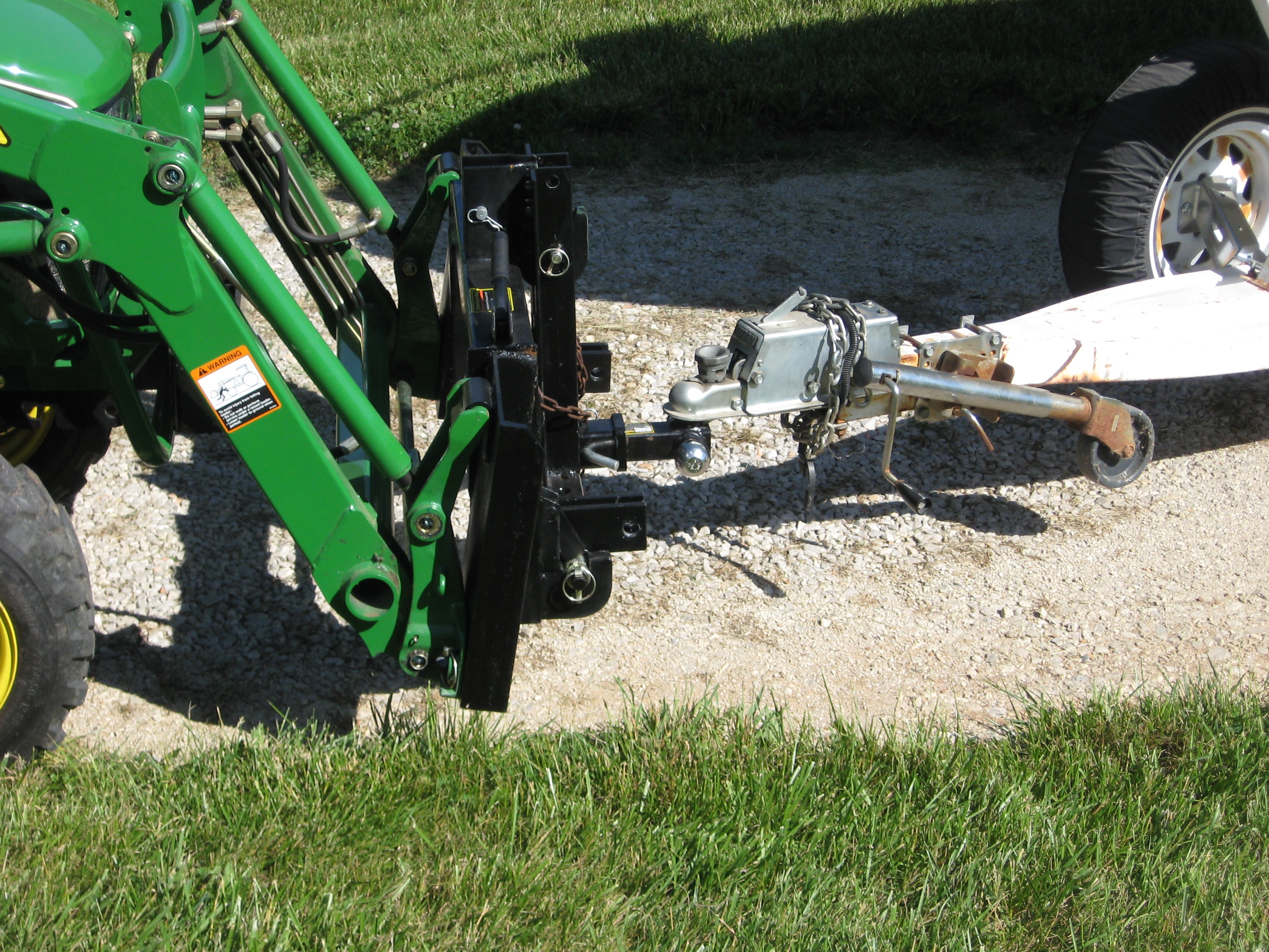

If I'm pulling (or pushing) a trailer with my tractor it will either be with my three-point hitch on the front or the back, or with the trailer hitched on the receiver on my carryall.

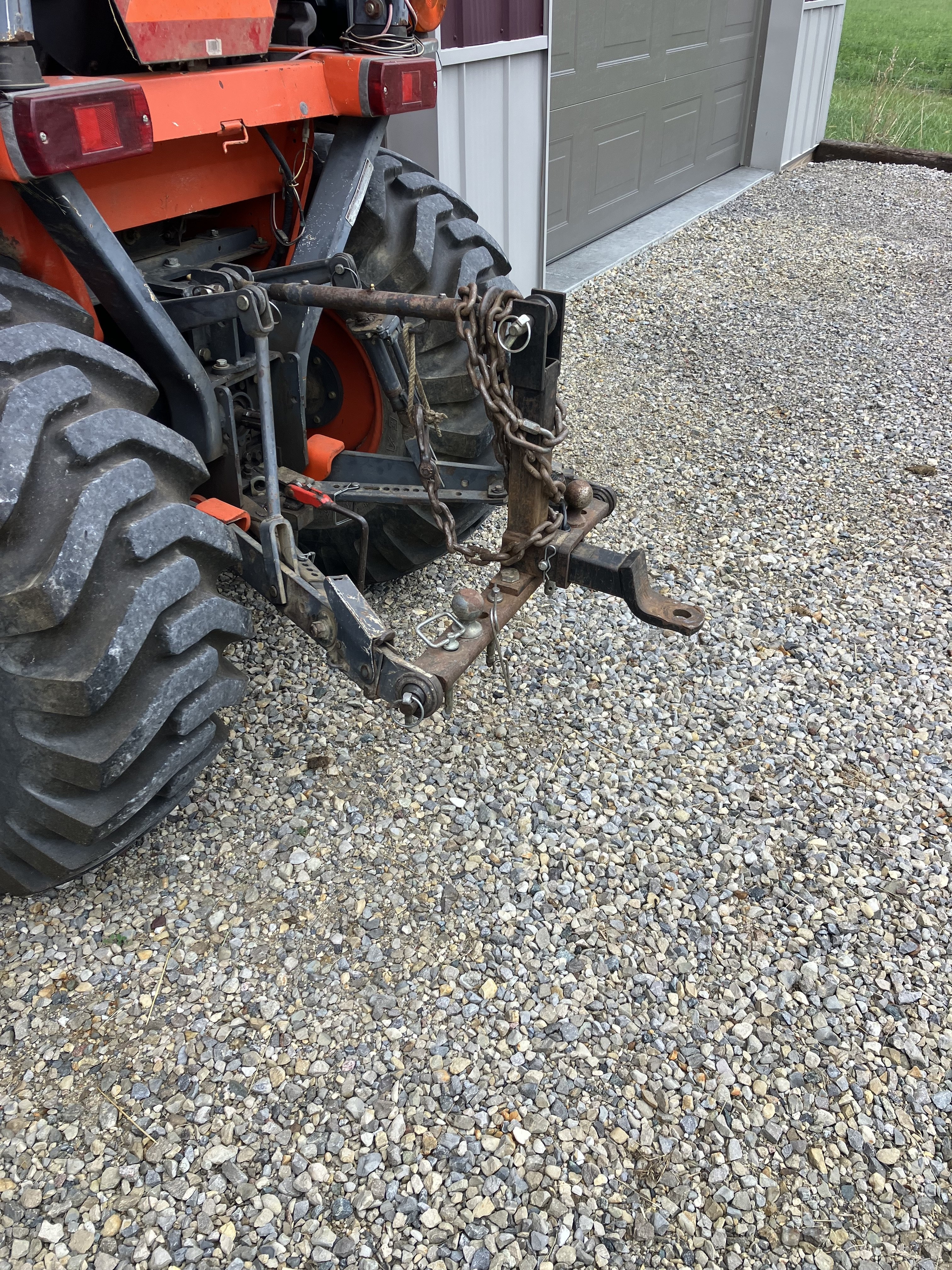

I don't understand those things. Used with a typical coupler they must be very hard on the coupler.
Or is there an easy way too keep that bar from rotating?
If I was worried about it rotating I'd use a flat bar steel. 3"×5"×1/2" thick. Two holes, one for ball & other bolted on. It couldn't rotate...it would just allow end arm pins to rotate a bit when lifting.
