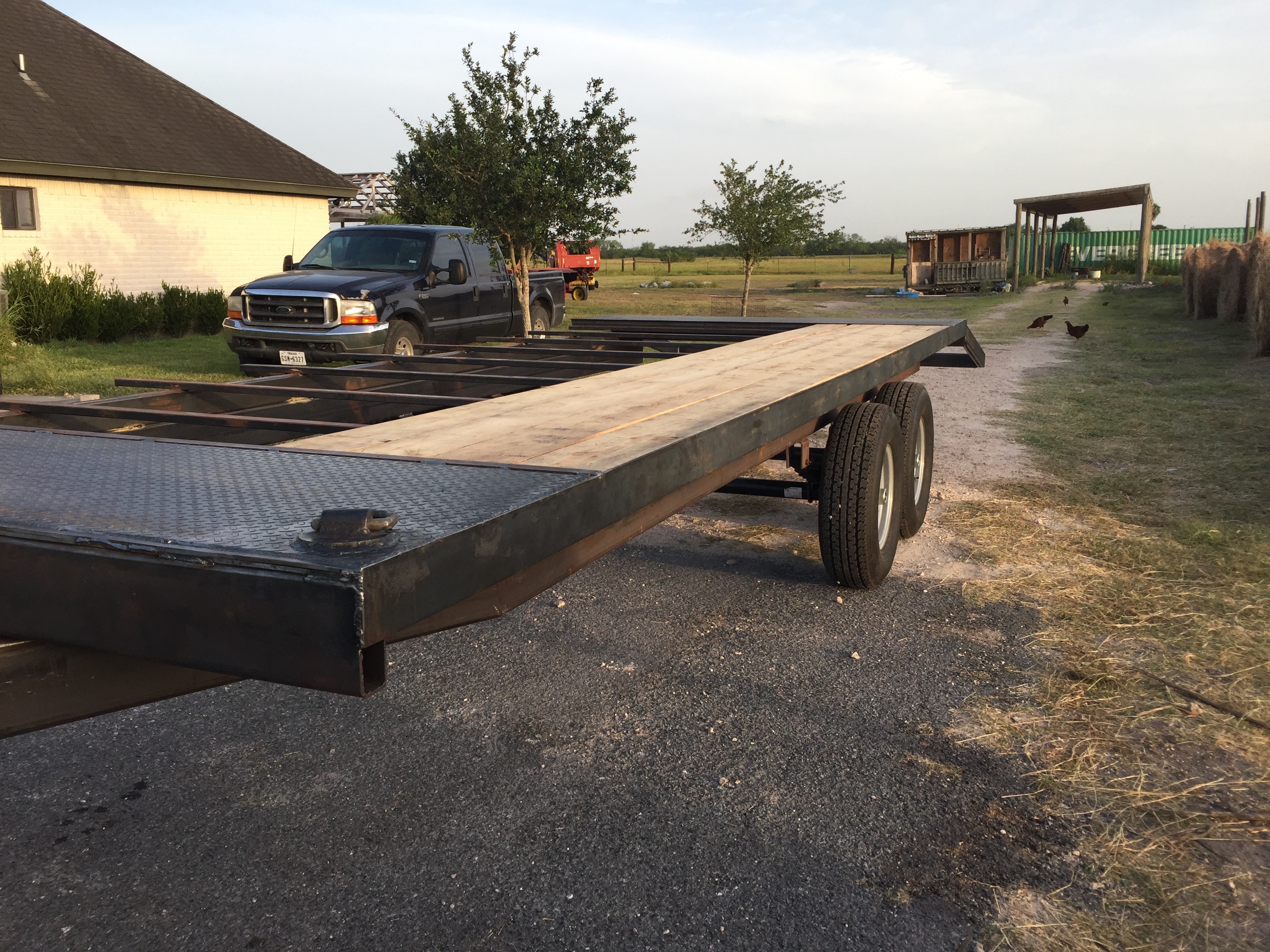

The main frame looks stout but those crossmembers are too weak. They will bend especially laying flat like that. Gussets won't help it isn't the weld that is the problem they are laying flat on the frame with very little stress on the weld. The problem is the material is too small to span that distance.
   / Trailer got stolen, so decided to build one #22
The fix sounds easy enough after looking at my PJ trailer. If it was me I would get some 3" channel iron and weld them directly beneath the tubing in question.
The overhang on each side should have a channel or square tubing supporting that on a 45 deg. angle to the lower frame member. This would also help with strength for when you chain something down. I didn't reread all these posts and maybe you have something all figured out already. In either case, it looks like a very nice project. I wish I had a trailer that size.

I did criticize this build but feel this is necessary sometimes. If you are going to build a trailer it needs to meet some design criteria if used on public roads. I am all for DIY projects but feel that this cross member issue does need to be resolved properly. A suggestion would be to COPY others such as Big Tex and PJ to name two manufacturers who have already figured this out.
   / Trailer got stolen, so decided to build one #24
Thats a very good idea as well. The flat laying tube will form the upper flange, and the angle iron the vertical and the lower flange of what together acts as a C channel

Out of curiosity, why did you build your trailer with two different sizes of tubing for the cross members? That's just going to pose a problem when I comes to laying the decking on.
The deck will be made of steel and lumber. I used different sizes to compensate for the thickness of the lumber (1.5"). It looks fairly level when transitioning from one to the other. I'm still going to add plenty of weld to the front section where I elevated the plate with 1/4" strips.

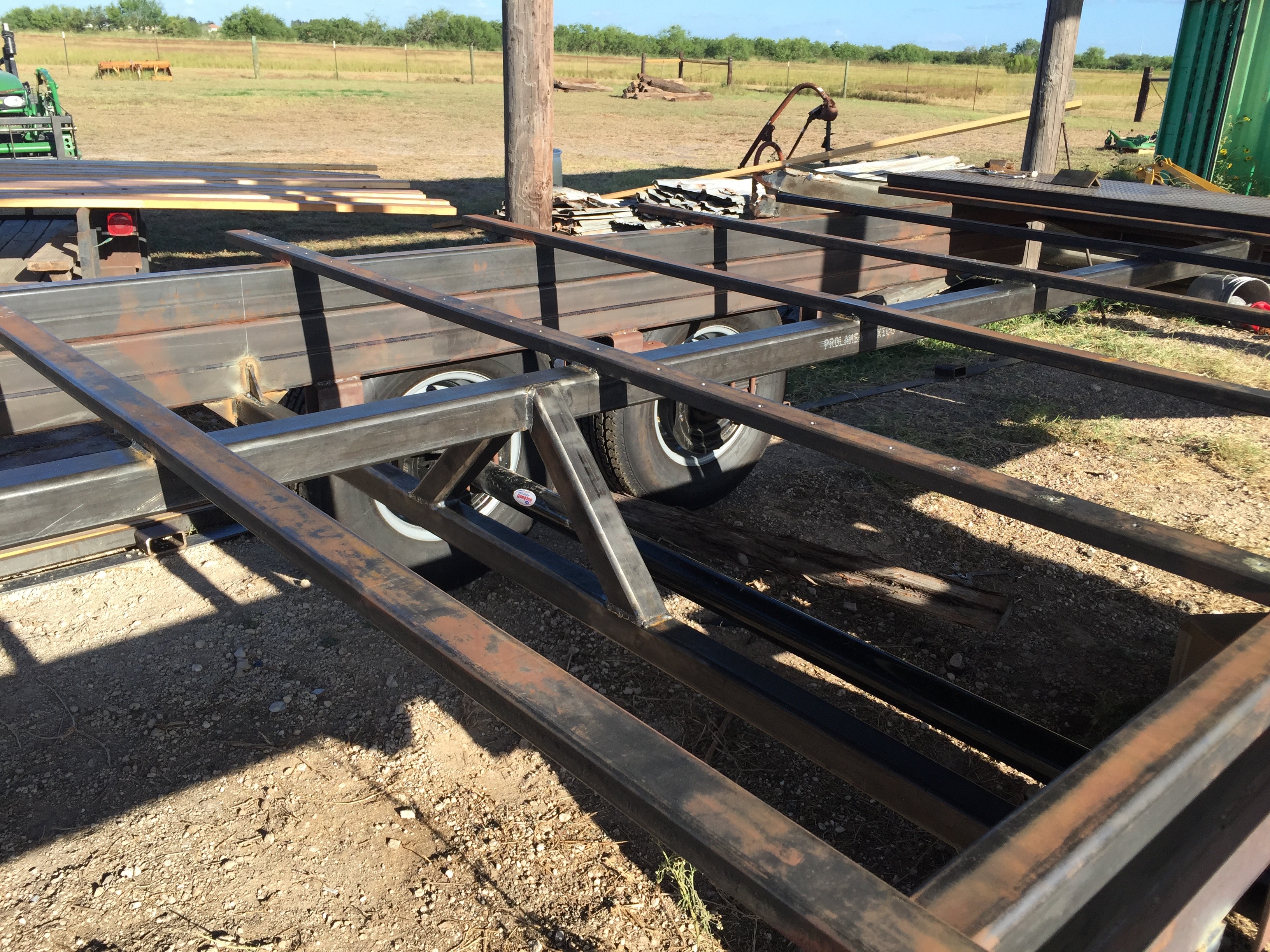

I Thank All of You that criticized and stated the obvious. I did something very similar to Renze's modification of the trailer he did. I used 2 1/2" x 1/4" square tube to go length wise in the middle of the crossmembers. At the halfway mark, I added a 2" x 1/4" square tube under the side rails with gussets all around it. Then I added a triangular brace up to the 2 1/2" beam. It came out strong and I can definitely notice the difference afterwards.
