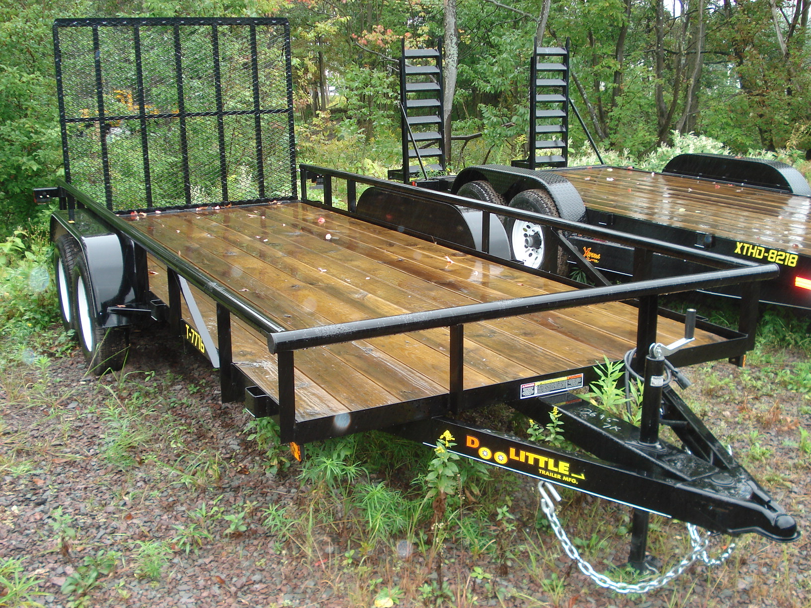

I posted pics of my stuff on another thread but i bought this from an estate sale
for 15k cash
But i took a long time in finding this deal i never get in a hurry to buy stuff if i can help it
i'm going to tow it with my rusty piece of junk old truck

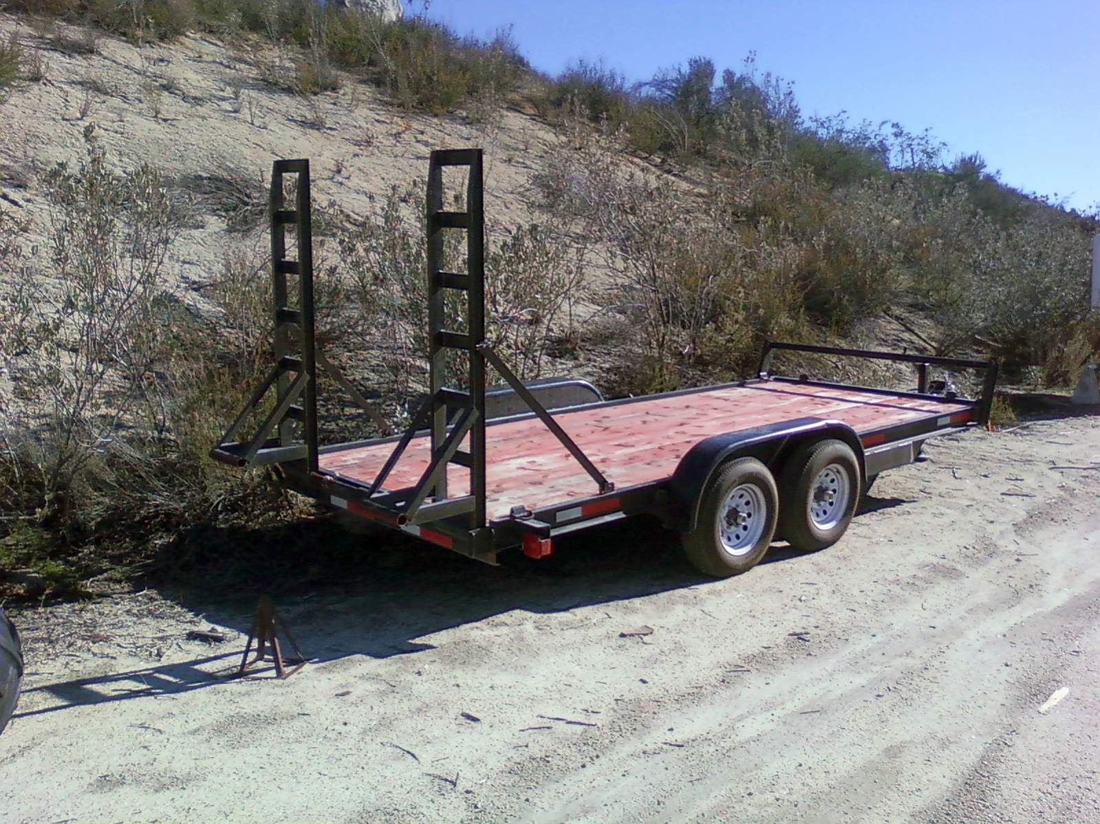

Go with a 10,000 lb gvw trailer at a minimum at an 18 foot length. This will accomidate your tractor with a FEL, and a large implement or two. Don't limit yourself. With a 10,000 lb GVW trailer you won't be limited down the road.

I read your question then read all the replies, well intended and otherwise. I wasn't going to respond until I saw the ridiculous advice (and then justification of that advice) that you won't need brakes. You have a controller installed so at least you know better. If a trailer has a 3500 pound axle, or more than one axle you need brakes. "Law of common sense"
You have a special need of keeping the trailer light and at the same time have enough load capacity for your tractor and equipment. In your case an 18 foot dual 3500 pound axle trailer would be ideal. AN equipment trailer, not the light duty landscape like your first picture. Load it to where you have about 10% of the total weight on the hitch to prevent sway. In theory you could have 7000 on the axles and another 750 on the hitch giving you a total of 7750 total weight. This of course exceeds the truck's capacity, but at least confirms a 7000 pound trailer will do the job. I had a 16 foot trailer for my L2800 and decided it was too short when I wanted to carry my rotary cutter. I had a 12k, 20 footer built, but it's too heavy for a lot of half ton trucks. I guarantee if I had another one built it would be an 18 foot 7000 GAWR, no more , no less.
All the best.
