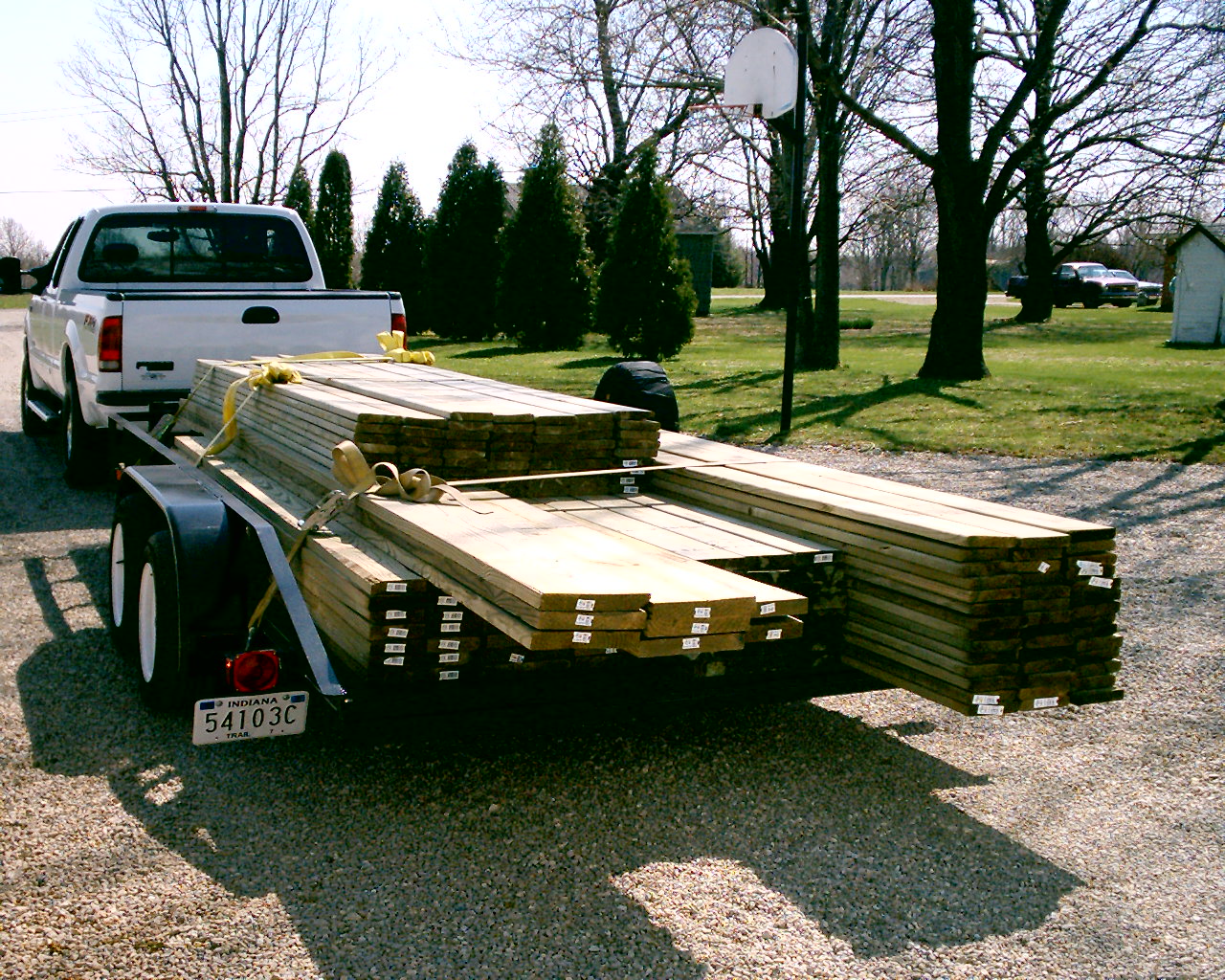

Anything more than a 7K trailer is just plain overkill for your tractor or truck. I have a 18' tandem axle trailer that weighs just a tad over 1,250# that I just used Friday to go pick up a broken down Chevy 1500 for a neighbor. My trailer has a winch. Anyway I use it all the time to tow my 5,200# tractor with no issues.
As you can see mine is a wide version of the common 18' landscape trailer. Its pictured here behind my 2004 F-250 PSD 4x4. It has ramps, no gate for me.

I bought that trailer brand new in 2004 with used tires and no brakes. I paid $680 new from the manufacture. You can not build one for that. I put brakes on one axle the week I got it.. I am in the marine business and buy and sell boats so trailers are part of my business. Today that trailer sells for $1400. By the way the used tires lasted until 2008 when I replaced them with new tires.
I would skip the fold up ramp. Causes lots of drag and I am always hauling something 2' longer than my trailer like the lumber in the picture. Also make sure you get a trailer with what they call a full wrap around tongue. That is where the C-channel that has the ball mount welded on it extends all the way back to the axle area. Cheaper built trailers will only extend to the second stringer under the deck and will bend and crack welds easily.
Chris
Have you actually weighed your trailer, it seems very light. Big Tex's lightest duty 16' tandem trailer weighs 1430 pounds and is only rated for 4000 pounds. Most 16 to 18 foot 7000 lb trailers weigh 1800-2200 pounds.

Yes, I had it weighed and my Certificate Of Origin had the weight of 1,210#. That was without the spare, brakes, or ramps which are added on top of the empty weight. I imagine with all that its at the 1,430ish weight.
I added the spare tire mount, winch, and a tool box and then had it weighed at 1250# but that was without the ramps that day.
I have hauled my 5,200# tractor probably 50 times on it with implements also for well over 10,000 miles. It has also hauled about 15 or more cars, a Suburban, and just Friday a 1/2 ton Chevy. Mine is listed as 7,000# GVWR with 5,790# payload on the sticker with the Vin# at the tongue.
