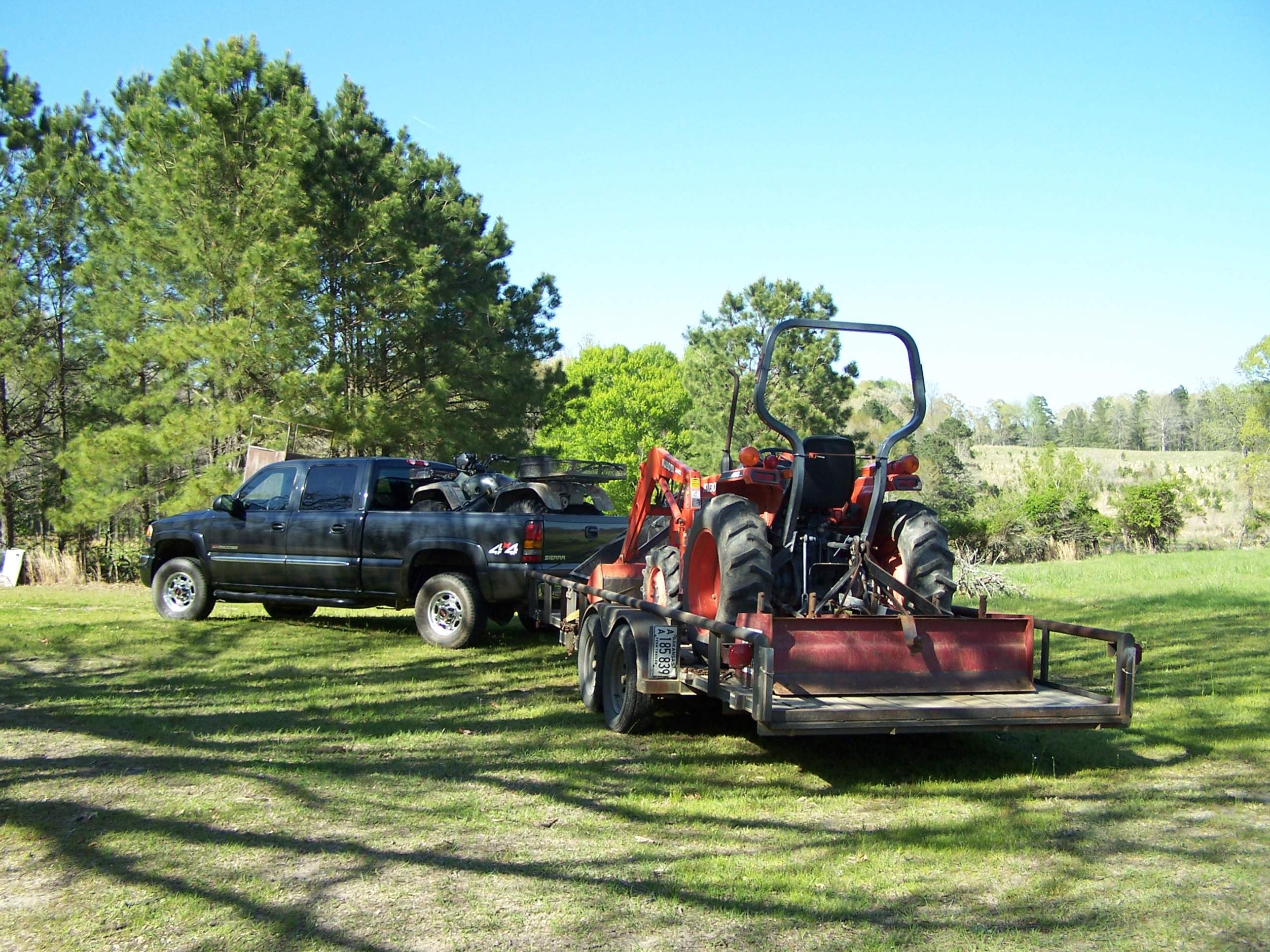

hi folks,
Well I am thinking about buying a trailer for the 3400..
and I really don't expect to pull it much..
But the coming year may see the construction of another house and I don't think I am going to leave the tractor there....
Looking around I found :
Buy & Sell New & Used Trailers 6 FT 4 IN X 16 UTILITY TRAILER WITH TUBING RAMP GATE at TrailerShopper.com
Buy & Sell New & Used Trailers CarryOn Equipment 7X16 Tandem Axle Black at TrailerShopper.com
pulling truck is a 2010 Tacoma,4x4 LB, automatic with tow package-
Rating is 6500 towing and I have a brake controller...
Should I not consider doing this?
or will a small 15 foot of so trailer be ok?
my L3400 has a loader, with loaded rear tires..
and a "light" boxblade 350 or so...
thoughts???
J
The tandom axel trailer looks nice but i could not find any mention of brakes.
I think your truck would pull it fine but like another post said you NEED trailer brakes.

I have an 08 Tacoma manual, 4X4 and a 20' bigtex car hauler. My numbers would be 2600 tractor, 900 loader, 500 loaded tires, 830 BB, 2200 trailer coming to 7030. I would be 530lbs over the Tacos tow rating and 30lbs over the trailer rating.
I have a different truck to tow my L2800 in this configuration when I need to so the only thing I would be doing is over grossing the trailer by 30lbs.
I haven't towed anything over 4000 lbs with the Taco yet so I don't know how it acts with anything heavier and I do have a brake controller.
Just be sure you install a brake controller and watch your weights, also if you still have the three leaf pack you may not like how it will squat, there is a TSB (don't know on 2010 years but 05-09) for harsh ride with weight, basically you go from a three leaf pack to a four to carry the weight.

I have a L3400 HST and a 16 foot tandem axle trailer (7K rated). My 2003 Chevrolet 1500 (5.3L with auto) pulls the tractor just fine on flat ground. The tractor and box blade fit completely on the trailer and my FEL sits at the very front of the trailer flat and firm. The truck has plenty of stopping power.
If I bring the mower it will stick off the back of the trailer a few feet, no big deal.
Remember, with trailer brakes, it's one more thing to keep up. I think you are fine without them, unless you are towing heavily.

Wow! I am glad you were not on the road near me when I was in Texas a few months ago(I hope...).
Let's see you stop when that deer runs in front of you. Or that kid on the bicycle. Or the kid chasing a ball. A blowout on your truck. Or, in my case, the little white Honda cuts you off and hits the brakes...
I trailered my tractor on a borrowed trailer once. Was running 55mph when this little Honda cuts me off bad, and tags the brakes so it could catch an exit. Well, the brakes didn't work that time on that borrowed trailer.
It pushed my 3/4 ton a lot. Fortunately, I was on a straightaway; if on a curve I think it would have jack knifed me. As it was, my anti-locks were working overtime for a few moments.
5500lbs+ is a lot to tow with no brakes, no matter what size pickup. I'm looking at those L3400's to buy; now way I would tow it without brakes on the trailer.

You can tow that load with a 1/2 ton.
My point simply is brakes. "I" would not tow the load without brakes, even if it is legal in your state.
My point above; as I noted I have been in a "stop or I'm hitting the guy in the little Honda that just cut me off" situation. My 3/4 ton barely did it. With a lighter tractor on the trailer. The brakes on that borrowed trailer were marginal at best, but bad when a wire came loose...
I would tow the load stated in this thread with a 1/2 ton. And... I would have working trailer brakes. In case that little white Honda cuts you off. Or, a little 5 year old kid chases a ball in to the road...

For the 2009 Silverado trucks Chevrolet disagrees with you (if you look in your manual you will probably find a similar statement, but I could not find a 2003 Silverado manual online). On page 4-67 of the 2009 Silverado Owners Manual (PDF page 397) it says:
A loaded trailer that weighs more than 2,000 lbs (900 kg) needs to have its own brake system that is adequate for the weight of the trailer. Be sure to read and follow the instructions for the trailer brakes so they are installed, adjusted and maintained properly.
As for your disdain for trailer brakes
I agree that you are fine without them if you are not towing heavily. however, I define "towing heavily" as pulling anything more than a 3000# single axle trailer.
You owe it to the other people on the road to have working brakes on a trailer that weighs more than 3500#. The life you save may be your own.
