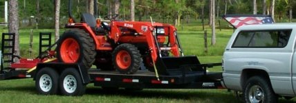

I have a Kubota L3010 HST,fel w/hd bucket,loaded R4 tires,9'BH,the tractor weight is 6500#. The trailer I use is 18' with a 10,000 GVW. I have also used it to haul the tractor -loader with landscape rake,and 4'bush hog,all configurations use up all 18'. I would never consider anything smaller than 18'.

I'm towing a B2710 with various implements, depending on the job, with a Ford F150 4X4. I went with an 18 foot car hauler and wish I'd gone up to the 20 footer just to give myself a little more room to play with my load position. Well, that and the fact that the rotary mower hangs off the back end.
The loader/backhoe combination gives me a total tow weight of 5560 pounds and a tongue weight of 825 pounds, which necessitated a jump up to a class IV hitch.
One thing I'd be looking at is the width of the ramps. I didn't /forums/images/graemlins/frown.gif My machine is set up for as much width as I can get, and when my ramps are positioned for the front wheels (about 29 inches between those two as I recall) my rears are over the outside edges of the ramps. I really would prefer to have a little more wiggle room there.
