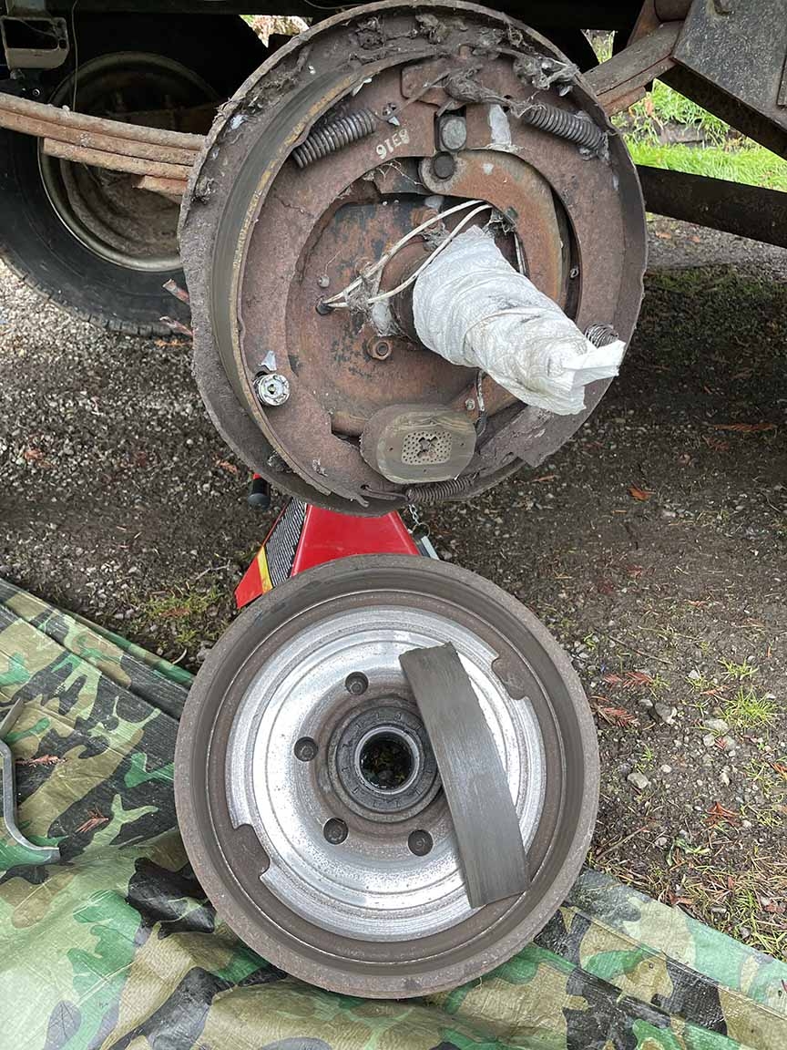

Got the brake apart!
TGMT, you were right.

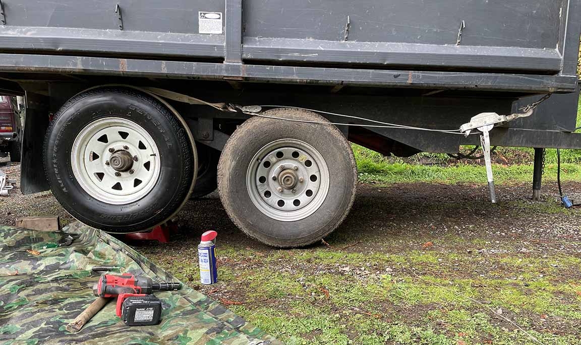

I thought that if it was friction material that since the first thing I did was reverse, that rolling the wheel forward might un-stick it.
You can see my strap-wrap and the come-a-long.
It worked (easily).
the friction material is still 4.5mm thick.
I'm thinking this 1998 trailer has had an easy life.

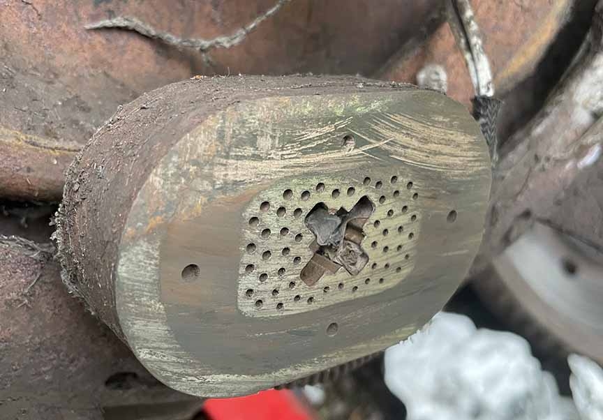

Here's the magnet shoe.
First time I've worked on a trailer brake - but this looks like it has a long lifetime remaining.
So I have to order some brake shoes.
How can I figure out what size brake this is?
Take some measurements to verify but a readily available 6 lug brake kit should get you fixed up.

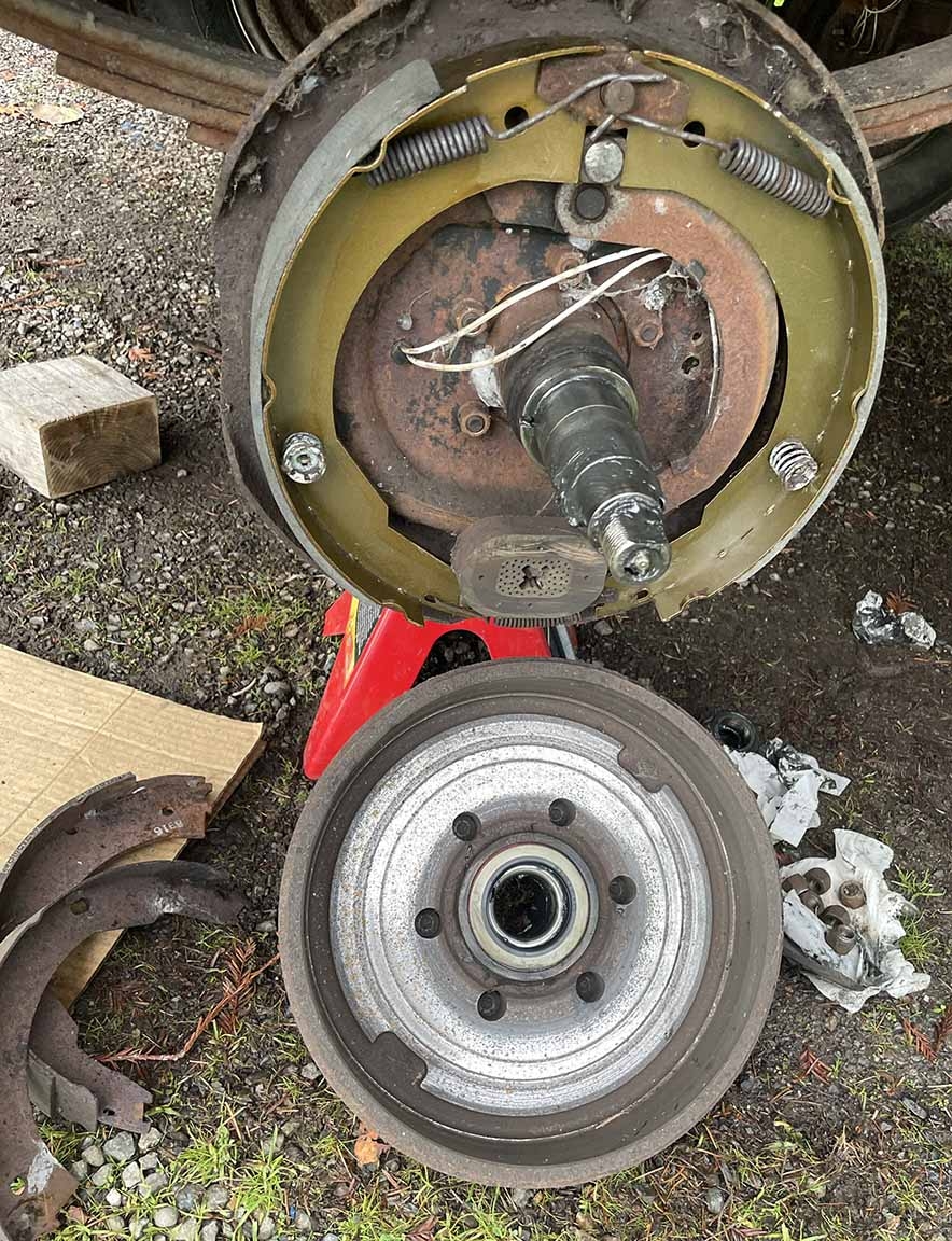

Extra time & energy & $$ go to more important projects.
My flatbed trailer has two brakes unable to skid their tires.
New shoes and a new seal.
Bearings were absolutely perfect.
I changed the seal just because it had a tiny 'flat' on the sealing ridge.
The adjuster screw was real nice too, but stuck solid.
I freed up the adjuster and put anti-seize on the threads and inside its sleeve.
OK so on to adjusting these brakes.
Is it same as a vehicle?
I'm thinking that I tighten the adjuster good and tight, then back off until the drum spins free.
How free? Should it have some friction with the new shoes?

I like to adjust them until I can hear it touch but no real drag. I’m afraid it would overheat to go any tighter.

You can see in the pics there is no self-adjusting mechanism on these brakes.
I set them so the shoes touched, and decided to “drive it” a bit, and then “remember;)” to adjust again later to “touching” again.
Anyway it’s returned to service now, thanks for all the assistance!!
