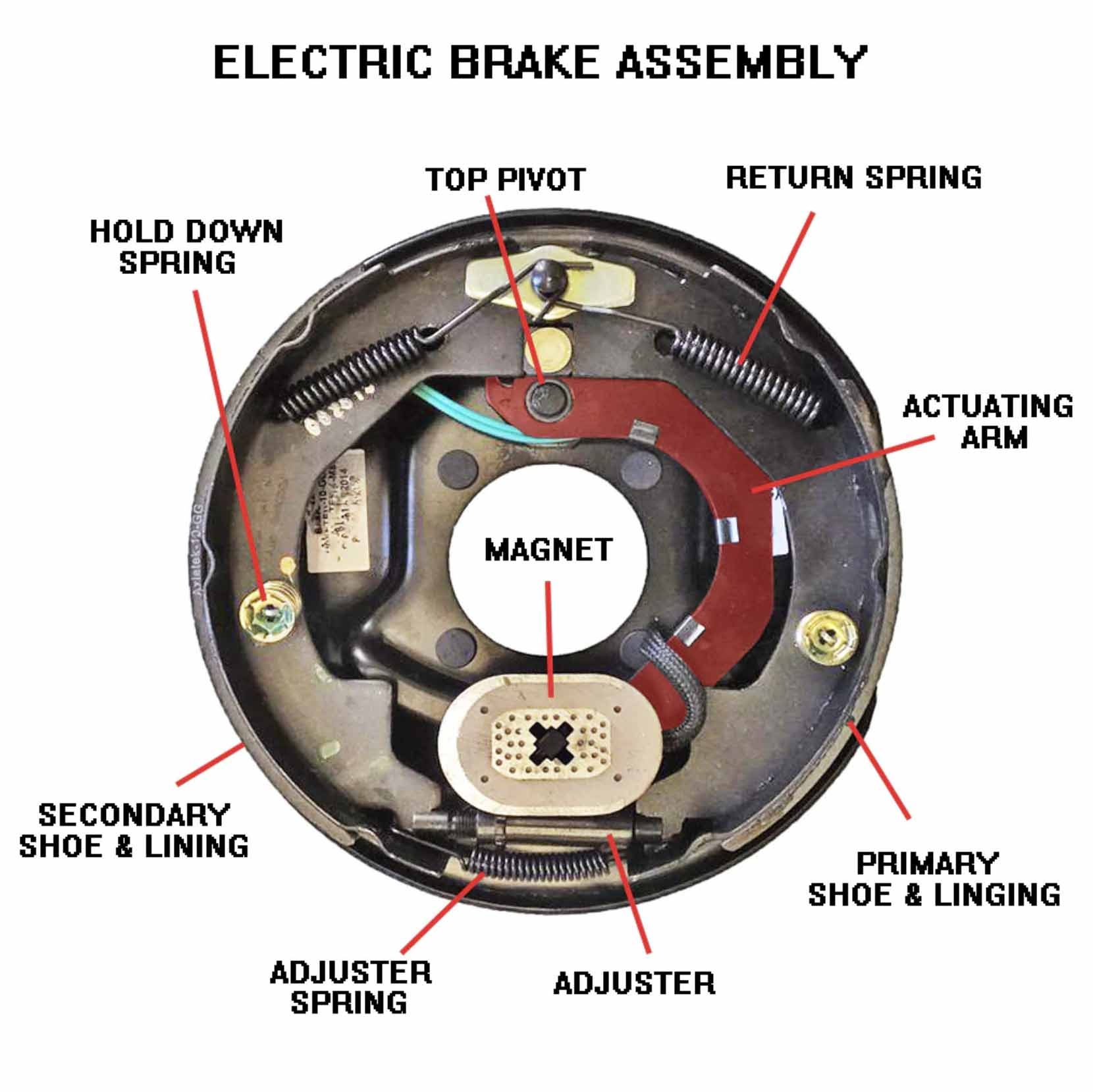

In this internet pic..... it looks like theres a hole in the backing plate that you can pry on the actuating arm.
I will try that.

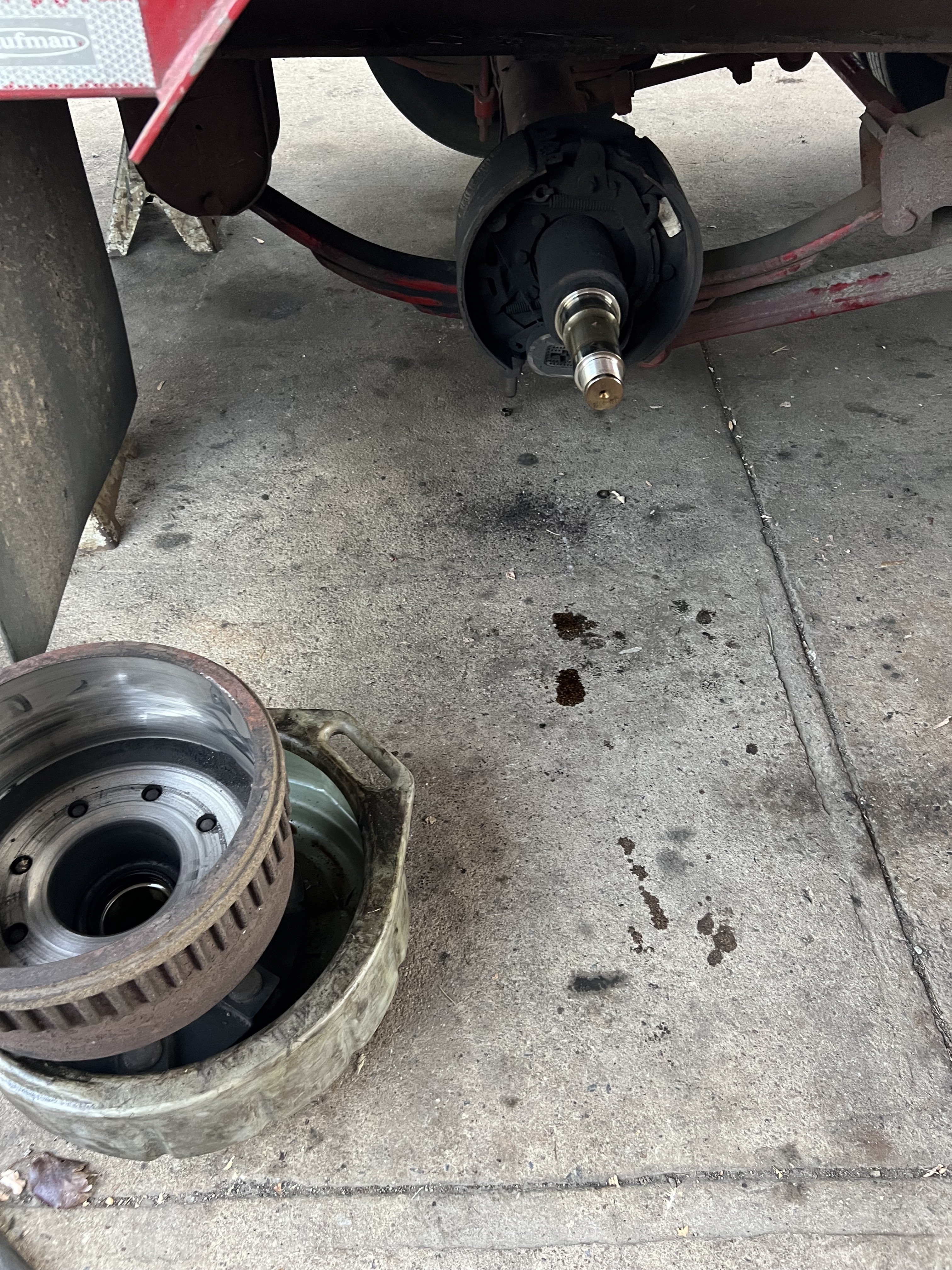

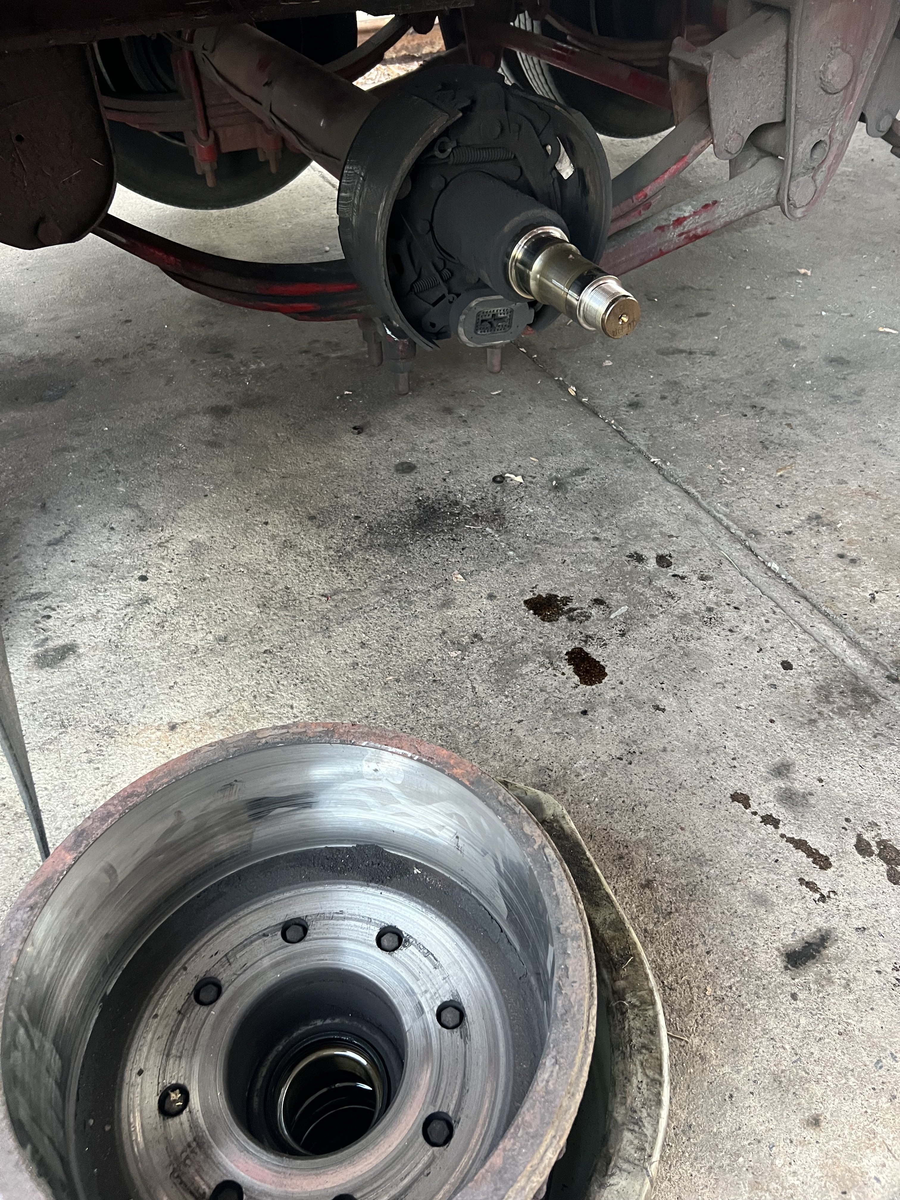

I just did brakes on one corner of my 38,500lb gooseneck.]
Shoe cracked and wore out drum.
It was a sumbeetch getting the 12-1/4” drum and hub off
Can’t believe the prices for Dexter parts.
$650!

There are videos on YT on how electric trailer brakes work which will show you what is inside and how the magnet pulls an arm to engage the brakes. In your high humid environment its highly possible the arm may have rusted in the on position applying the shoe to the drum.
$650!
Heavy duty electric brakes are freaking expensive. I was wondering what it would cost to convert to hydraulic disk vs pads and drums on all 4 when the day comes that my trailer needs it.

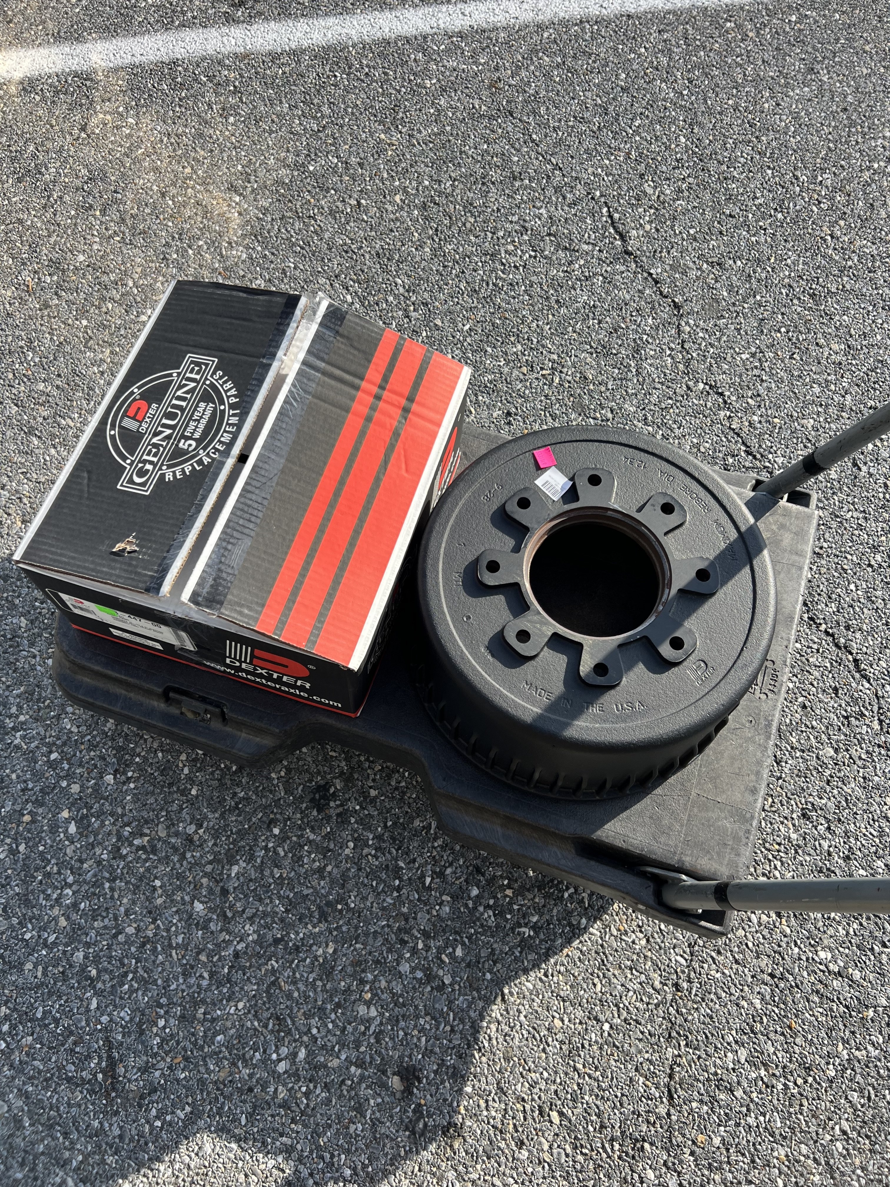

Not much cheaper anyway. I bought mine in tax free Delaware.
Drum was $369 with no tax
Brake shoes, springs, etc. kit was $395 no tax.
In fact, your first link to etrailer shows they drop ship the drum from the very company I purchased my drum from Eastern Marine in Newark, DE. lol

There's no holes in the backing plate, no access to the internal mechanism.

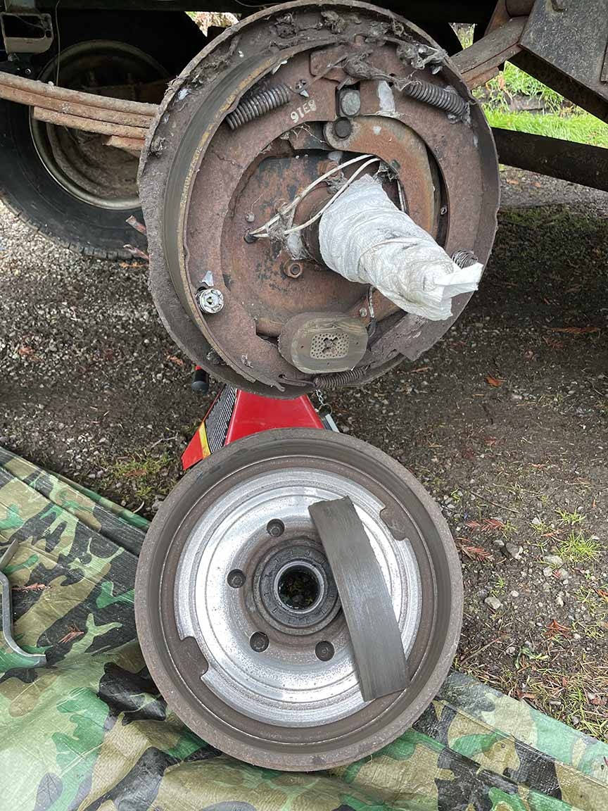

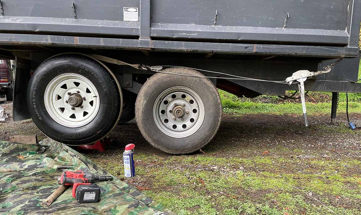

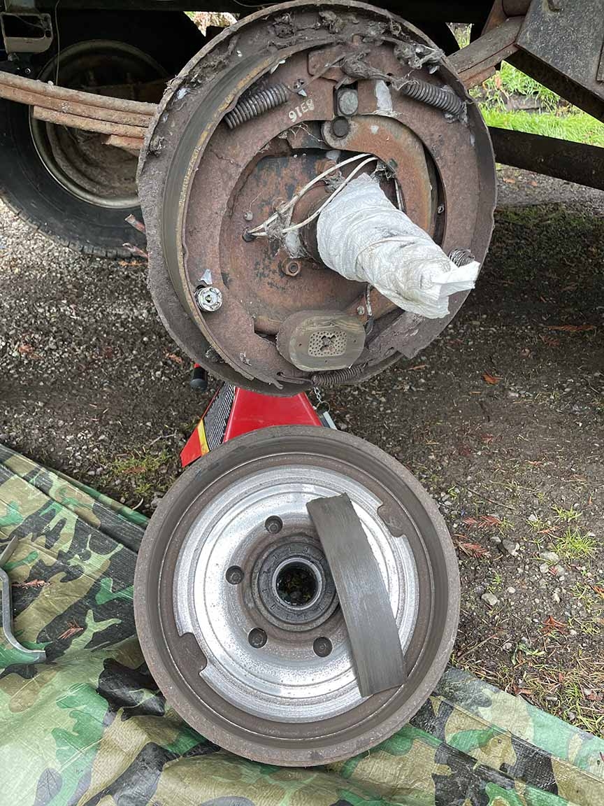

Got the brake apart!
TGMT, you were right.
I thought that if it was friction material that since the first thing I did was reverse, that rolling the wheel forward might un-stick it.
You can see my strap-wrap and the come-a-long.
It worked (easily).
the friction material is still 4.5mm thick.
I'm thinking this 1998 trailer has had an easy life.
Here's the magnet shoe.
First time I've worked on a trailer brake - but this looks like it has a long lifetime remaining.

Looks like 12 inch drums. Is it stamped in the face of the drum? Sometimes, you get lucky, and specs are on the drum.
/ Trailer brake is stuck #18
Measure the diameter of the drum and the width of the swept area in the drum. That should give you dimensions very close to your shoe size. Brake shoe that is.

I’d suggest replacing everything. Although a bit more in parts, you’ll have the entire brake assembly rebuilt all in one day.
/ Trailer brake is stuck #20
Last time I had a wheel lock up it was due to one shoe lining coming lose and wedging between the other shoe and drum.
Same. In my case, it bound up for a second, then released. But then things sounded mighty awful after that, until I pulled the thing apart to find what was rattling around in there. :D
