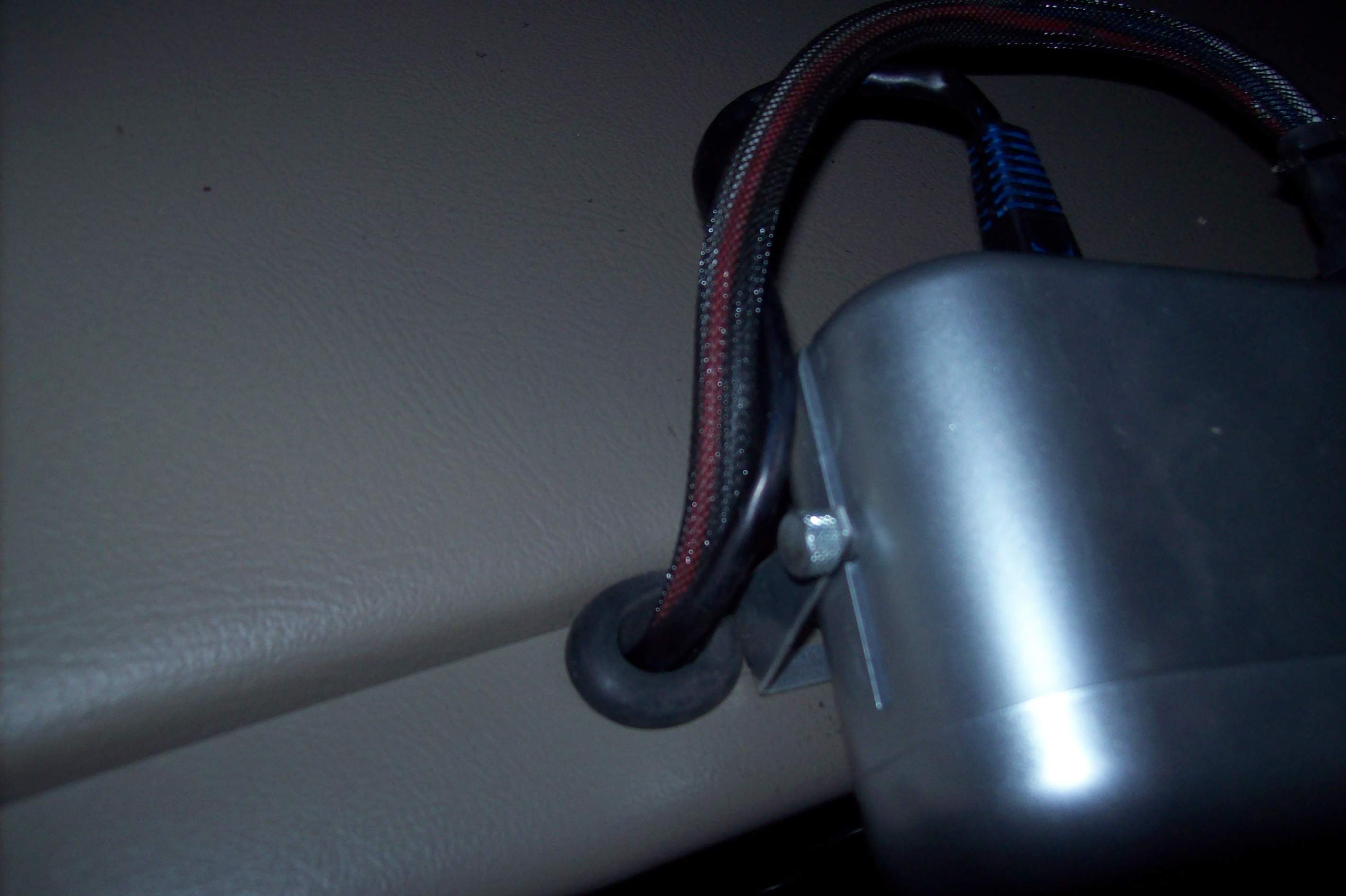

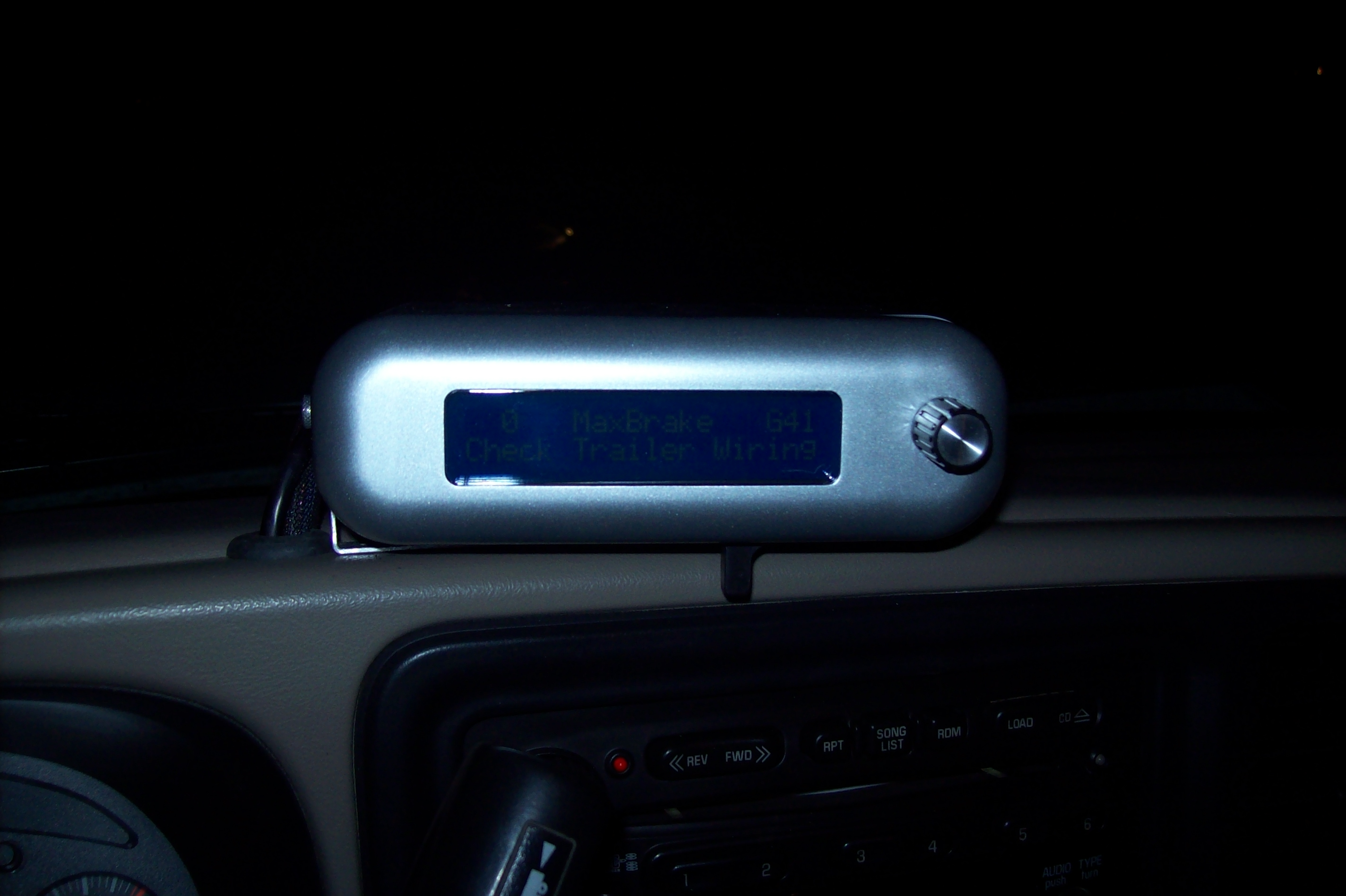

Well, finally got the 'Maxbrake' controller installed. I couldn't find a better place to mount the head unit other than the right side of the top of the dash. I found the front fascia of the drivers side of the dash popped off with a simple tug. I had to add an additional 20" to the cable that attaches to the firewall. I didn't need to modify any other panel. I did slid the mesh that covers the cable up to the back of the controller end of the cable and added some heat shrink to cover the connector backside (in nicer connectors you have a backshell, but I don't think the Maxbrake folks thought the dash top mount would be common). I still had to use a tie wrap to hold it under the shrink wrap. It would have been nice to have had some 3:1 heat shrink handy. I had to pull the knee panel (2 screws) and the connector panel on the firewall (easy - tool free) to get to the body plug I used to pull the wire through. The most difficult part of it was adding in the 20". Next was the body plug (access was as much an issue). Nothing was particularly difficult.
I also took a black magic marker and made the exposed part of the cat/ethernet/rj45 cable black. The far end is the Honeywell pressure transducer connector.

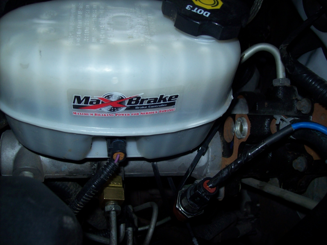

I mounted the brake line 'T' to the rear brake circuit, as that was where there was room (you need to include room for bleeding). I wrapped the ~12" long extension line into a 'U' or 'J' so it didn't touch any other brake lines (vibration and wear). I put a piece of heater hose onto the transducer, but need an 'adell' style hose clamp around it and onto the master cylinder brake mounting stud. Bleeding was not even needed (I did it, but immediately had fluid -- yeah).
The line of sight over the controller is still below the hood line, and driver to display is pretty straight on (we'll see how ambient light and glare affect it). Calibration took maybe 1 minute. Manual control of the brake seems good (finger straight back to the dash and left, smooth). Now to put it to work!

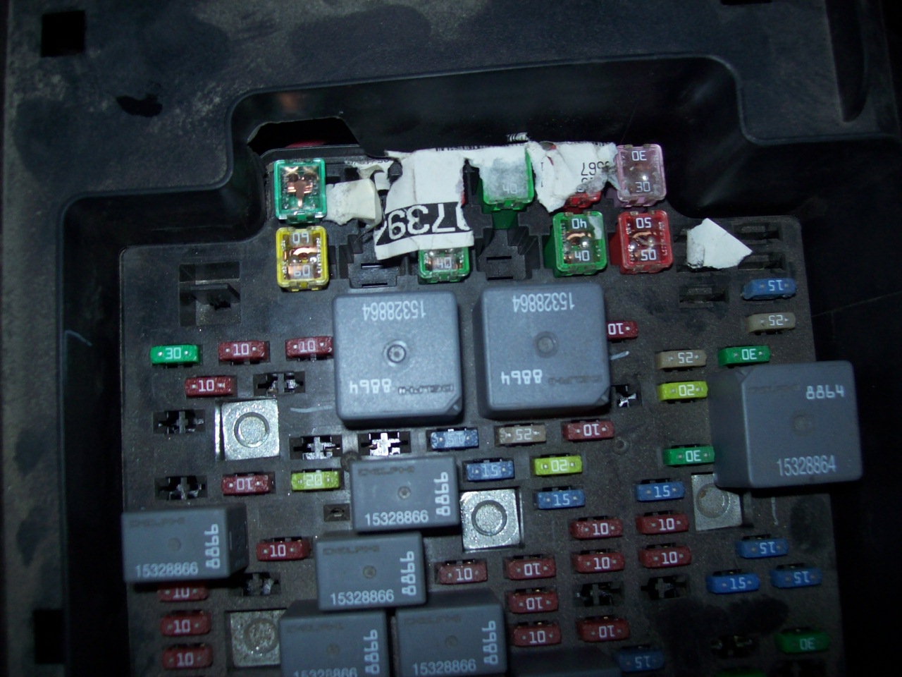

Oh, forgot: the fuse panel under the hood. The top left is 'post #1' (trailer connector battery), the top right is 'post #2'. Post #2 may have to be connected (the posts are under the cover surrounding the fuse panel). That bit of info was easy to find (post #2 powers the controller). What wasn't obvious was is that post number 1 also needed to be fused. It had a dummy plug in the top left position, but the whole row had a sticker over them, so it was even less obvious. Nothing like wasting 20~30 minutes tracing this out.

The fuse for that is SUPPOSED to be in the glove box when the truck leaves the factory.
