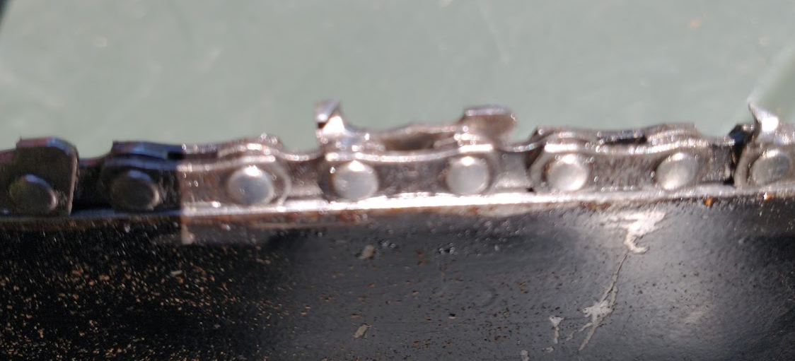

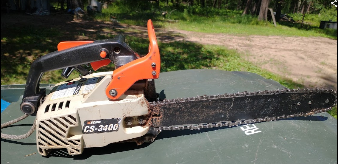

Not sure where I posted this review but today, I can't locate it. This is a mini battery powered saw review of the Makita XCU06SM1.
I had tested a few battery saws over the years and wasn't very impressed with them. Low power, poor battery life and heavy in general comes to mind. This past summer while I was clearing brush from a closed down manufacturer's site that had trees growing into fences and steel laying everywhere in the brush and weeds. An elderly fellow stopped by to chat (common practice at this location) and he showed me his mini battery powered stihl saw he had just got. I kinda liked it! What I didn't like was the manual oiling of the bar which I'd lose that little oil bottle in seconds and it used Stihl little batteries but did see these low powered little saws as a safety thing working among all the steel there. After doing some research I ended up with two Makita XCU06SM1 Lithium-Ion Brushless Cordless 18V LXT with a 10" baras seen in the pics. I already used Makita 18 volt tools and you could find aftermarket batteries with very large capacities for them at reasonable prices. Another plus is these Makita XCU06SM1 had bar oil tanks, kick-back brake, top handle, super light in weight and setup very much like normal saws have. These are really made for limbing and short runs before the motor overheats. Nonetheless, when we need to pack a saw in, we'll take one of these or carry one in my 6x6 while working in snow and I think we'll need to do minor sawing. These are so light in weight and small, they add next to nothing to your pack. Makita claims weight is only 7.2 lbs. with battery. One handed sawing could become normal with these. (not safe, don't recommend)
Down side.
When used like a normal saw, they'll overheat and shut down in minutes. This is why I got two but they really are made for just limbing. It has pretty modest power.
there specs
  • Compact top handle design built for the professional tree care industry
  • Makita-built outer rotor brushless motor direct-drive system provides high power efficiency
  • Variable speed trigger and high chain speed (0-4,720 FPM) for improved cutting performance
  • Torque boost mode for cutting dense material
  • Captured bar nut and lateral chain tensioning for convenient operation and maintenance
