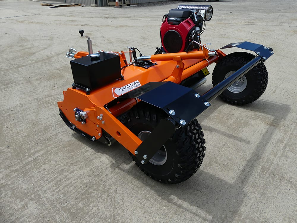

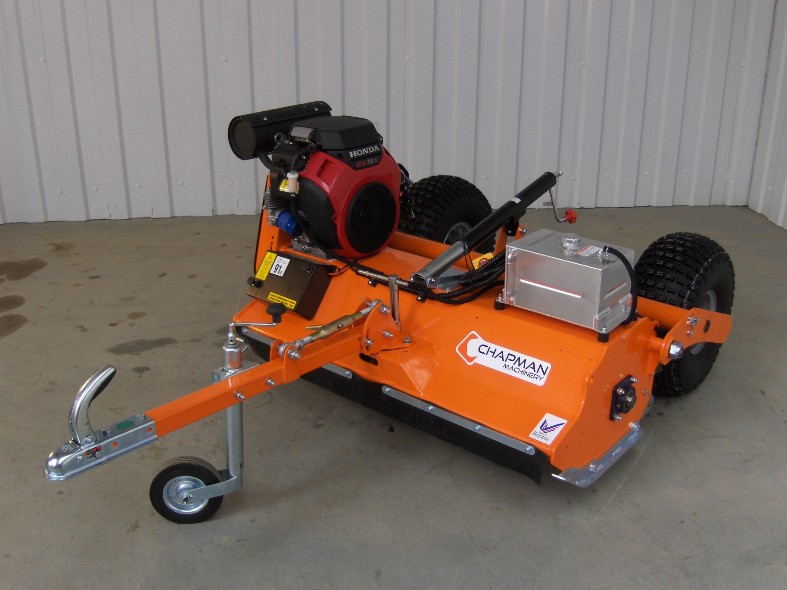

/ trail clearing technique and tools #204
Thank you for your kind words. We have had folks run "brush hogs" on trails we worked on. We don't like the 5"-+ stumble of trees shoots they leave behind. It's not fun to walk through and might even punch an atv tire. Flails can do a lower cut.
Don't tell anyone, but we're not getting younger. :cautious:
I am not knowledgeable to know what rocks will do to a flail. I looked at getting one but we have plenty of rocks from egg to grapefruit size and I fear they would destroy flail hammers after a few encounters. If you have few rocks, it may not matter.
I am too selfish to spend a lot of money on tools to maintain trails for others and strangers. And flail mowers are expensive to this old boy.
This thing from DR uses 175 trimmer string and should be easier than using a handheld trimer. IIRC they have a decent return policy if you are not happy with it. I get tired hanging on to a trimmer for very long...but I am a wussy. Something on wheels would be easier I think.
We have a system here who have a flail on there compact tractor and they hit rocks on a regular bases. Clearing weeds, grass and tree shoots with our weed whackers is not all that hard of job but we have some wide logging roads which are just to time consuming to do with them. This is why we are looking at that Chapman flail.
Having used and fixed a DR product we will not even considering getting another. They are better built to sit in the shed, than to be used.

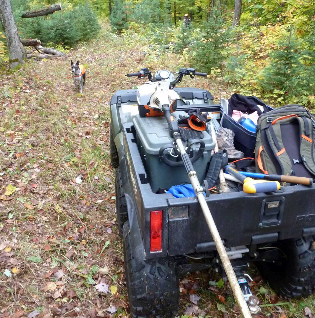

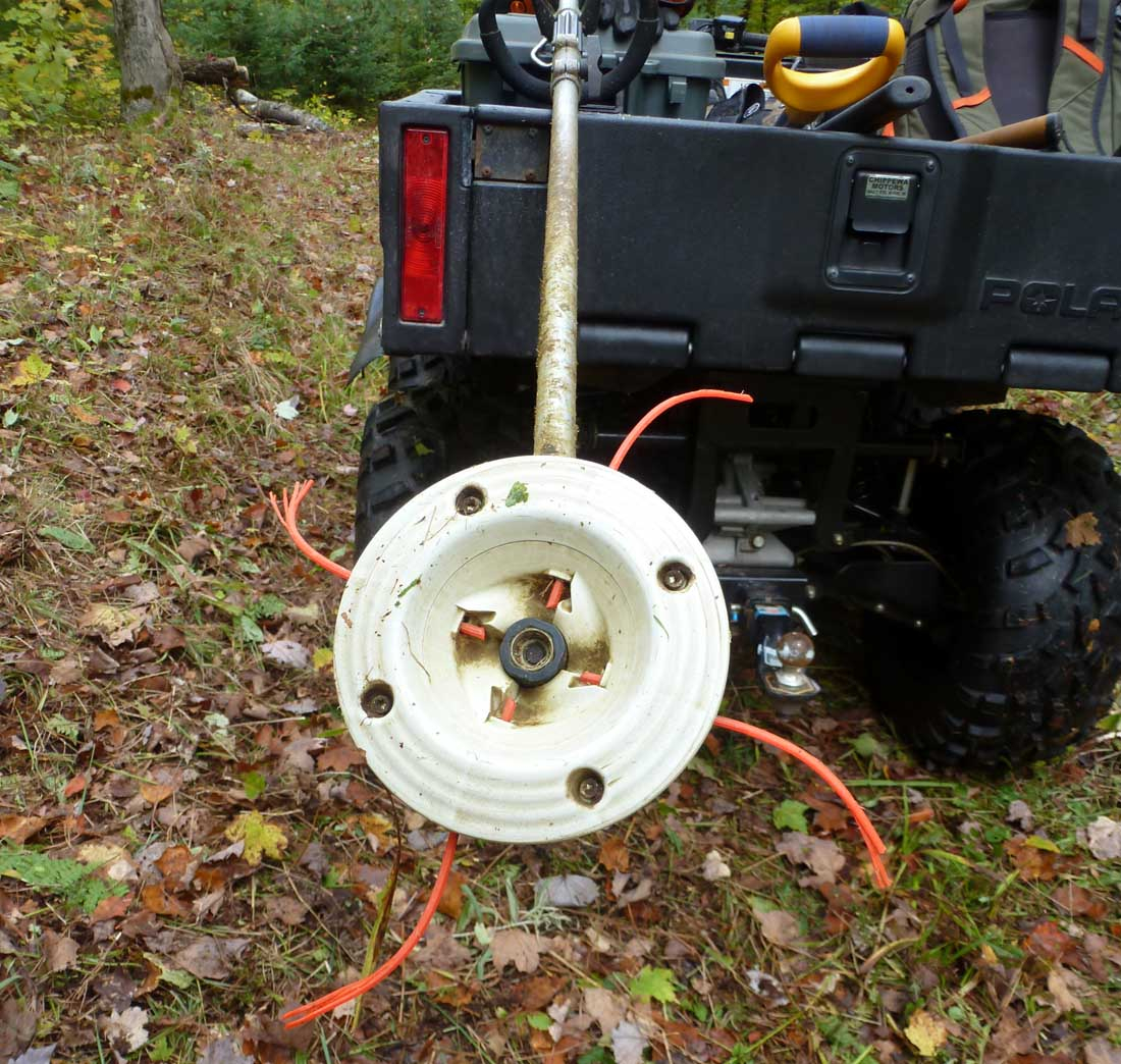

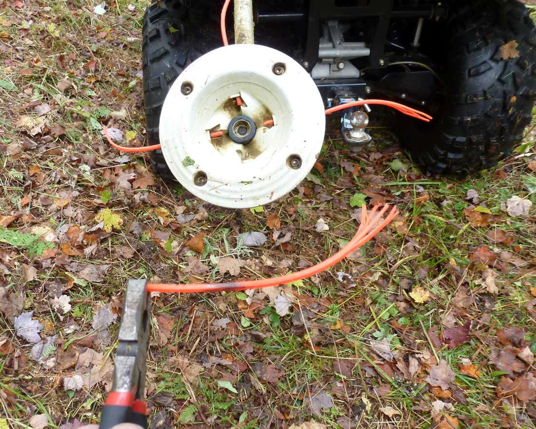

Seems that some people might not know how we change these crazy cam lock whacker strings so today, I took a few photos to demonstrate the process. Ya, its crazy complicated!
Back at the 6x6 for a snack, I note my strings are looking a bit ratty so I place the unit in the machines box.
Next a grab the handy-dandy 6" linemen pliers from my pocket gab there ends and pull.
Wala!

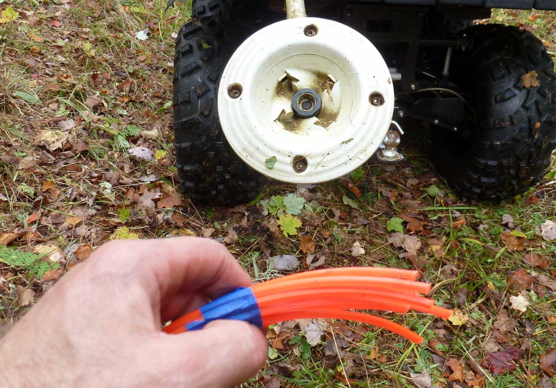

Again I dig in my pocket and find a bundle of strings. Who put them in there anyway? :unsure:

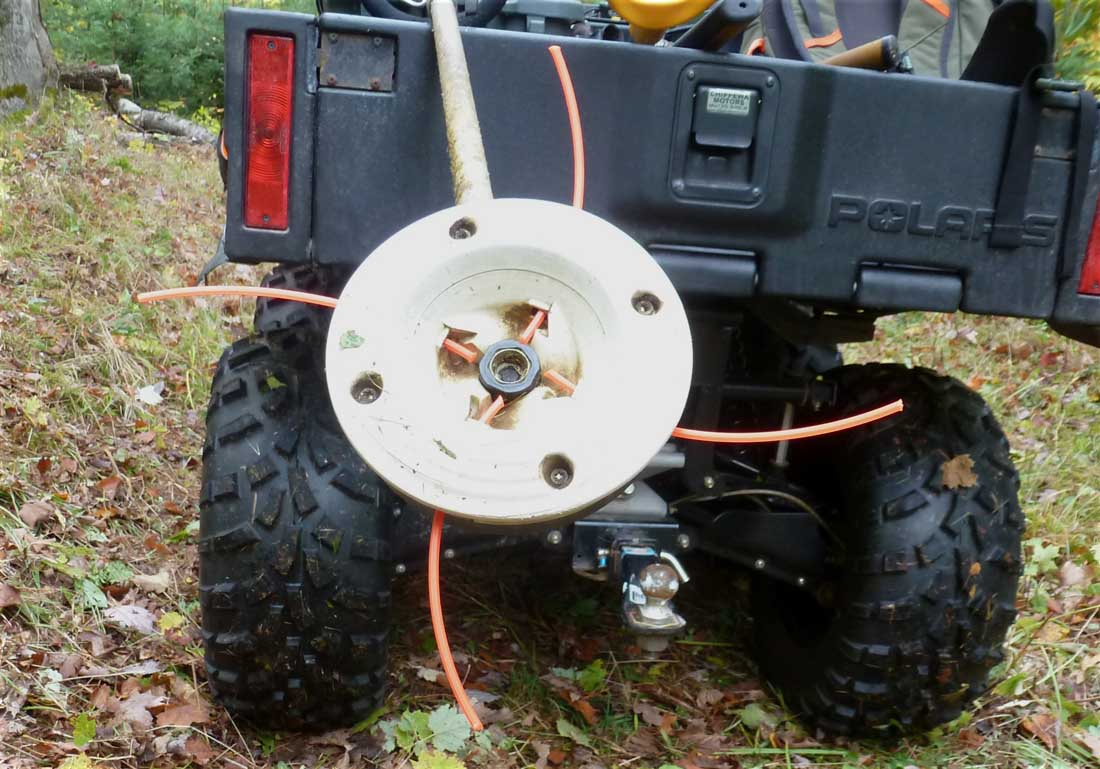

Seconds later, 4 new strings magically arrive. These cost less than $1 and should take less than 60 seconds to do, but I was having a snack. :LOL:
I hope that helps. Today's trail working photos to follow.

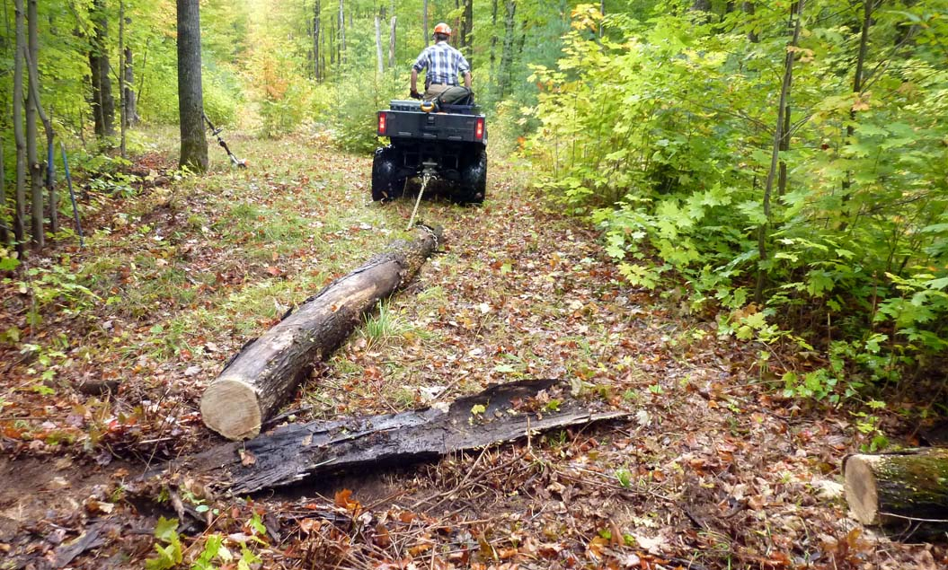

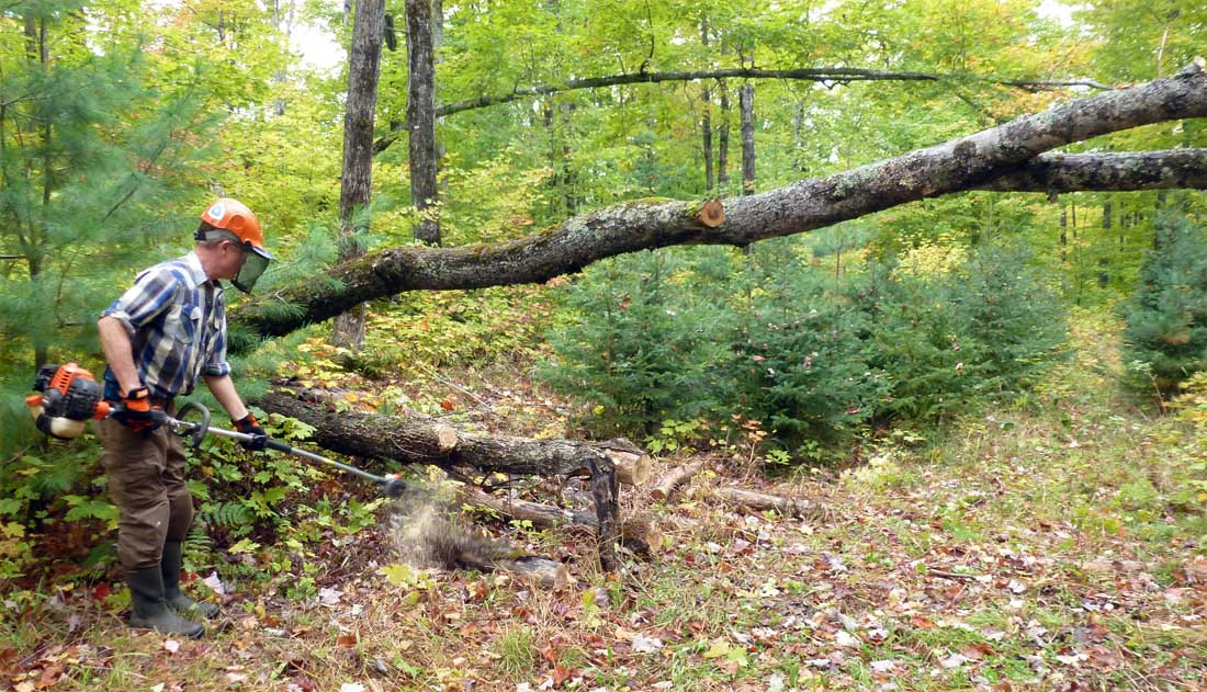

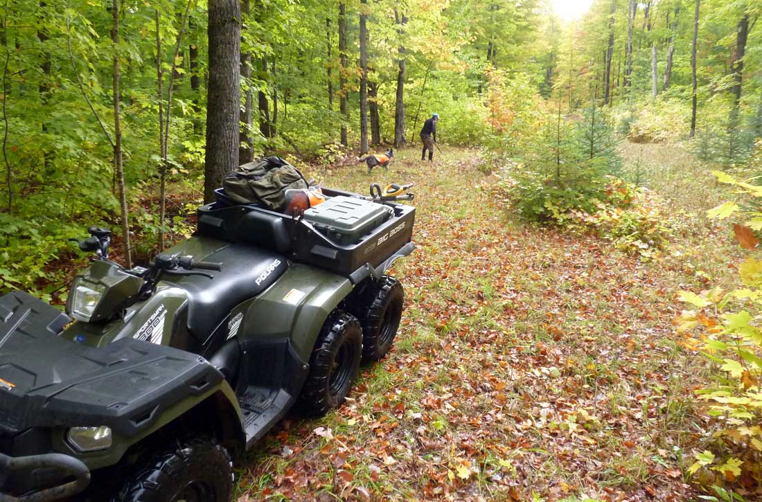

At work on a trail today. Does it look like fall here??

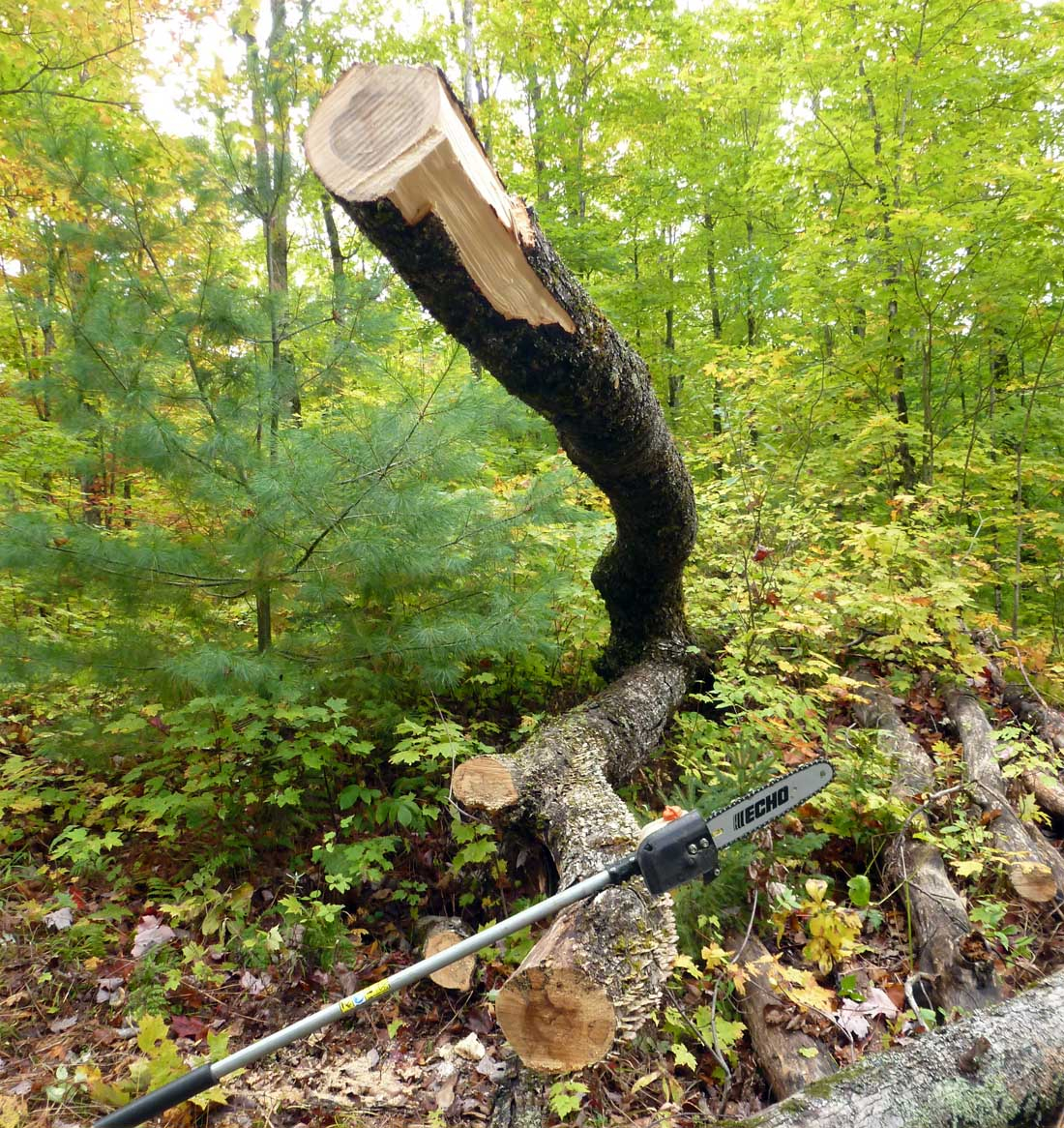

Who needs a pole saw??!!??!!

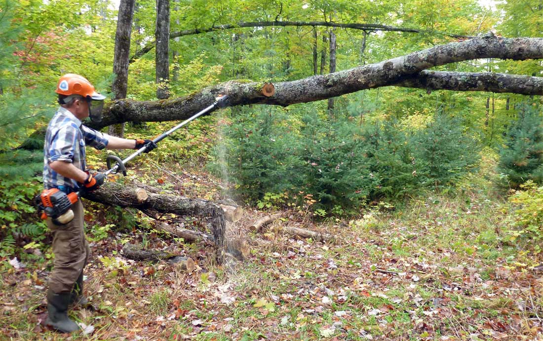

This cut is above my head.

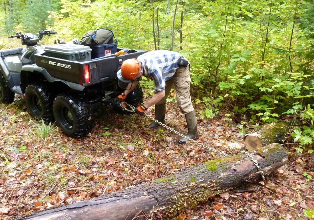

Why do we appreciate a 6x6?
