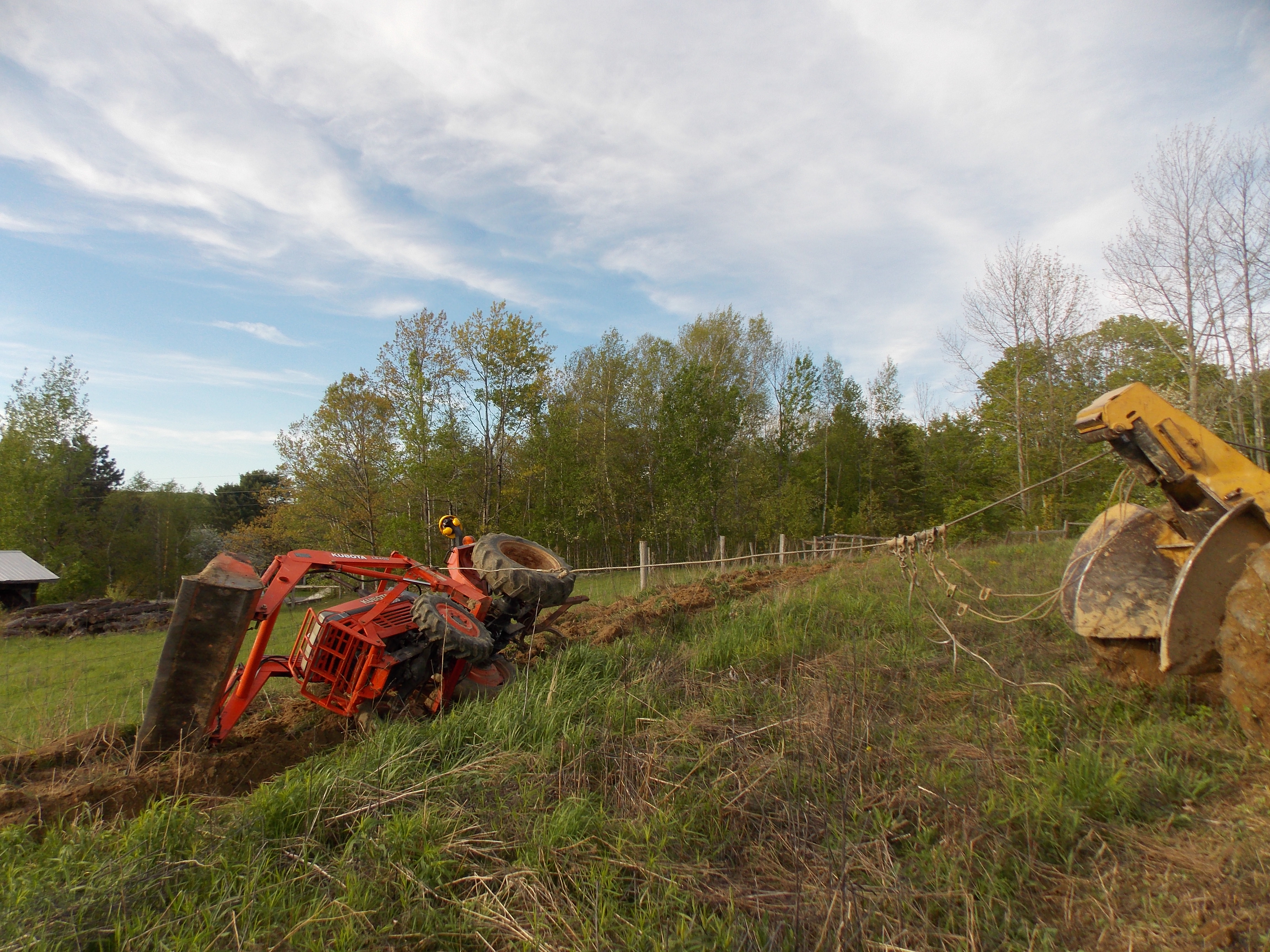

I have only rolled a tractor once, and that was last summer. Darnest thing, on only a 15% grade and in the edge of a field. (And yes I got pictures). That occured because I had my bucket up too high so that I could clear a fence on a turn, and because I popped my front tire out of the furrow I had just cut. When I went back into the furrow the tractor just went over...slowlyyyyyyyyyyyyyyyyyyyyyyyy. It was so slow I just stepped off it like it was in slow motion.
My constant fear has always been in rolling the skidder because it gets in some bad situations really quick. Not only is it expected to work on steep grades...both straight up and down, but on side hills; it does not have a lick of brakes. Adding to the pucker-factor sometimes is stumps. Roll over a stump a foot high and you swear you are going over! The final thing that adds to the pucker-factor is the articulation. As the machine is steered (articulated) the wheel base changes. If you turn UP the hill, the uphill side of the tractor pushes the tires closer together while the tires on the lower side of the hill are pushed further apart. This increases stability, BUT turn down the hill, and everything is reversed and the stability on the hill worsens. Always keep that in mind on an articulated tractor.
But on my bulldozers...I get downright crazy. With their low center of gravity they are impossible to roll over. That is my preferred weapon to log with on steep slopes.
Picture of tractor roll-over...
