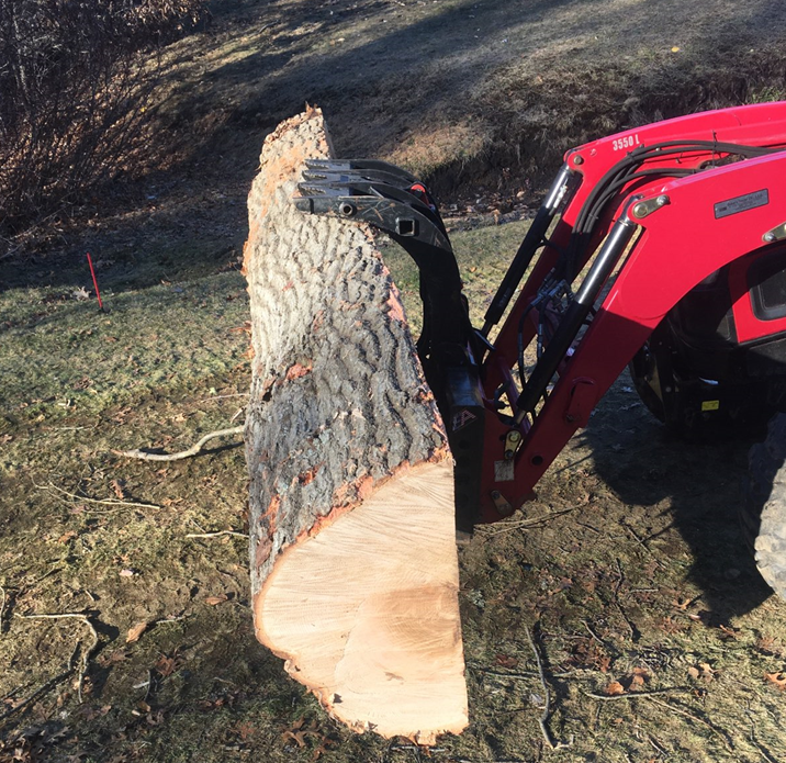

Weight out from lift pin makes a big difference in lift capacity. Heavy logs I can’t lift to load with forks I can grip with grapple from the top and lift. Grapple is more than twice the weight of the forks. But grabbing from top, the center of gravity of the log is closer to the tractor. Fortunately don’t happen too often.

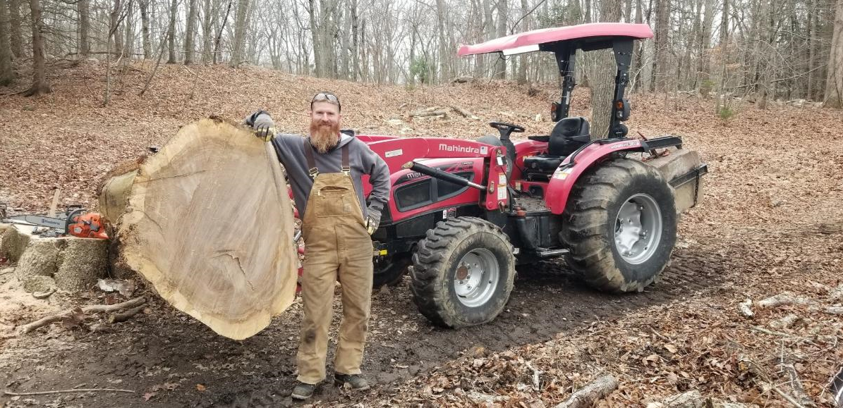

It would be a fun contest to see if my 135HP Challenger @15,000lbs with Ag tires and both axles locked could push more across mud than a tracked skid steer. I think the weight of the tractor would really help. If the mud was 12” deep or more, I’d lean tractor. ;)

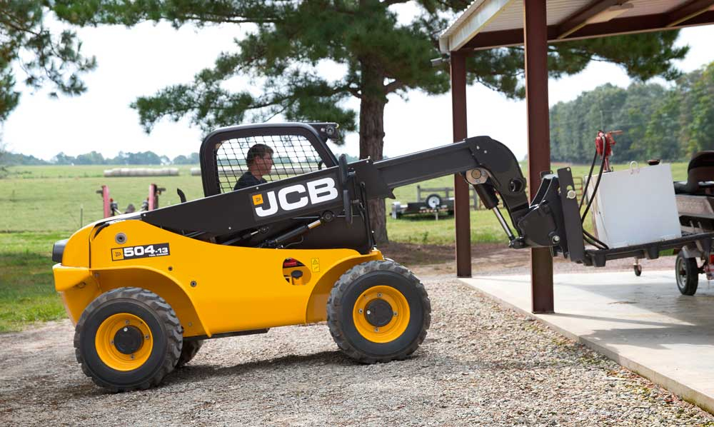

I’m considering buying a JCB teleskid. I could benefit from the increased reach but not enough to justify a telhandler and the side entry would be nice.

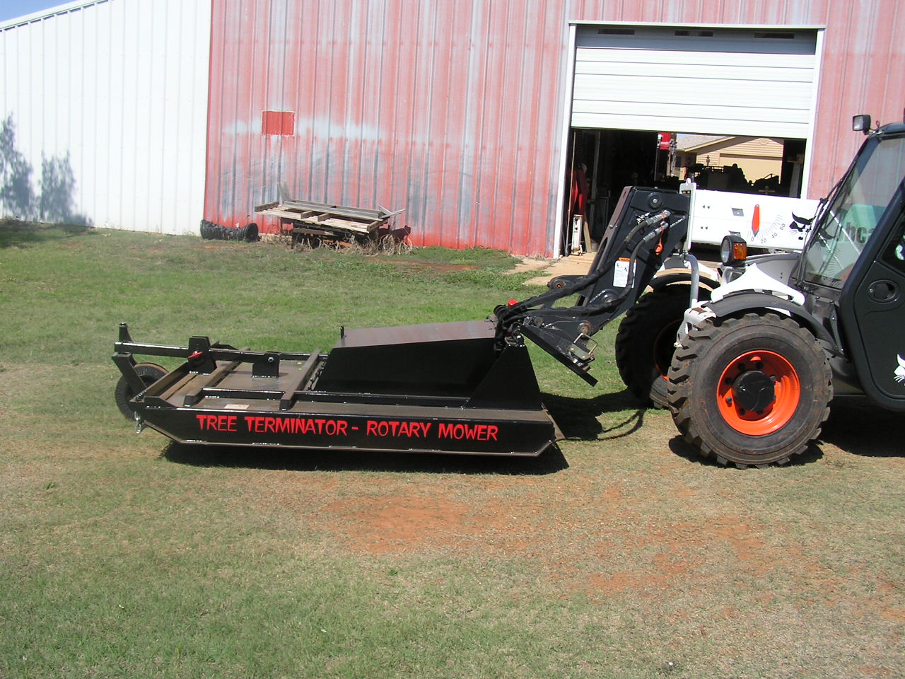

The tractor bush hogs a pasture better, but that's about it.

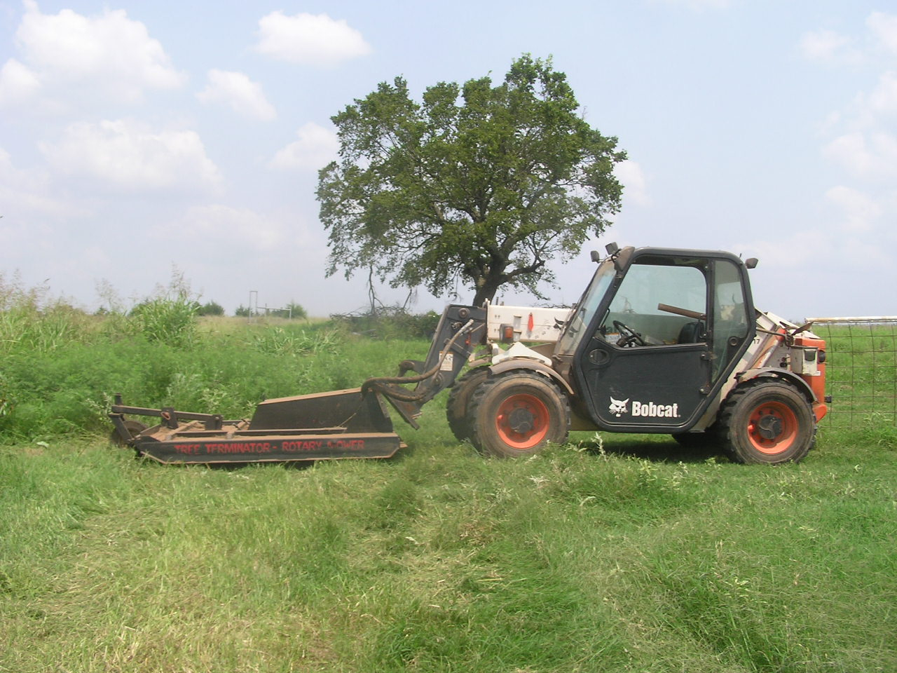

My 7' front brush hog is better than the tractor and rear brush hog that I sold when I got the compact telehandler:
/ Tractor vs Skid Steer Loader Specs #53
View attachment 781074View attachment 781075
Yeah but he's talking skid steer for logs. That thing you got won't stay up in the woods. Too heavy and small tires. We use one of those doing metal buildings with a basket on front. I'll bet you I can clear an acre of jungle with a skid steer with a bush hog faster than you can. Flip that high flow on and get after it. I'm sure yours is good for your use. But, if he's fooling with logs, tracked skid steer is better.

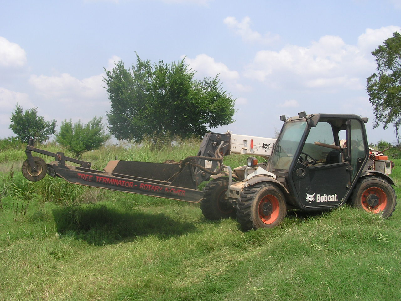

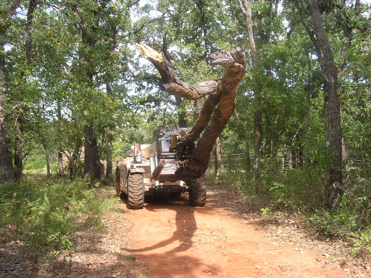

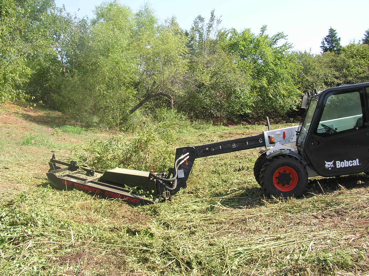

The tires are bigger than normal skid steer tires:
I don't do logs, but it handles dead trees that look like logs just fine in the woods:
And this little tree:

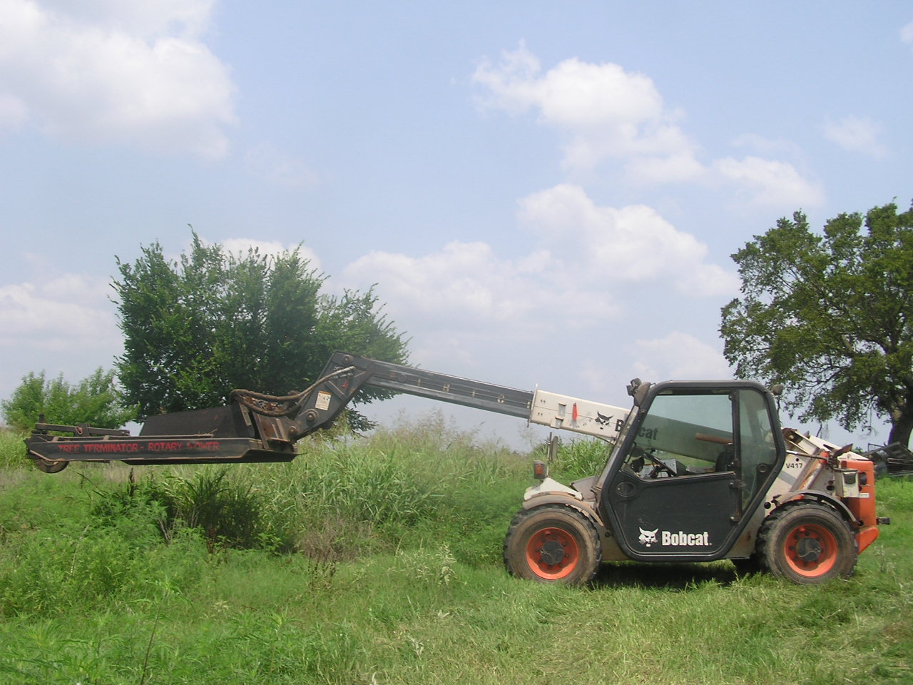

A compact telehandler or a full-size?
Possibly, but not likely. Why would a skid steer be faster?

The JCB is still a bit of a toy.
