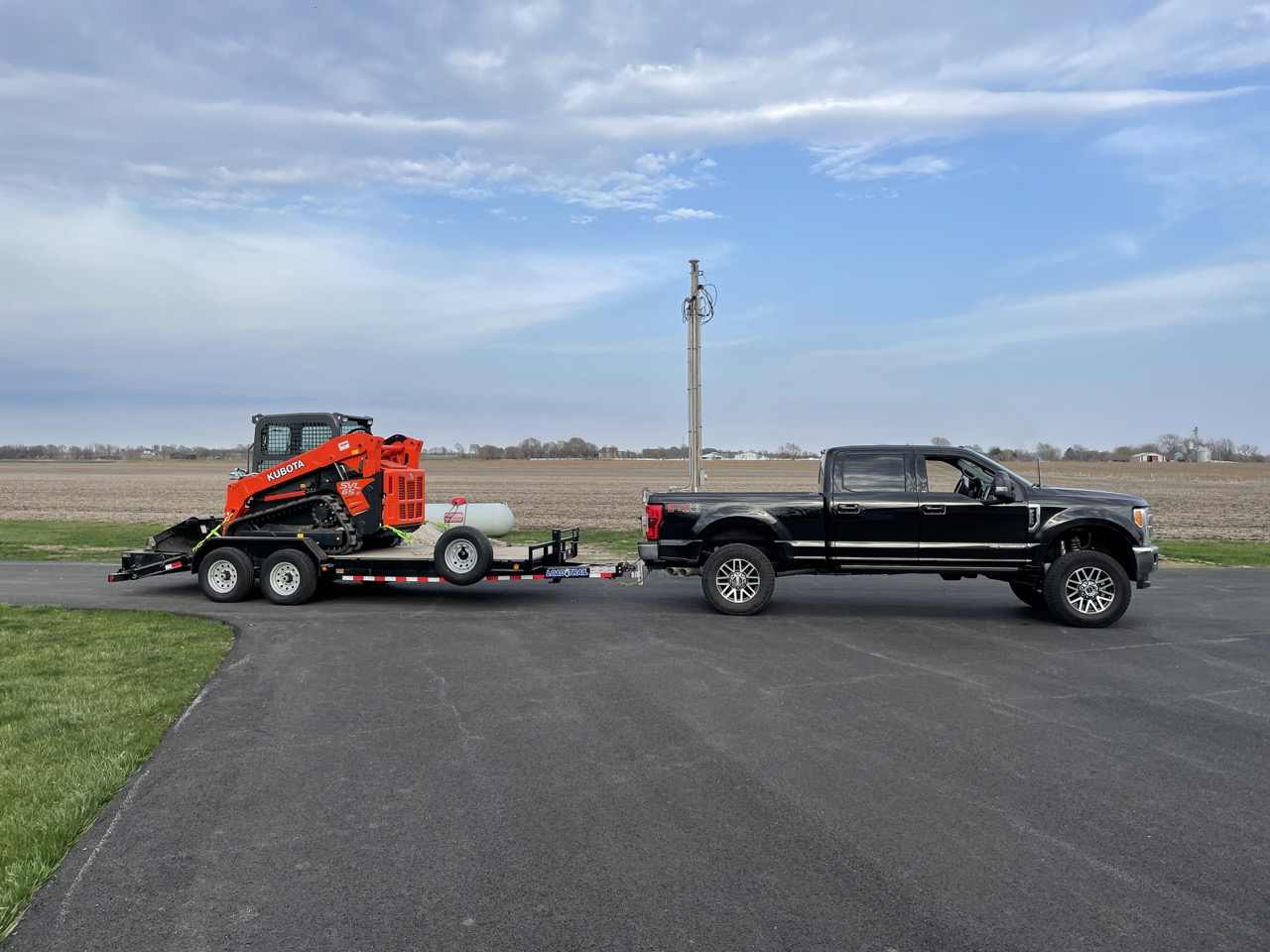

/ Tractor vs Skid Steer Loader Specs #93
The original poster stated a 7500lb weight limit on his trailer. That basically limits you to a smaller wheeled skid or tractor. Not positive but pretty sure l47 or svl75 would put you over that weight once actually loaded with a bucket. If a trailer upgrade was needed would that also mean a bigger truck? In my opinion track loaders are meant to get in and get to work, not the easiest to be in and out of. I think some of those newer compact articulated wheel loaders would be worth looking into. A lot of tree guys in my area use them when handling logs.
A 75 weighs about 10k pounds and a 65 is still exceeding 7500 pounds. I think Takeuchi makes a smaller tracked machine in that weight class.
#96
Yes, both truck and trailer are limited to 10k which means smaller CTL like a Bobcat T450 or T180. L47 would be the max for a TLB. Lots of reasonably priced 10k pound skid steers but buying a new truck and trailer isn’t in my budget.
