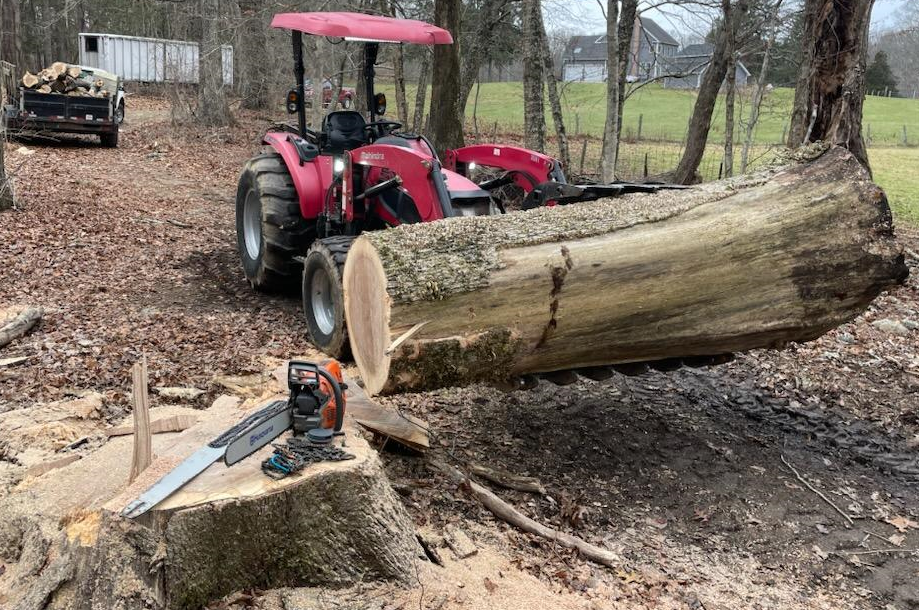

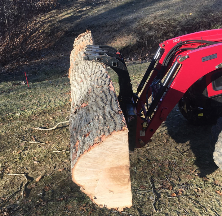

Recently sold some logs and one blown downed walnut tree by creek to a local saw Miller. He uses a steel track over wheels skidsteer at his mill. He is also professional forest hotshot firefighter qualified on many machines.
The walnut 30” tree was high hazard because of the terrain. He was impressed how easy the M59 preformed the work and moves that would have been hard for a skidsteer. Backhoe often swing uphill for balance. Transported logs 1/2 mile to load his trailer. Easily carried him, saws and equipment to/from tree.
Move a lot of brush and trees on my hillside. Being able to grapple a load, get off and trim with chainsaw not really safe with skidsteer. Road and landscape damage lot less. Now with soft ride FEL, time in the saddle kinder on worn bodies.
Never a perfect machine for all but the M59 makes a good dance partner on the farm.

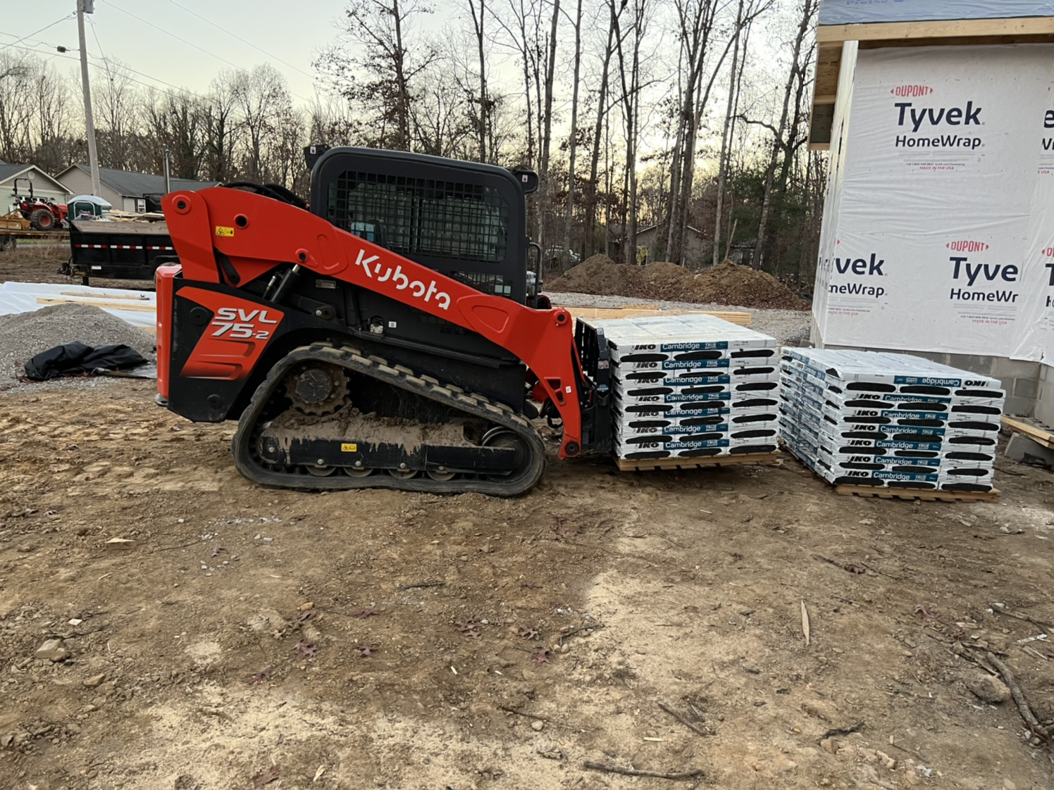

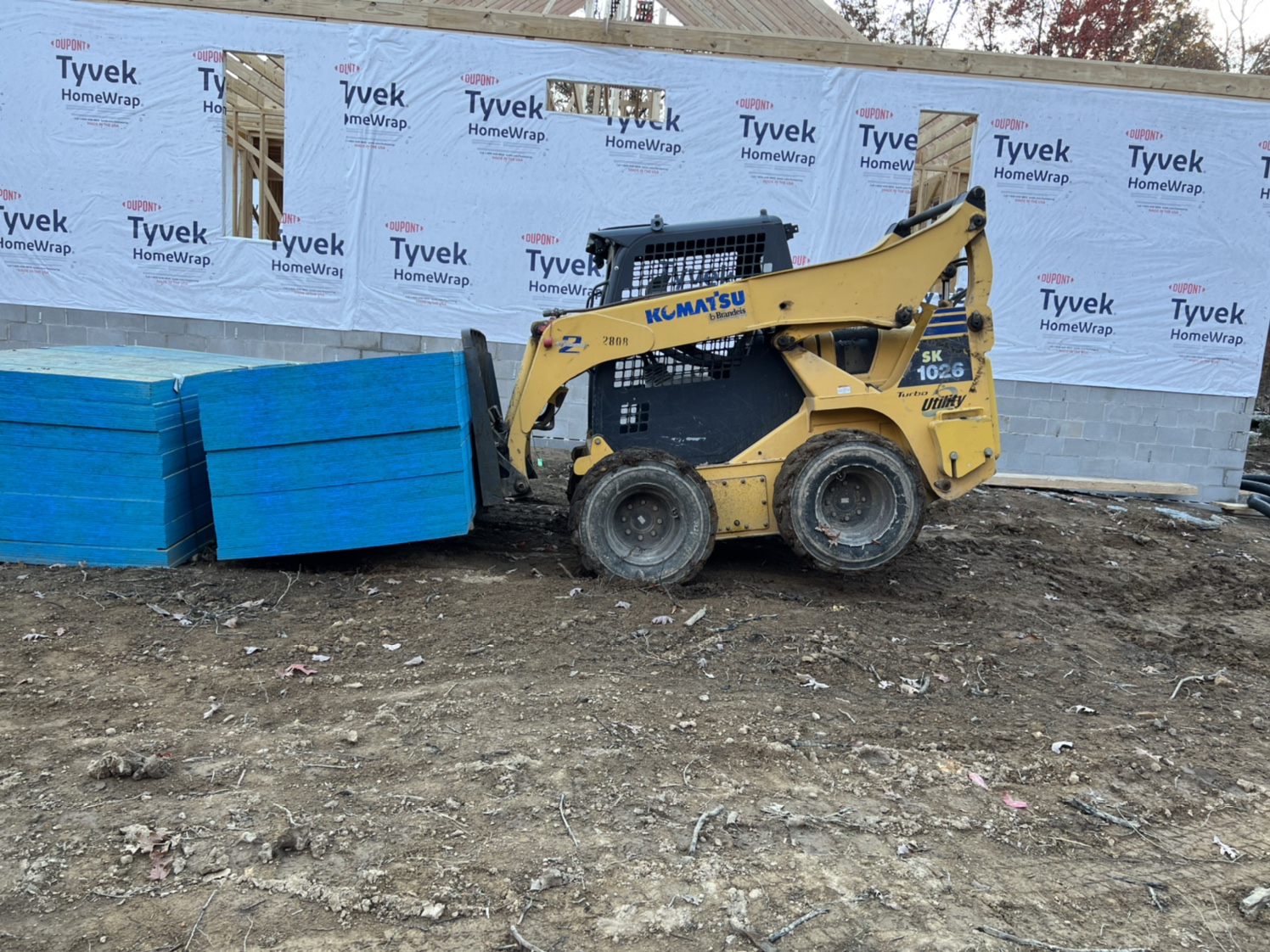

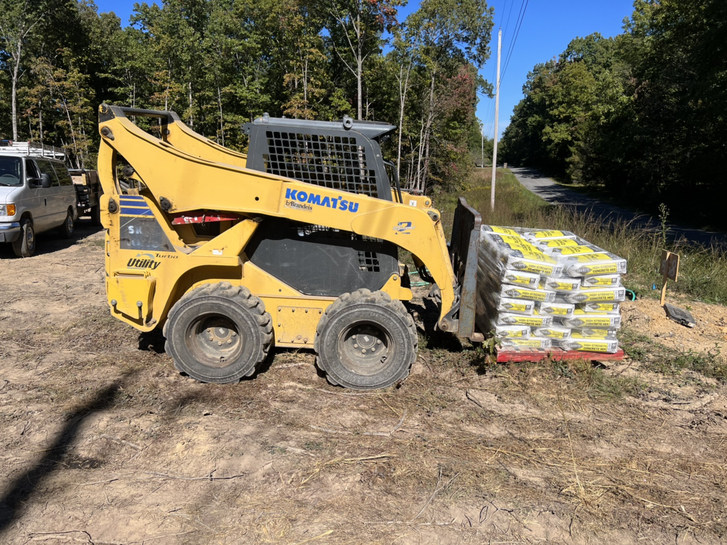

I don’t think you can compare by specs alone. When I added a CTL to my fleet, I found it go to in place of my compact tractor for much of the utility work I do around my farm, so I replaced the compact tractor with a 105 HP utility tractor. CTL has no PTO, no 3 point so it couldn’t be a complete replacement. My M7-171 can run things like my roto-tiller but is complete overkill.
