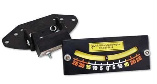

Go to the TBN store and buy a tilt meter. I put one on the 3510 to keep the Backhoe level and it also has saved my rear a couple of times as well. Best $40 I have spent since buying a Lock-n-Lube!
