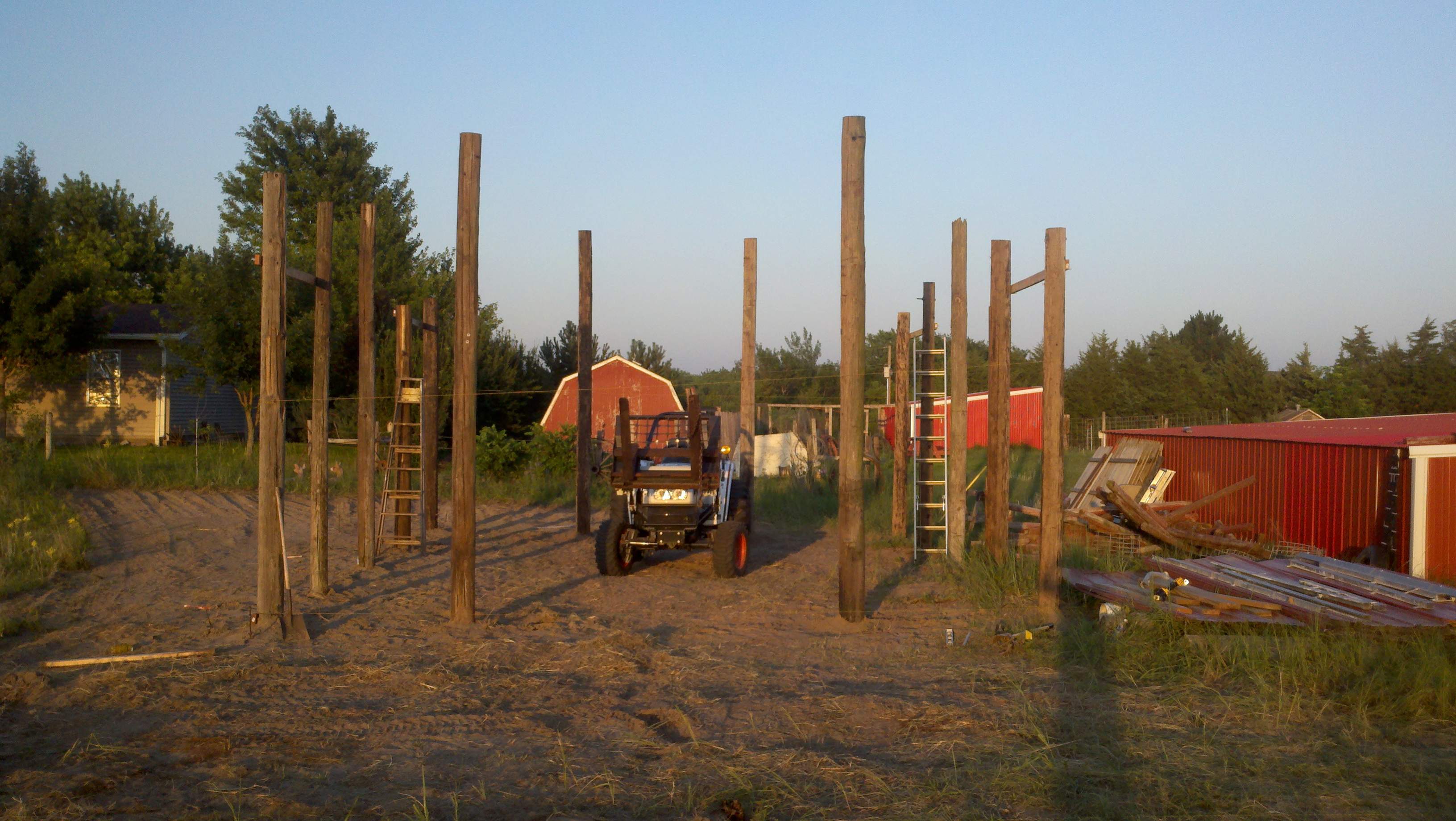

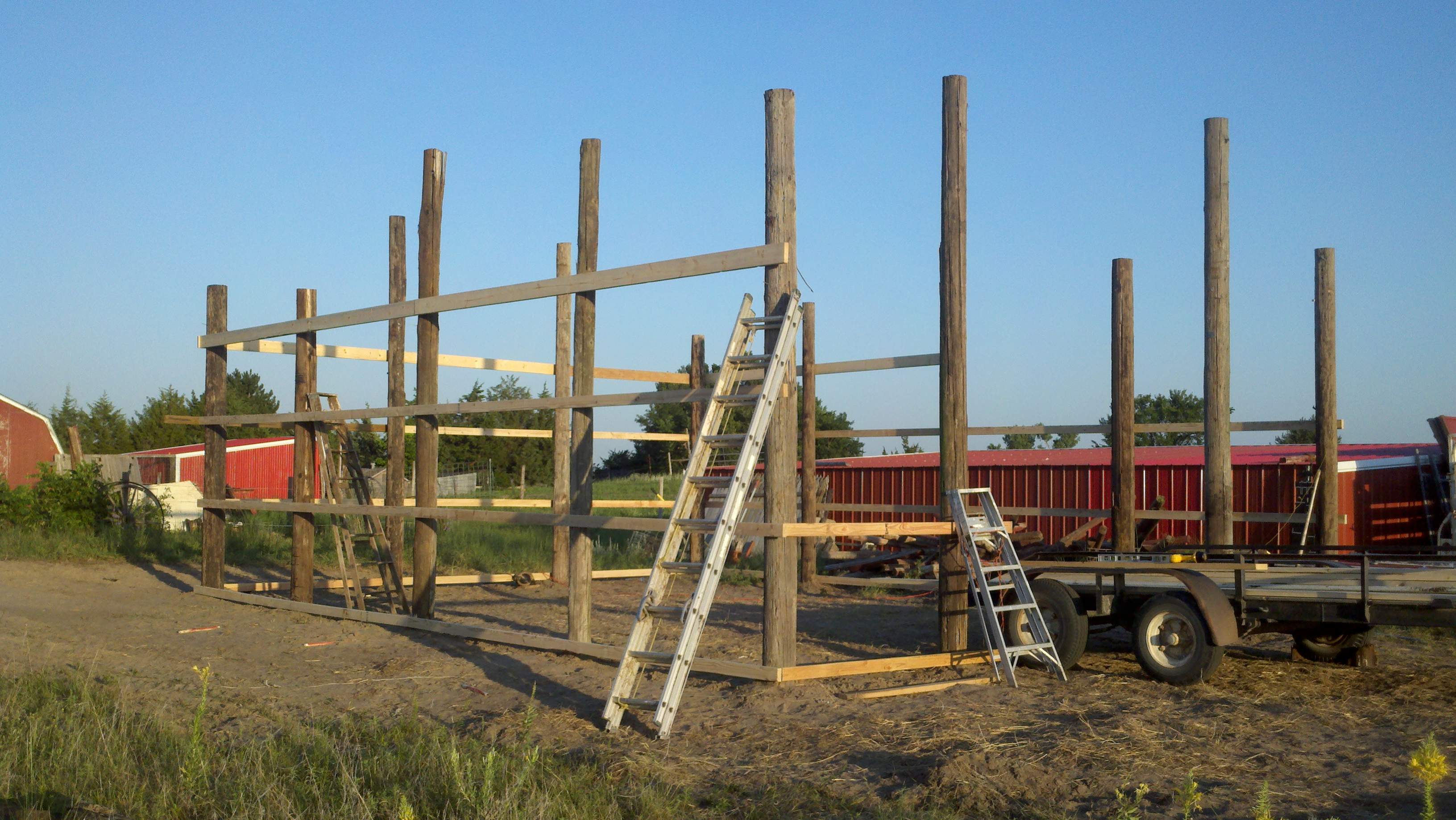

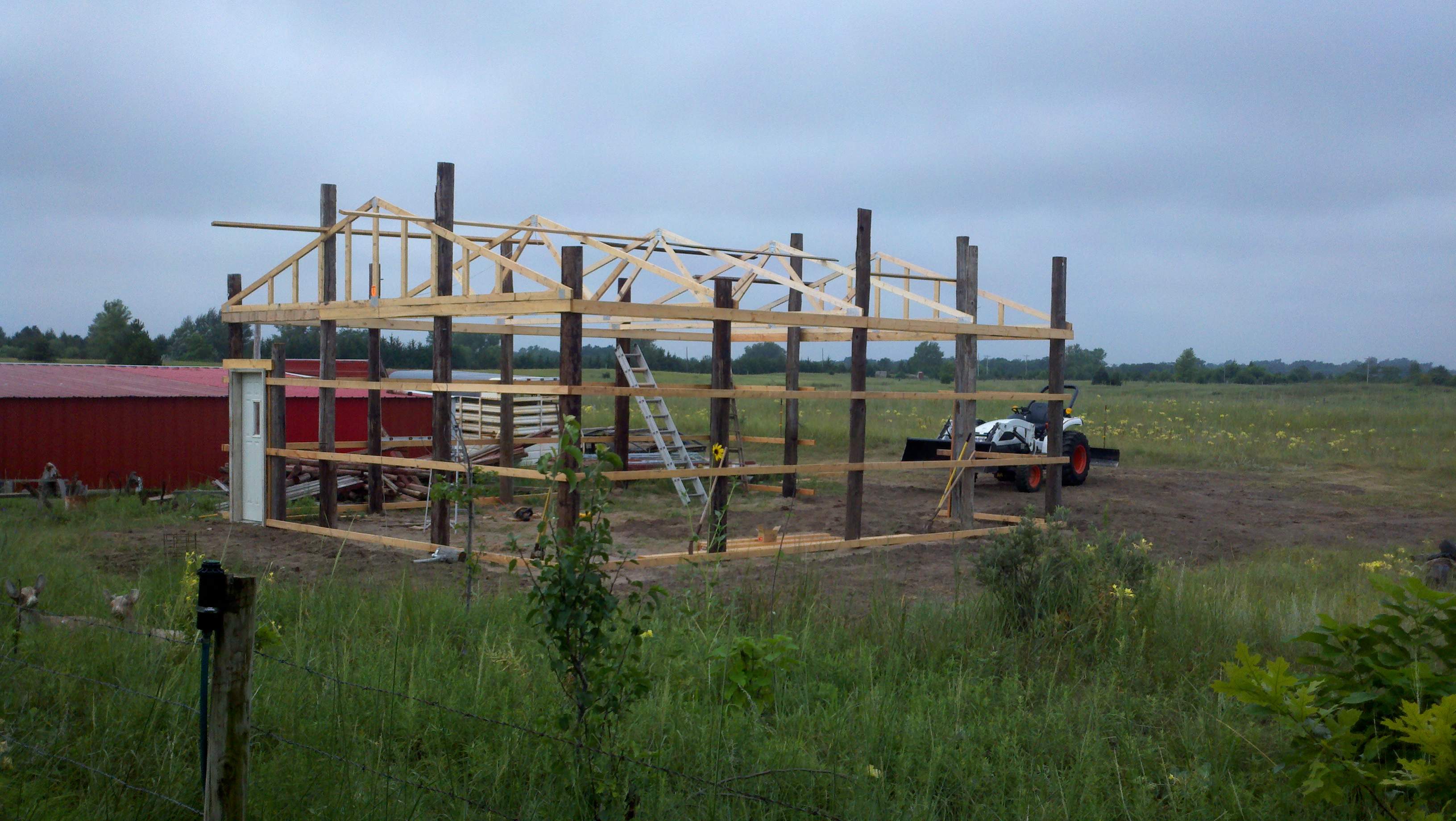

I set the poles 4 ft in the ground. I did think about notching poles I also thought about bolting a 2 x6 to the side of pole to set trusses on then bolting trusses to pole. I am still thinking about all that because i used telephone poles they are differant sizes at the top might not be real easy to keep straight. I left the poles long so after i figure out my height and cut them off might make it easyer to decide. any and all advise is welcome. Thanks Vince

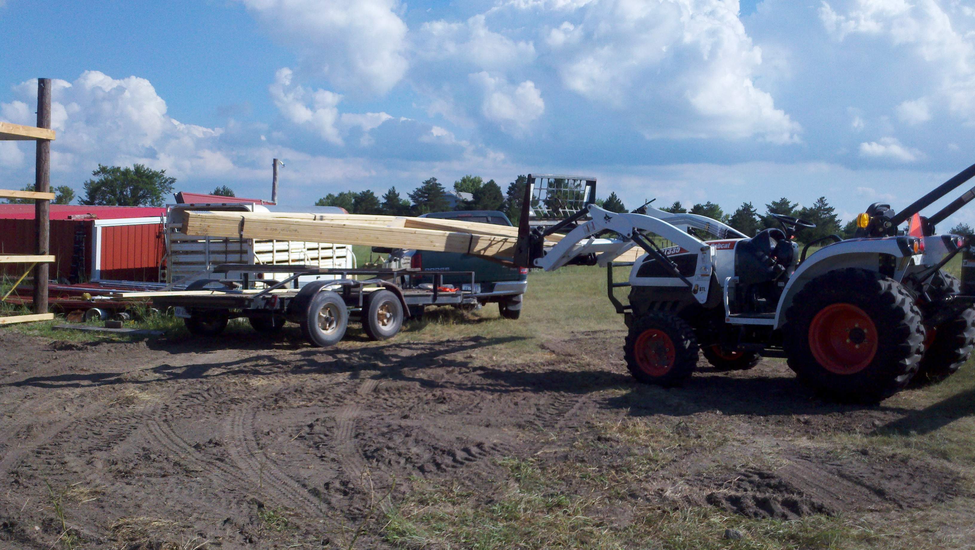

My Rafters showed up today. Will start in trhe morning putting them up. My forks saved the day agian.

Rafters went up this morning.

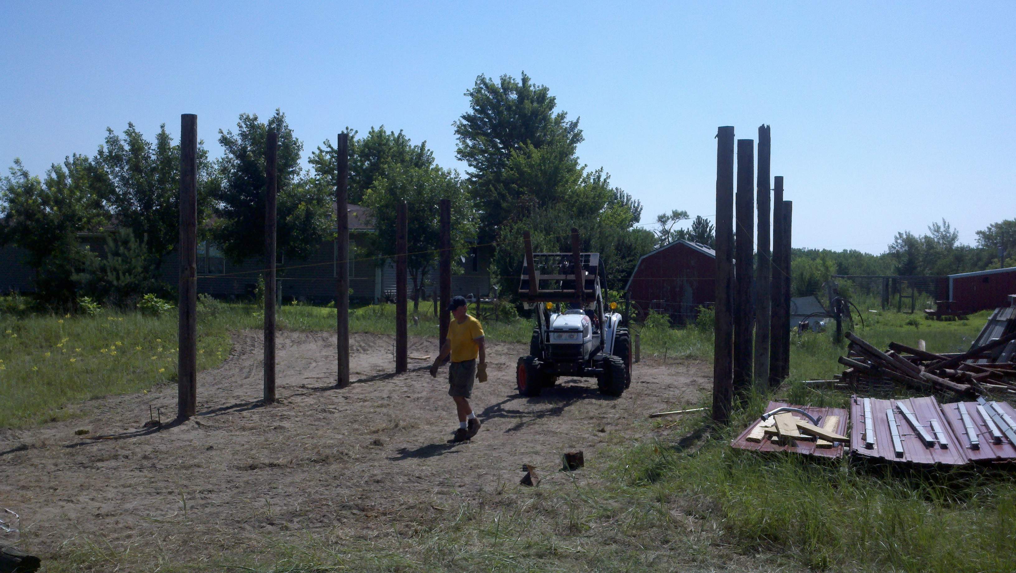

Thanks i am trying been hot here. Cut poles down to size and started cross stringers on rafters lot of trips up and down a ladder by your self. I had a helper he laid on the lounge chair in the sun all day watching me would only leave when i did I was hoping he would call 911 if i fell lol.

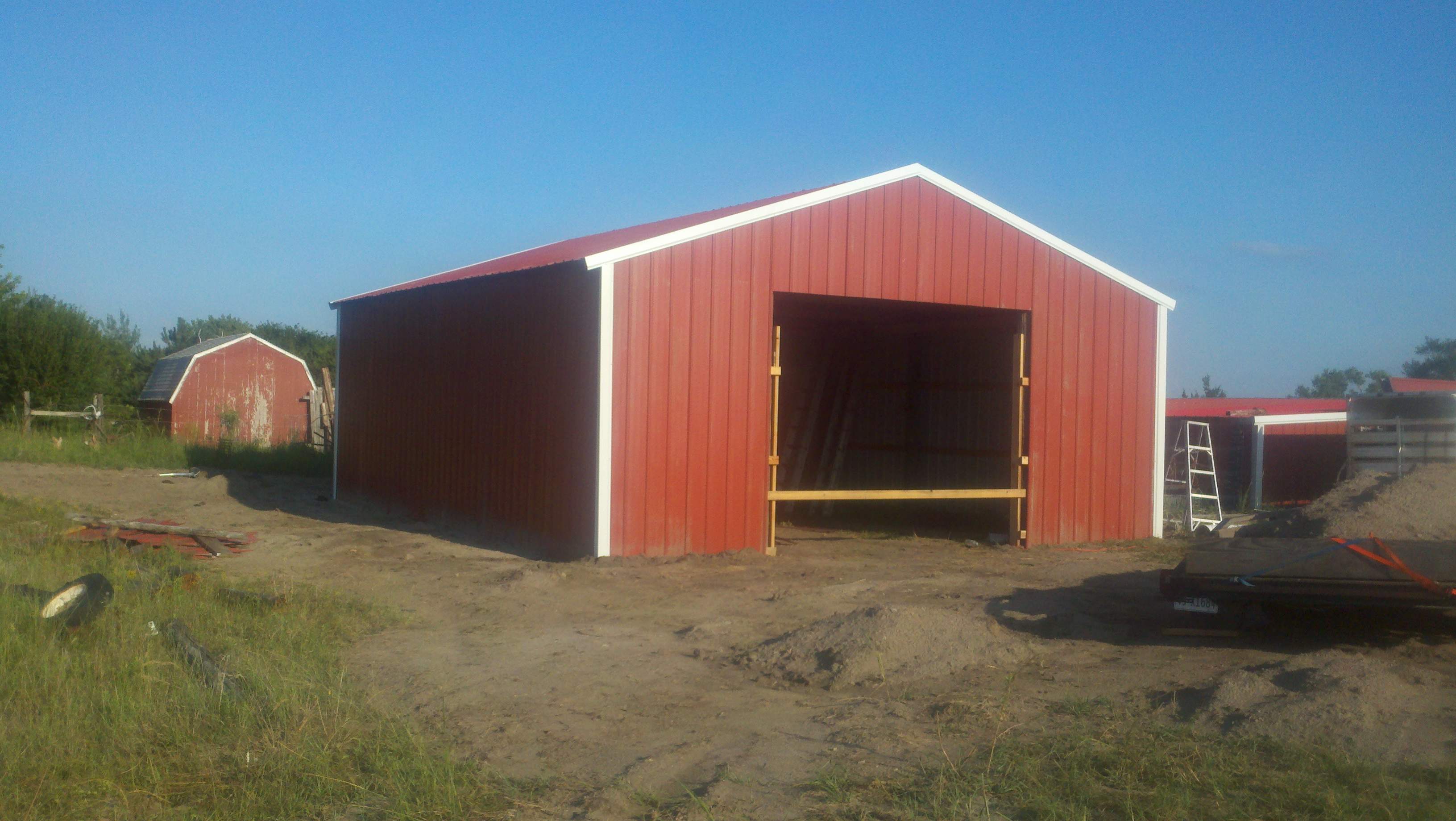

Thank you Keegs been alot of work but i am very happy with it here is a pic with most of the trim on still have to finish my door.

Hi guys finally got my doors up. Now I am waiting on the trim for my doors it is back ordered. 2 6ft by 10 sliding doors.
/ Tractor shed
#34
Well doors are up. My tractor shed is now perty much done, outside at least still have to wire it and but up lights.

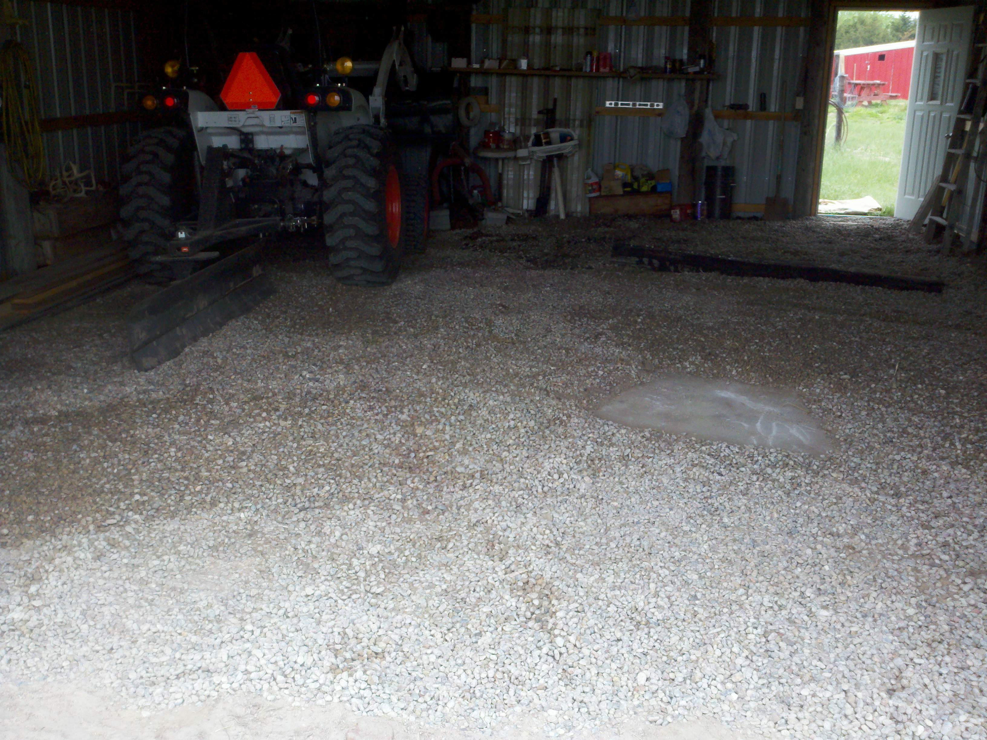

Well put down gravel in my tractor shed was going to use white rock but was to hard to get and lot more money. I am very happy with the gravel as i am not rolling around on the floor any how. I just park my tractor and my boat in the shed i did put down a concret pad for my front boat wheel to sit on makes hooking up boat much easyer.

I imagine that given time that gravel will pack down and make a very nice floor for storing your tractor and boat.
/ Tractor shed #37
I've know a few guys that would spread some bags of concrete with that and it would kind of set. Don't know that I would try it with as much gravel as it looks like you have.
