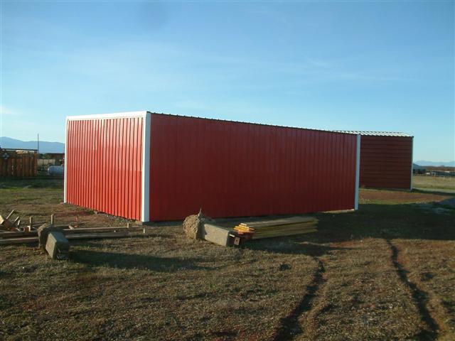

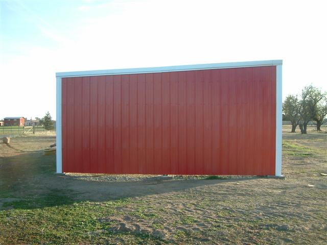

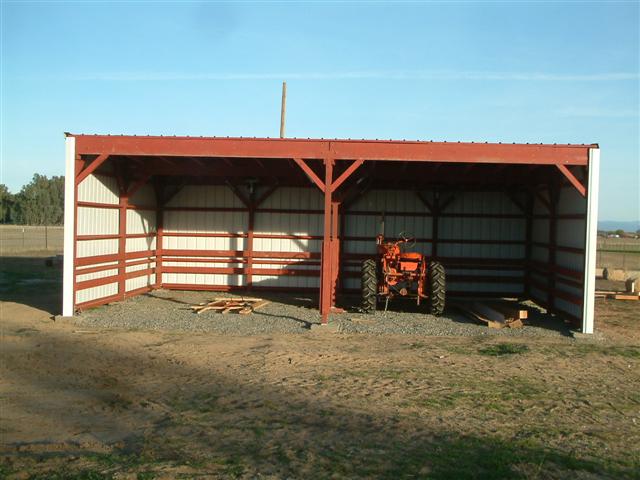

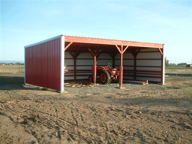

Here's my tractor shed:
DSCF0090 (Small).JPGDSCF0091 (Small).JPGDSCF0094 (Small).JPGDSCF0098 (Small).JPG
20x28 ft
10 ft high in front sloping to 9 ft in rear
4x6 pressure treated posts in Simpson bases
Doubled 2x12 main beams
4x4 knee braces (lotsa them)
2x6 roof joists
2x4 girts and purlins
28 ga R-panel metal roof and sides
Gravel floor
I would level the site and spend a lot of time making sure the main
posts are located accurately and are vertical in both directions.
Good luck

Nice looking building flusher. I am looking more at building a inclosed with a door and pitch roof. I like the rock on your floor that is what i plan to put down once i am all done.

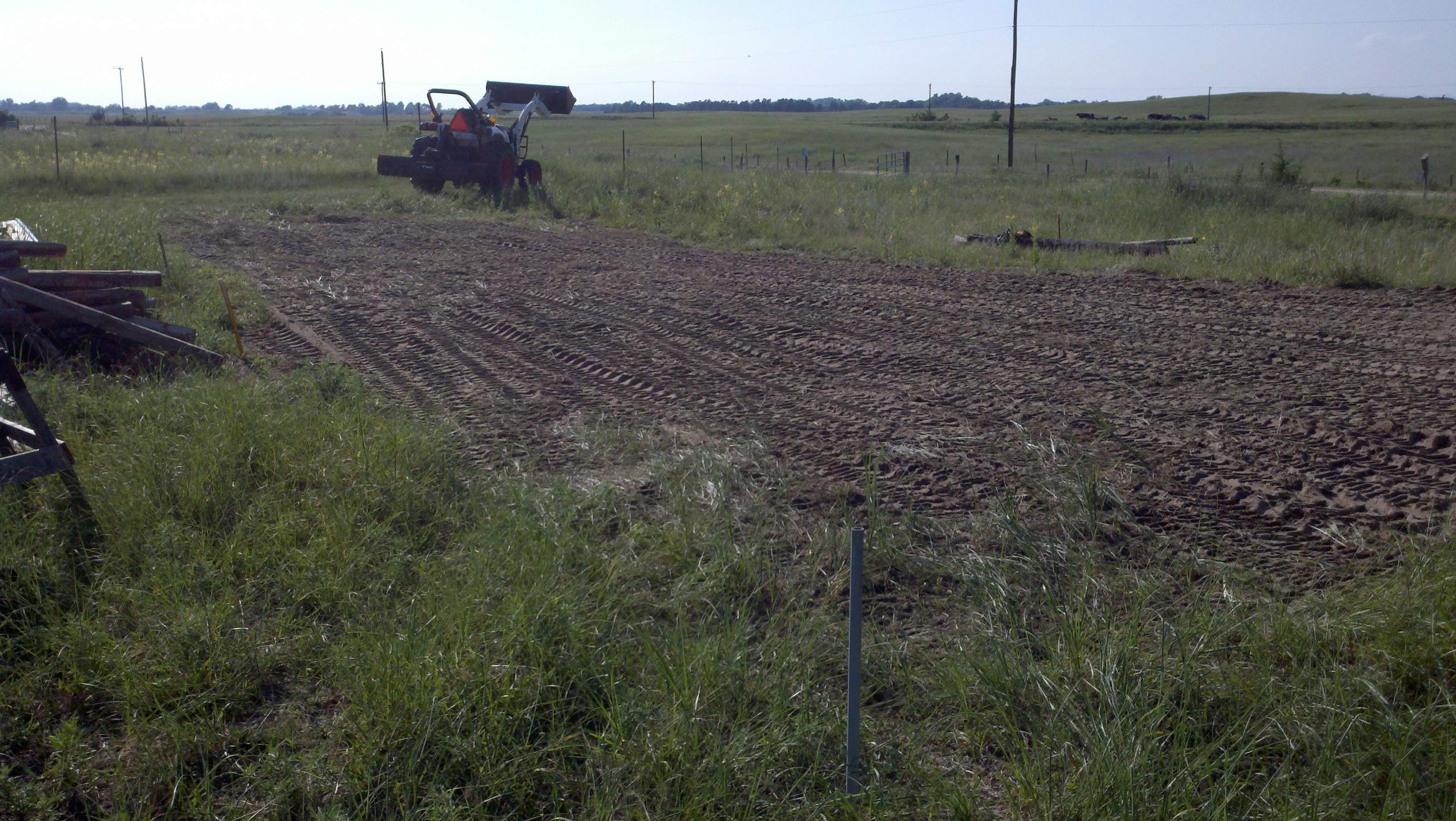

started the ground work tonite for my building site. Have alittle more leveling to do but its coming around nice i thought. I will post pic's as i build this going tobe slow i dont have alot of time to work on it so bare with me.
