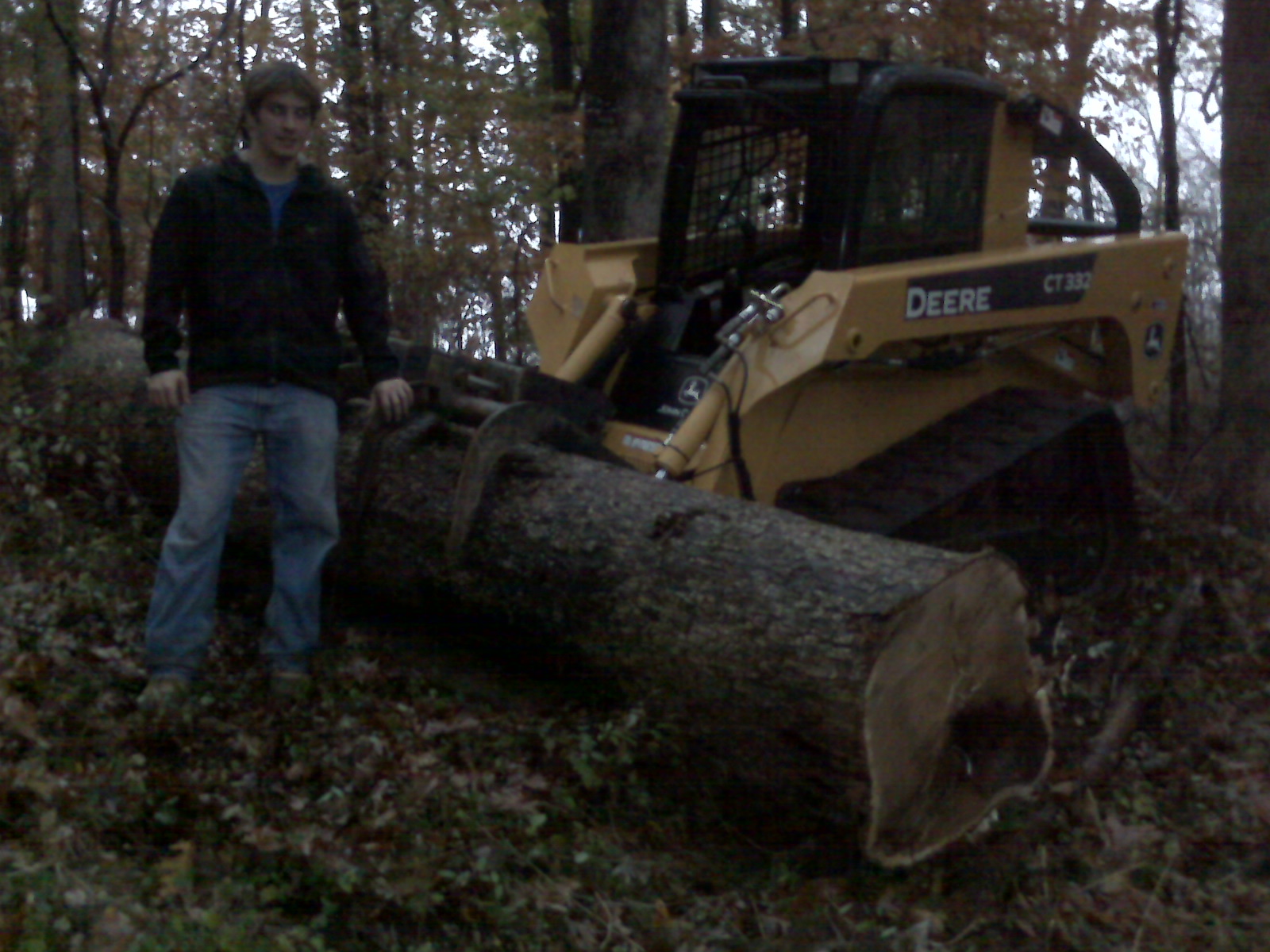

I believe you are getting some poor information here. Bobcat skidsteers are certainly somewhat unstable on slopes, however, that's not to say that all skidsteers have the same problem. Look at what John Deere has to offer. I have owned a Bobcat 763 (flipped twice), a Cat 257 (flipped twice), and a John Deere CT332 (most stable machine I have ever operated). If you look at Deere skidsteers you will notice how low the center of gravity is and how heavy the machines are. Obviously, the Cat and Deere machines I have owned are larger tracked machines, however, the skidsteer machines without tracks are still clearly highquality. You can also get rubber tracks that fit over the wheels and are supposed to be pretty high quality. As for speed, my tracked CT332 will go around 7-8 mph, not 5mph. A wheeled Deere loader can do around 10-12 mph if you get the 2 speed option. There are very few situations in which I have found I needed more speed for my Deere so I am certain that a wheeled machine will be plenty fast.
Lifting capacity of skid steers is simply much more than comparable tractors. My Deere will easily lift 2 tons whereas my New Holland TN75 will have the rear wheels high in the air even with a heavy rear implement if used to life 2 tons.
The Skid Steers are designed to be used to dig and do loader bucket work. Tractors are designed to do some loader bucket work and a whole assortment of other jobs. If you need to do a lot of 3point hitch work, get a tractor, but if you want to do loader work, a skid steer is absolutely the better option and will be far more stable on slopes provided you purchase the right one.
The below picture is not particularly good. However, the Deere can grab the end of that log with the grapple and lift it all the way to the maximum heigh on level ground without tipping. This is a log that probably weighs around 4-5k pounds.

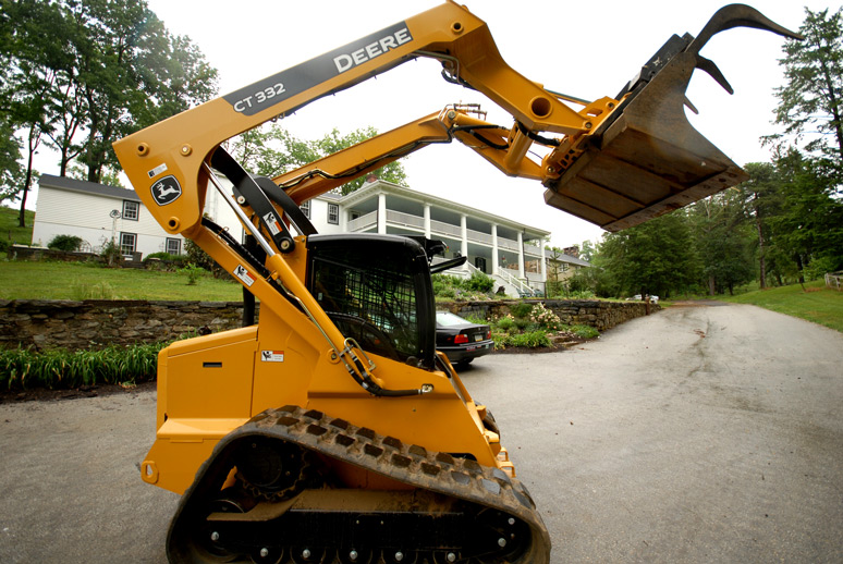

Take a look at this picture too. Notice how much of the machine's weight is low down. Also, you can very safely keep the loader arms up like in the picture because there is a boom rest which you can activate from inside the cab.
