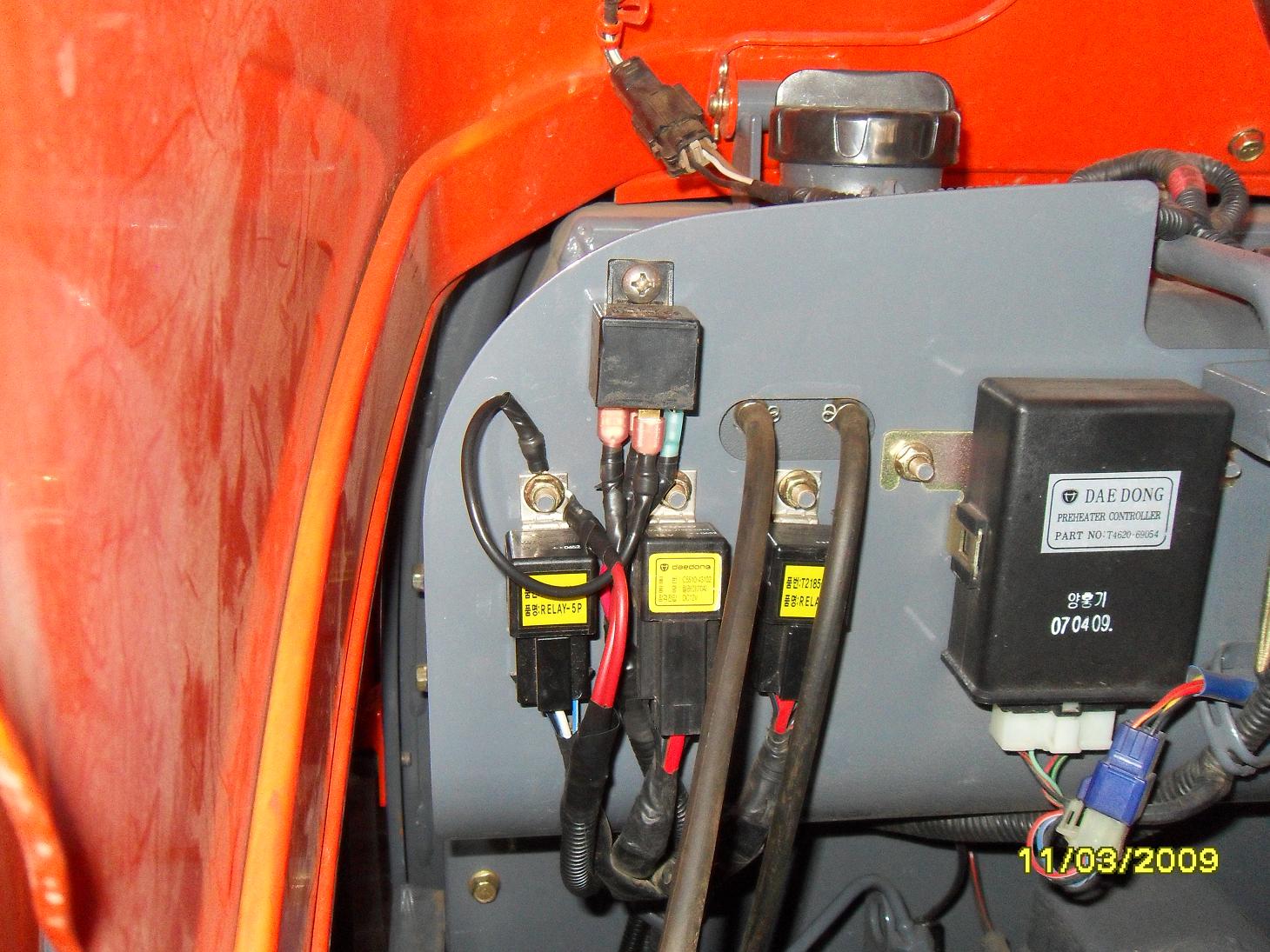

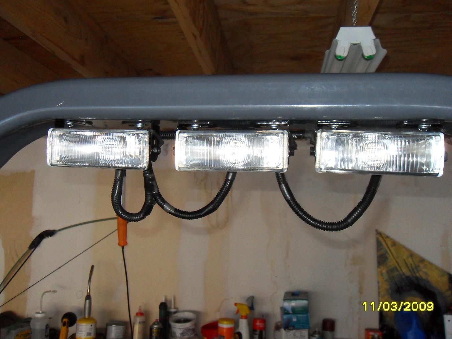

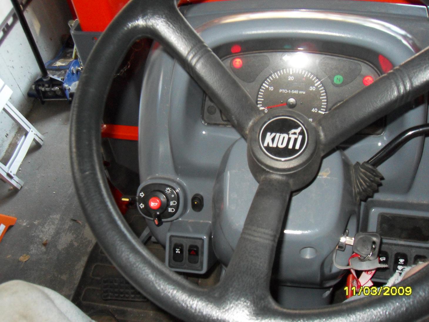

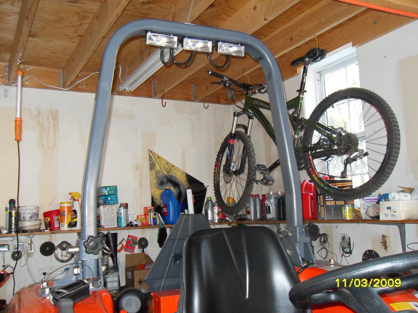

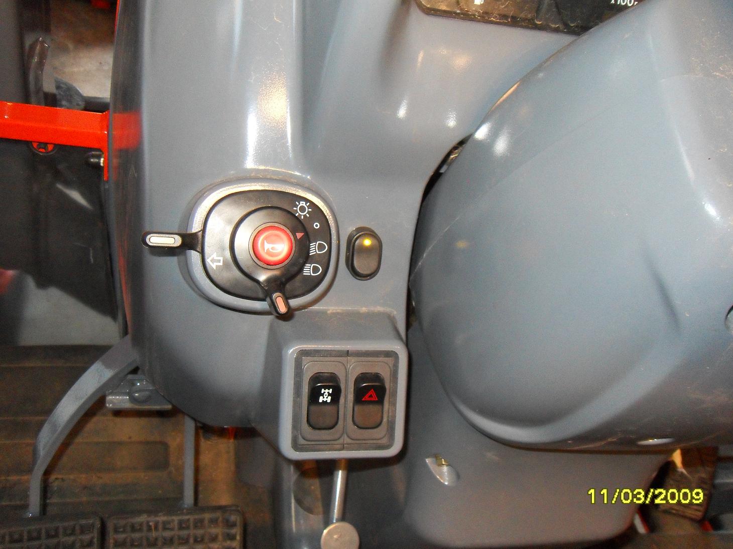

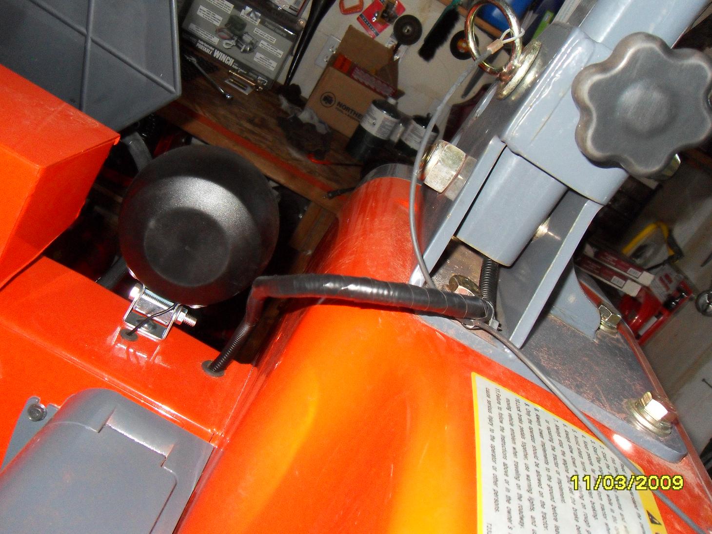

Hey Guys,
I put some lights on my ROPS. I got them from Northerntool.com (link below). they work great. I put three on the ROPS, and I'm going to put one on each side by my clearance lights in front of the pedals. The lighs are about $12.00 for two of them, and the three I have throw plenty of light out front to work in dark, snowy weather.
Northern Industrial Mini Wide Beam Sportlight Kit 12 Volt | Work Lights | Northern Tool + Equipment
Now how I mounted them may get a groan from many of you.. I just drilled and taped some 3/16" holes and screwed them into the ROPS.
Carry on,
Phill

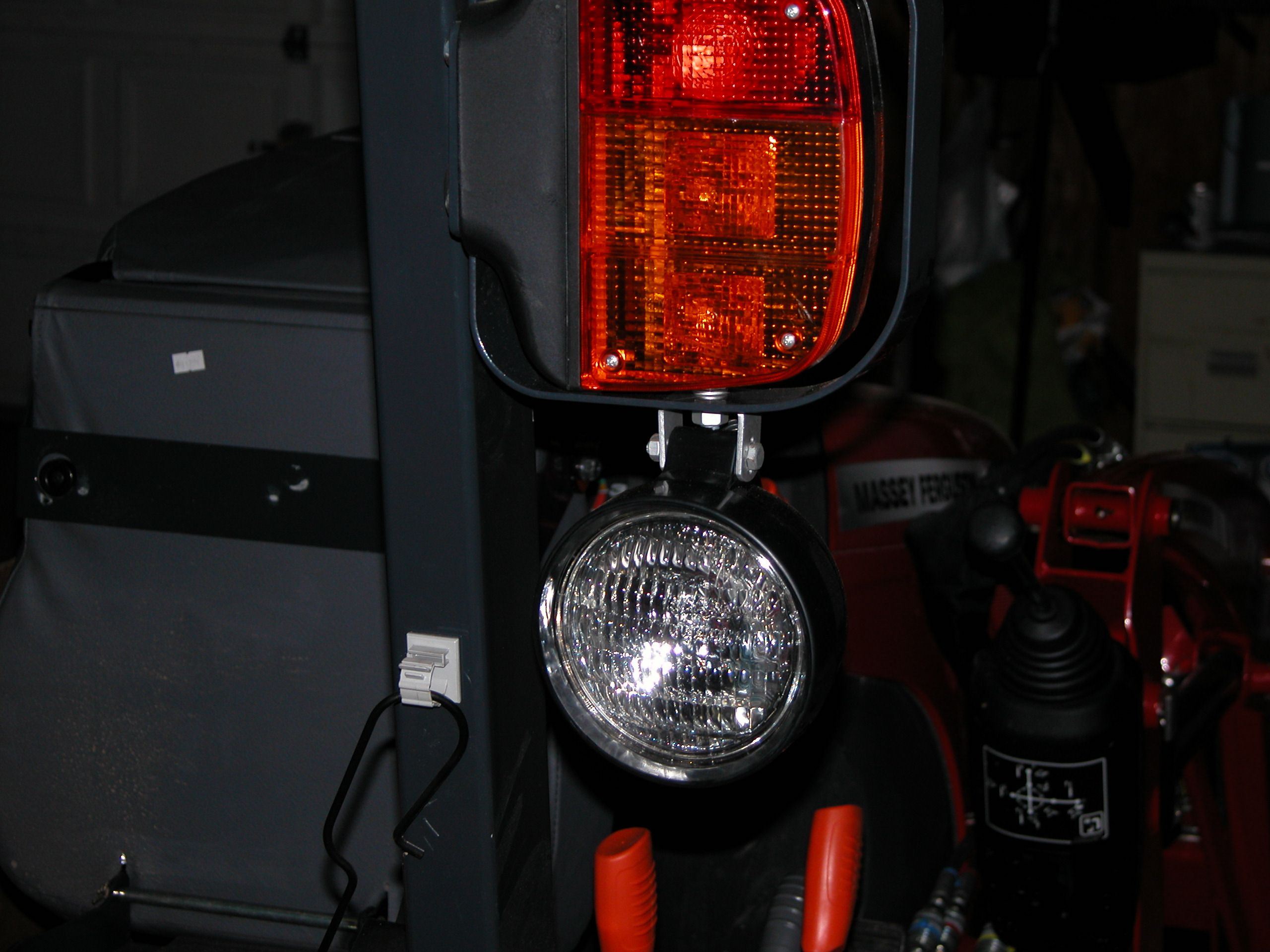

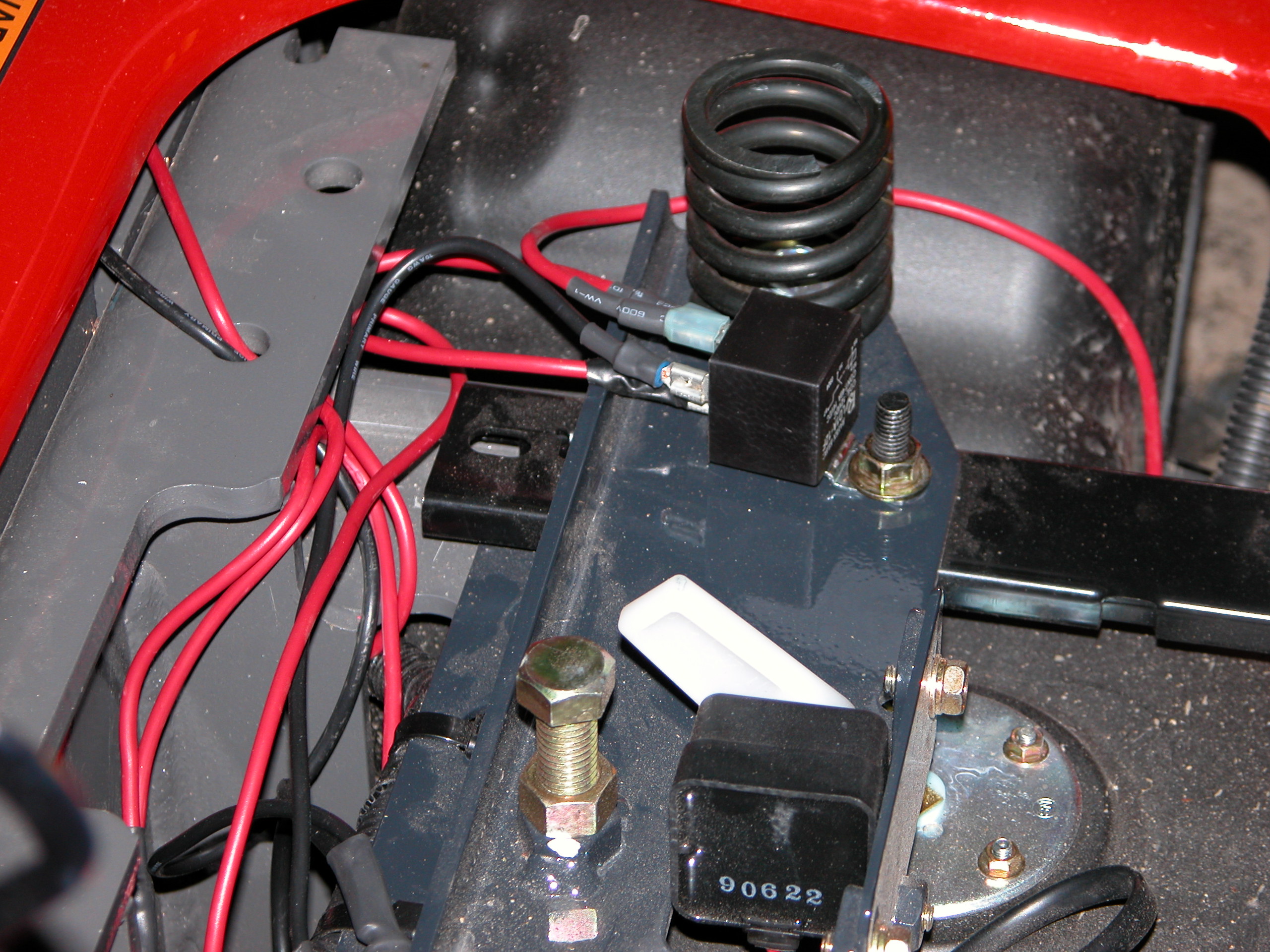

Mcourchesne, I happen to have the same tractor that you have and have just added lights so that I can see while I am snow blowing this year. What I did was mount the lights to the rings that surround the blinkers and ran the wires down the same way that the factory did though the ROPS. Then under the seat there is enough room for a relay where its fairly protected from the weather. I ran a fused power wire along the factory wire harness up and under the seat. To turn the lights on I ran a wire from the aux power connection that is to the left of the upper link. To turn the lights on flip the switch to the run position and they light up.
AWESOME, Thanks Blizzard0308! That is exactly how I wanted to mount the lighting. I was unsure in choosing the top or bottom of that protective steel ring and thought on top my provide a slightly higher trajectory point out/down onto the ground. It looks like you purchased the same wiring harness I was considering. I don't quite unsderstand how you switch on/off the lights though? Where to you get your lights? Are you happy with them?

I got the lights from TSC they are $11 a piece for the 35 watt bulbs and I also got the harness there too. I am very happy with the lights though I still may want to upgrade to the 55 watt bulbs later and use the 35 watt bulbs for the front to augment the lighting that is already there.
The lights are handled by the ignition switch because I tapped into the aux power wire to be my 12v "Switch" wire for the relay. When the ignition switch is in the run position the aux power wire is live with power. It took me a min to find the aux power wire because it was covered up with electrical tape but if you are looking at the rear of your tractor just to the left of the center link there is part of the main wiring harness. If you look closely there is a small "bullet" connector taped to the outside of the harness. This is what I tied into to use as my Switch. I wish I could get better picture of that area but they all come out very dark.

Thanks for the info on switching the lights on. Question is how do you switch them off? :eek:
Did you just grab the aux feed from there and supply the relay...then install a small rocker type switch to control the lights?
