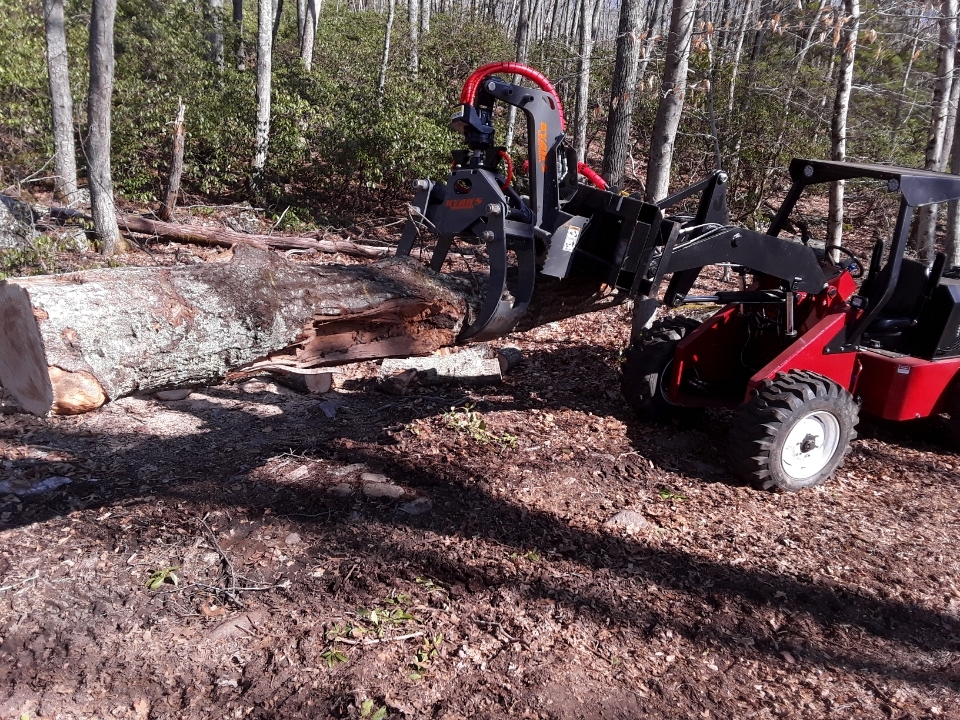

Just wondering, but why would you want a very complicated and expensive to repair Antonio Carraro over a US Built, component part, Power Trac that doesn't use a difficult to connect 3pt hitch and can lift all the attachments up higher then the AC which is nice when using lift forks, lift boom, front hoe, brush grapples, tree pullers and cutters, or even the rotary cutter to cut brush back that tends to invade along all the edges of fields growing to the light? The Carraro can't do any of this without buying a loader and then it is just like a standard tractor trying to look over a long hood.

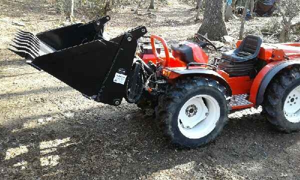

This is the loader I would get if I needed one. These tractors weren't really built with a loader in mind, like was mentioned already. There are loaders that mount on the front but I wouldn't want one of those. I really don't see how their hoods are that much longer or harder to see over than American tractors. But more to the point, OP mentioned mowing and neck strain related to that which is why I suggested this machine. If he had said he needed something for loader work, I wouldn't have recommended it

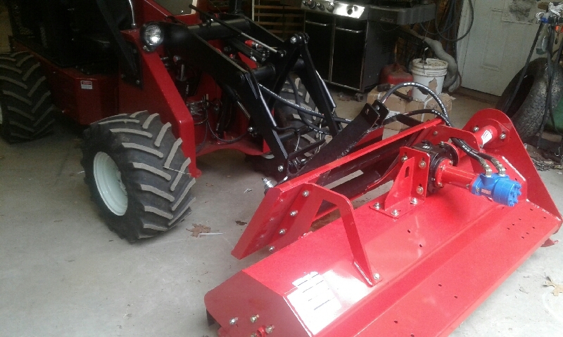

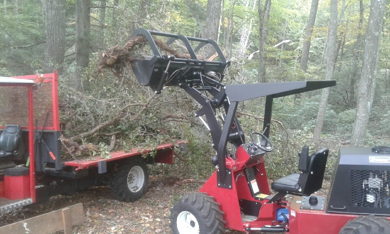

It is NOT a loader. CAT coined the term "Tool Carrier". The PT is just a better designed machine. The implement, in this case a mower deck is right out in front of you where you can see and because of articulation, can even move sideways just by turning the steering wheel. If all you want is a mower, then that is what it is...just pick the type: brush, finish or boom or all of the above. The VERSATILITY allows you to use as a loader too, but again, it is not a loader. AND it is much easier then a 3pt hitch to connect, all can be done without leaving the operators seat except for connecting hydraulic hoses when applicable. Forget about struggling with a large PTO shaft between the lift arms!

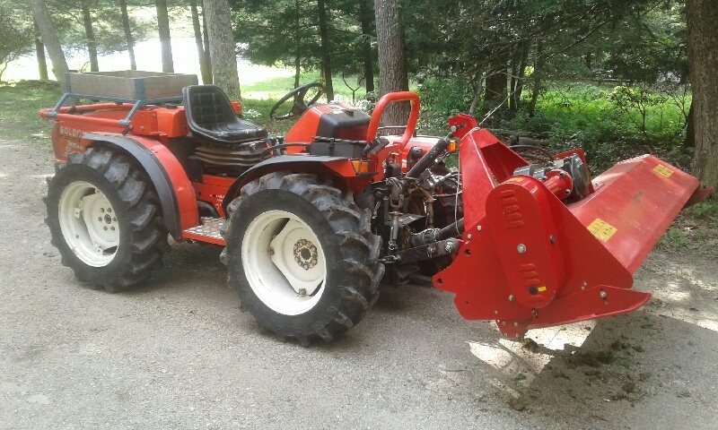

I owned a Goldoni which is just like the A Carraro and they don't hold a light to the Power Trac in versatility. The the cost to buy these tractors, why not have one that can do a lot more work easier. I have attached 2 pics of my Goldoni and 2 of my PT similarly equipped.

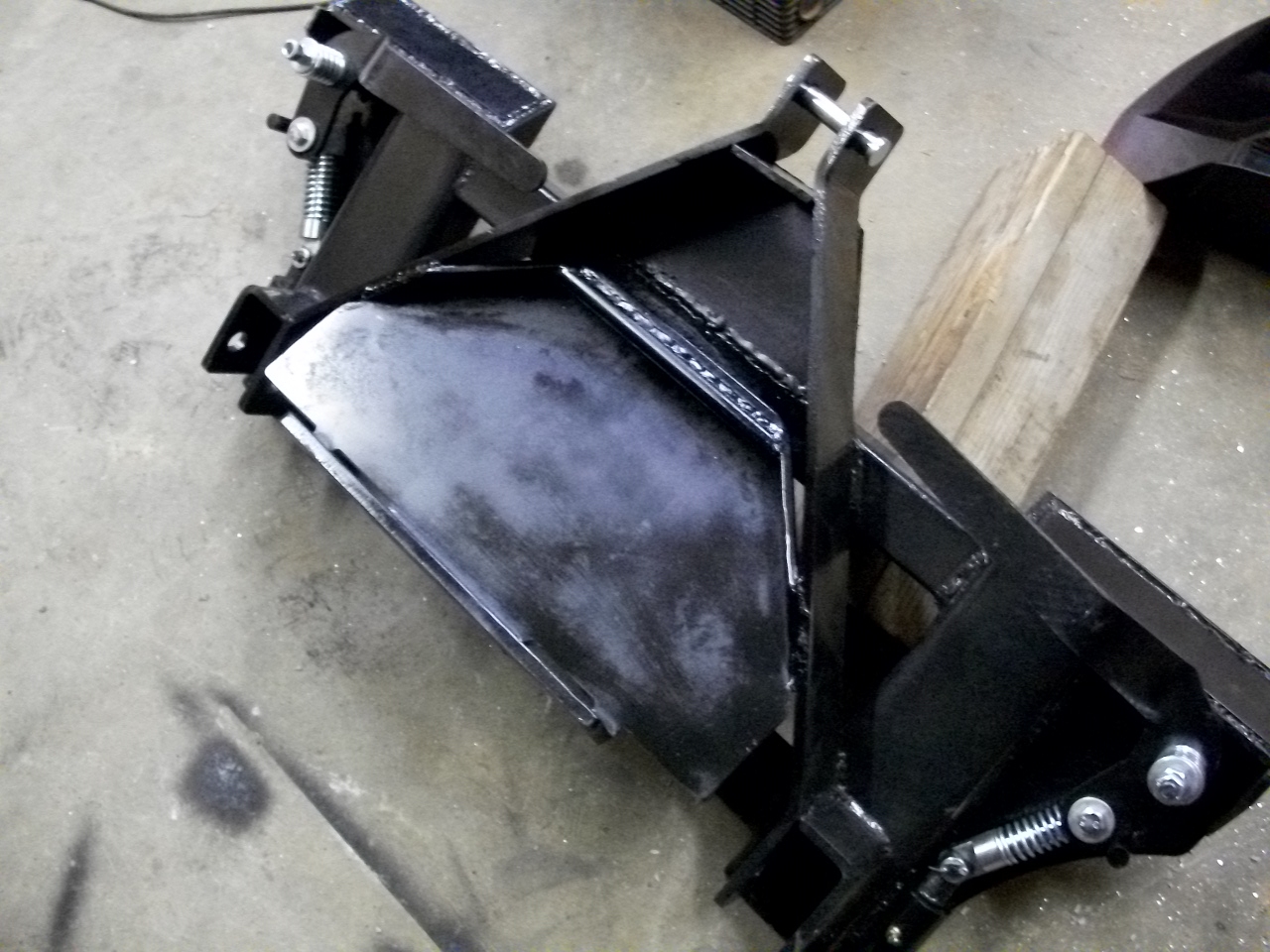

Just curious if Power Trac requires proprietary attachments. I'm a little familiar with them, but not enough to know what attachments they take. The Antonio Carraro tractors hook up to any regular 3 pt hitch attachment. I wanted the Carraro because they still offer a gear-drive transmission. They have the option of front and rear pto. My application might be different than other people's, but I do think those tractors have more potential than people give them credit for. Having said that, my intended use didn't involve a loader so that would factor into a person's decision on what tractor to purchase
Yes they use proprietary attachments mostly due to the quick disconnect from the seat. On a somewhat negative look, the attachments don't interchange between sizes, as it would be a waste of capacity to have a 65hp attachment on a 25hp machine.
For my 30hp and 65hp machines, I made adapters to go to standard skid steer and also the mini coupler as the purchase price of generic tools can be cheap from places like Titan where I bought my flail shown in previous post's pictures. Just an FYI, I have attached a pic of the PT to skid steer adapter I made.
If money was no consideration, I would have a A Carraro, but I fix all my own equipment and a hydro Italian tractor needs factory training to get in deep. The PT is just a pump and motor and easy to replace. Unfortunately only one range.
The first PT I bought for brush work about 5-8 years ago, was the PT180 for $5500 (before building back better). For that price could you walk into a John Deere dealer and come out with a new tractor with 4x4, power steering, loader w/quick attach?
The older PTs had a rear PTO and 3pt, but they found once you use the front quick attach, there was not much reason to use the rear 3pt. You can change a front attachment in less then a minute if no hydraulics, so why fumble with a rear attachment you cant see well?
