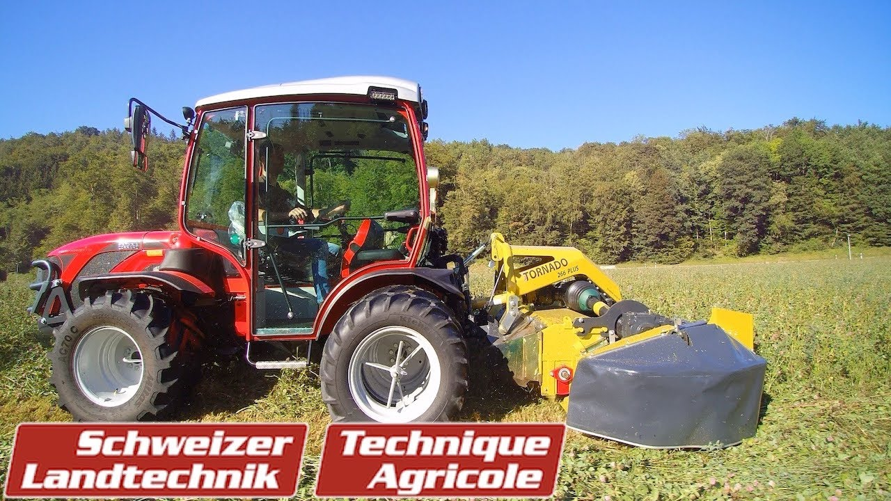

Antonio Carraro tractor with the reversible platform could be another option.
I can’t believe these tractors haven’t exploded in popularity here in the states. Small, tough, maneuverable, stable on steep hills.
I could literally build another business division cutting steep banks with one of them.
Have seen a few for sale at VERY affordable prices, but dealer support would be very difficult.

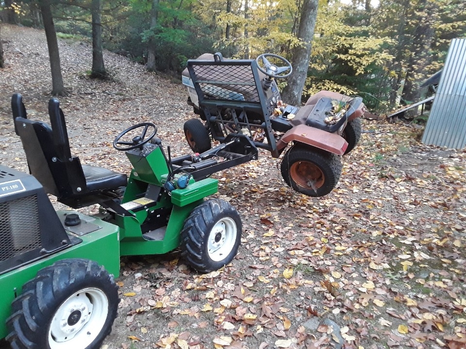

I had the same problem with arthritis and long hours of forward/revers while using a rotary cutter and other implements. I tried numerous tractors starting with Steiner which ended up too small, no ground clearance, no lift height (I never tried the loader).
Then I moved up to a Goldoni reversible tractor, it was a gear drive and after all day, my knees hurt.
I then tried a Power Trac it is a hydrostatic articulated tractor with a quick attach loader and has a hydraulic PTO for dozens of implement, all on the front of the tractor. I liked it so much I bought three sizes (18hp gas, 30hp diesel {now replace by a 30hp gas} and a 65hp diesel). I use the 18hp with a rotary cutter in tight spaces and it couldn’t be better. They are low to the ground so very easy to get on and off yet the bottom is steel plate so you can use 110% of the ground clearance not like Kubota’s etc with delicate hoses and linkage to hit, even know it is much higher. I seldom use my conventional tractors much anymore.
If you’re interested I could tell you more about them.

I agree 100%. I was actually pretty serious at one point about getting an Antonio Carraro and putting a heavy-duty flail mower on it and do custom brush mowing. Maybe they would be a bit small for your application. They import up to 75 hp models. They have bigger ones but those arent imported due to emissions reasons. Those are the ones i really want. Also, check out their Mach 4 model. It's basically the same tractor, but a quad-track. In my mind, it's one of the coolest tractors in its size category.
Nearly all the Antonio Carraro models have the option of turning the seat and steering wheel around so you're looking out over the 3 pt/pto. The visibility is phenomenal.
