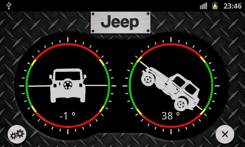

How accurate is that? Amazing at how many things phone apps can replace. Not that I would build a house with one, but I might hang a picture with one.
It's accurate compared to a manual gauge I have.

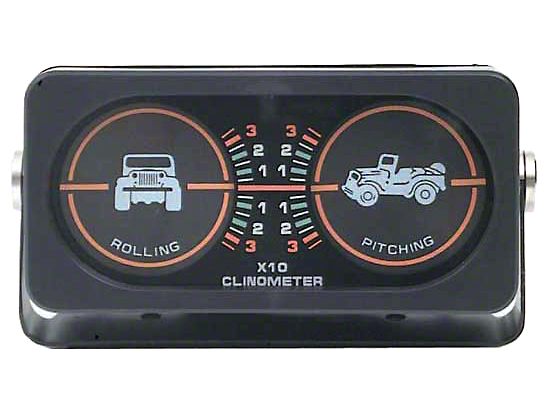

I take all side hills with caution. I have a tilt meter above the dash I use for establishing grading slopes or crowns. 20 degrees is common place but like Diesel it is at the edge of my comfort range. The trouble with side slopes is they are all different even if they measure the same. A lot depends on the roughness of the terrain, if you have to turn up hill which raises the center of gravity, what load you are hauling in the bucket or the 3ph, and what you are doing. For example I can go really steep on a smooth slope with my sickle bar on the up hill side but way less than 20 degrees skidding a log straight up a slope where I have to make a sharp turn and get on a side hill trail. At the turn the log can easily roll the tractor down hill.

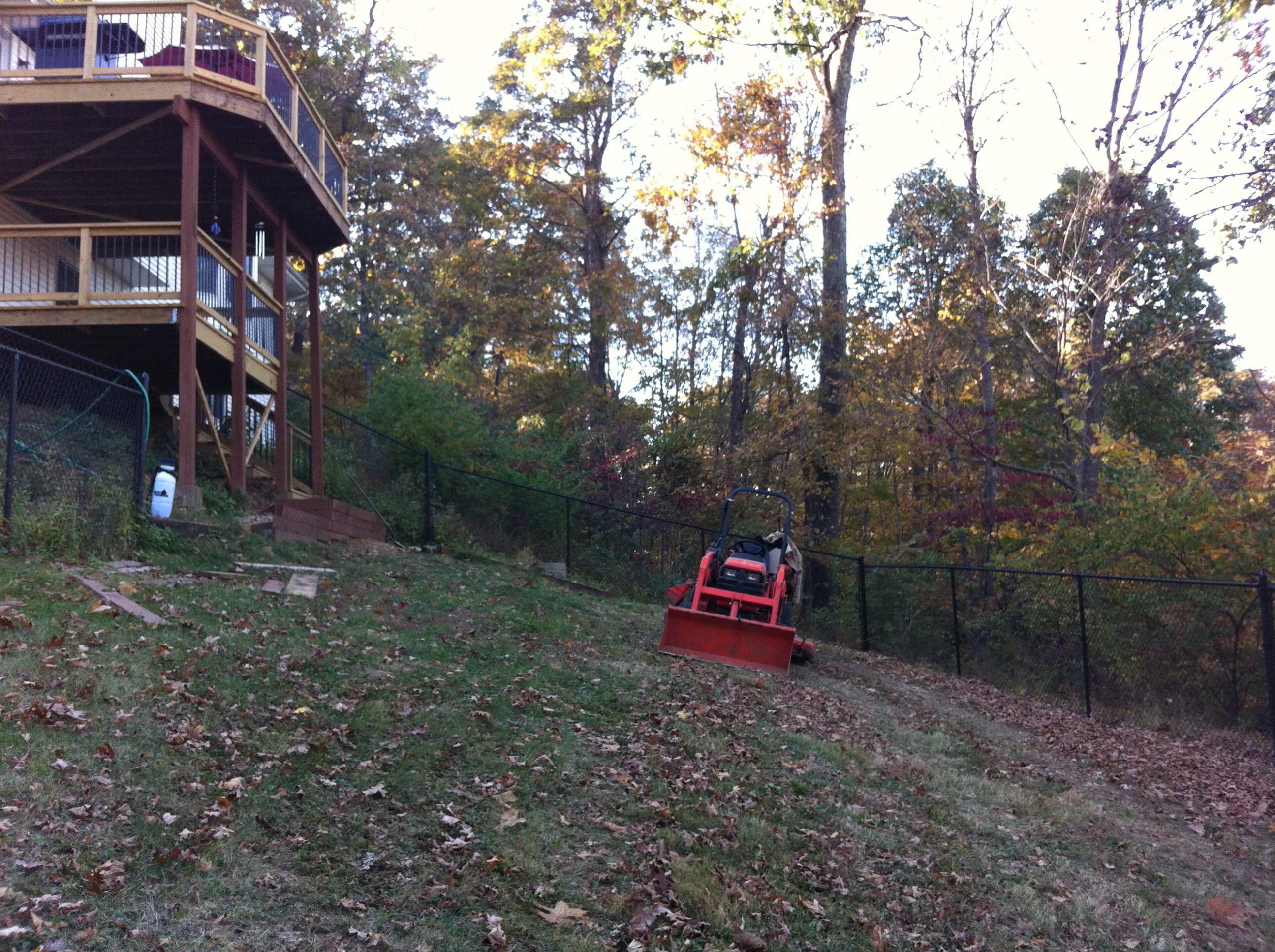

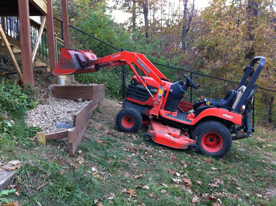

I'm still fairly new with this tractor (BX2200), but this was some good learning experience. Bringing up about 3 yards of gravel on this side hill was slow going. Dumping up the hill was easy, but traversing got the pucker factor up, both loaded and unloaded. I really need to get more counter weights on the back besides filled tires. Our 5 acres is all like this, so there is never any time to relax.

Agree you need some counter weight for most fel work. I would also be concerned with the bulkhead holding up in your picture. Looks like it needs more support imo.
/ Tractor and Slopes #38
Would wheel weights (50 lbs) do any good, or do I just need to hang my loaded carryall off the back?
I agree the picture of the wall looks suspect- but it's just the photo angle. However, I've got 4' driven piles with pre-stressed tiebacks hidden under the gravel- the end piece is only temporary. The facing is reclaimed cedar. It's quite solid.
/ Tractor and Slopes #39
Much better to use the carry all or other 3ph implement for two reasons, one it is easy to remove for mowing and second it reduces the load on the front axle.
Good to hear that there is more structure than is shown in the picture.
