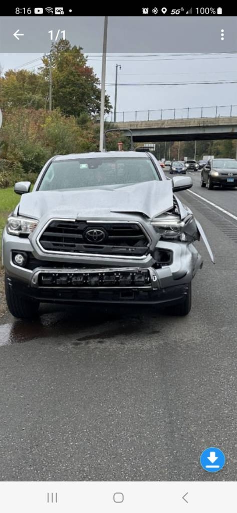

The tacoma was rated for 5000+, the 16’ trailer was 1200, the tlb was 3600. the electronic brake controller was dialed in, boosted to 3. (i don’t boost for an empty trailer.) tongue weight was not an issue - i check the leaf springs on the truck. Everything worked as expected, and nothing behind me changed places.
I wondered if anyone would say that they turn abs off when using electric brakes.

Truck looks totaled to me. Time to deal with your insurance company, pay your deductible and move on.
Sorry to hear about the truck, but I also don't buy that it's totaled, unless maybe airbags deployed. That's a $5k repair on a $25k truck; should be 100% repairable.
Assuming the vehicle has collision insurance on it, the insurance companies are a bit odd to deal with.
The owner often wants the vehicle post accident to be back "as good as new".
That accident looks like it is a fairly straight on accident. Taking out bumper, grill, hood, radiator core supports, perhaps the radiator, side core supports, fenders, headlights, perhaps the bumper mounts. It all adds up. Then the whole front end will need to be repaired and repainted. My guess is that a mainstream shop will charge well over $10K for the repair. Perhaps over $15K. And they seem to get a bit squeamish if the frame is bent or the bumper mounts are bent and part of the frame.
If the pickup gets sold at Copart/IAAI, then it will go for around $10K if newer than 2020.
So, the insurance company will factor a number of things in including customer satisfaction, and it is a good chance it will be "totaled" if they think the repair + expected auction sale price will exceed the replacement value.
Then there is a good chance that a small shop will purchase it and rebuild it and resell it.

One thing that if you deem you can't stop in time, look, for an escape. Your photo shows the pickup parked on the shoulder of a 3 lane highway. Could you have safely gotten to the shoulder and avoided the collision?

Maybe I'm way off, but it looks to be like bumper/bumber cover, lights, hood, and drivers side fender, and paint of the same; and new grill/trim. Glass, door, and everything is probably fine; honestly the radiator is probably fine too. It's not like they are gonna repaint the whole truck, that's just a hood, front fender, and a color matched bumper cover

There is coolant on the ground and the radiator is fine? It can be fixed but it’s going to have to go on a frame machine. Depending on value it could easily be totaled.

With all the fluids on the ground I'm not thinking the radiator is fine. I'm actually guessing it likely stopped when the motor made contact. Totaled is my guess.

A friend who does body work tells me that AIR BAG deployment often makes the difference between a total-loss or not.
Sure. If the repairs (including air bag replacement and anything else that's damaged) exceed X percentage of what the car is worth, it gets totaled.
X depends on your insurance, the area you live in, etc...
