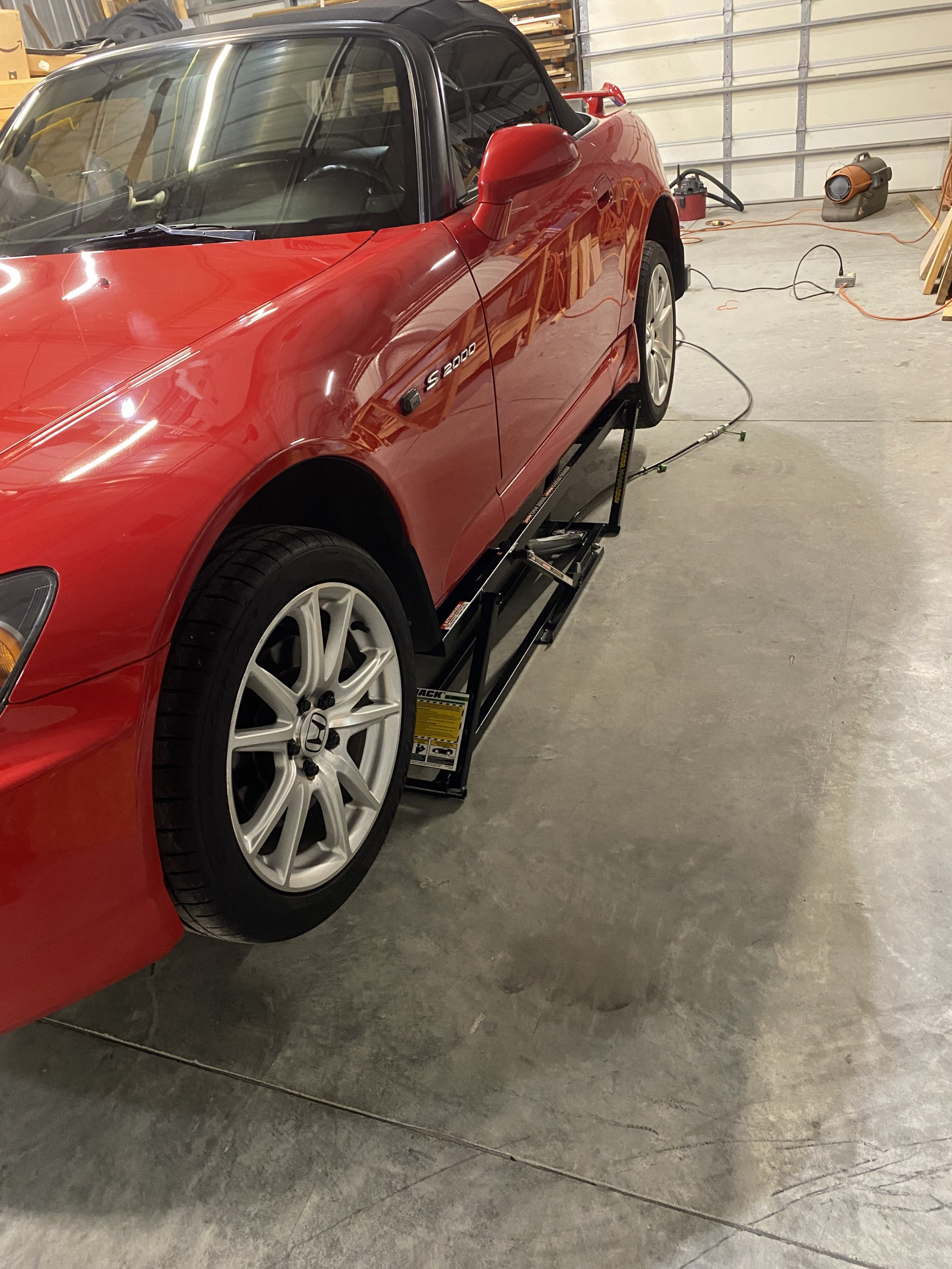

/ Torque Wrench Suggestions #74
My daughter's Honda insight is so low to the ground that I'd still have to put it on jack stands to be able to see what's happening.
Or some quick jacks.. hydraulic and a bit pricy, but nice.

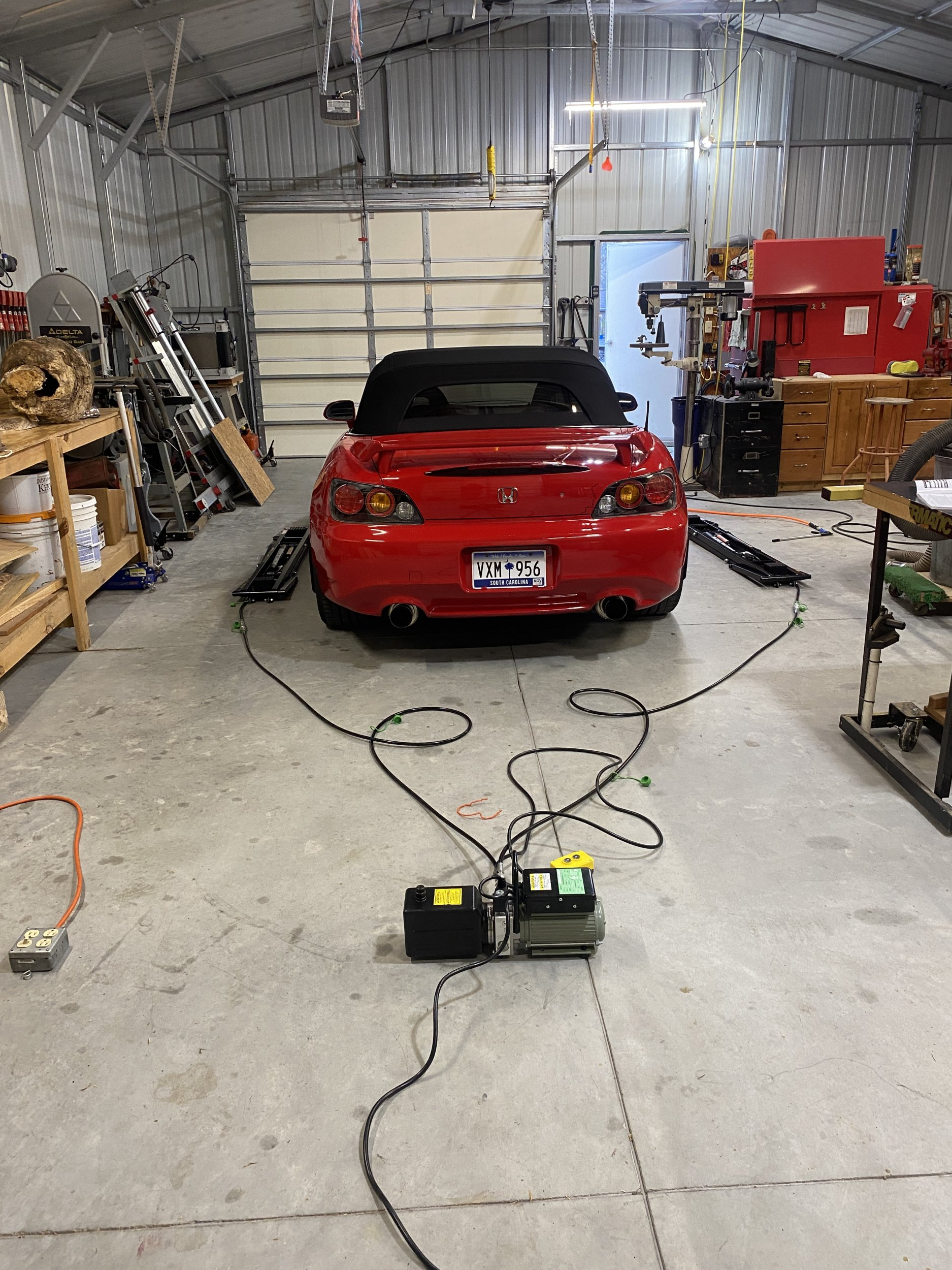

An S2000, excellent fun car. Also like the spalted wood sitting on bench on left side of pic.
