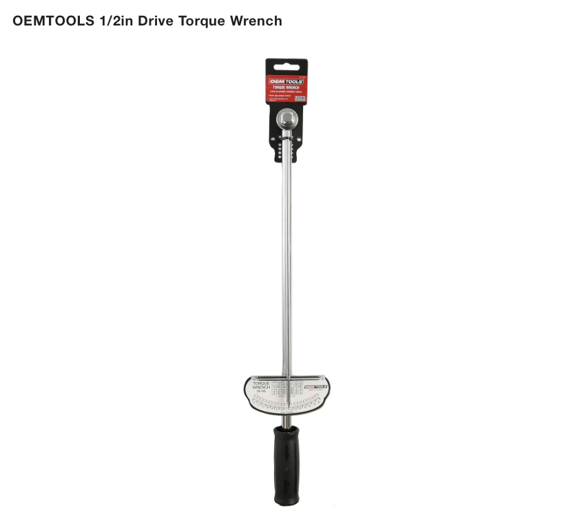

Richard,
Perhaps the below is of interest. These come in 1/2" and 3/8" drive and turn anything into a torque wrench. I have one of each and use them when standard "long arm"/ beam torque wrench won't fit into space such as wheel well when torquing brake caliper holder and for verifying whether or not standard torque wrench is still in spec. Comes with NIST calibration. I remove batteries when not in use. Beeps when torque reached and displays highest torque after torque finished. The 3/8" has min torque of 3 foot pounds or 36 inch pounds which is way lower than your oil plug spec.
