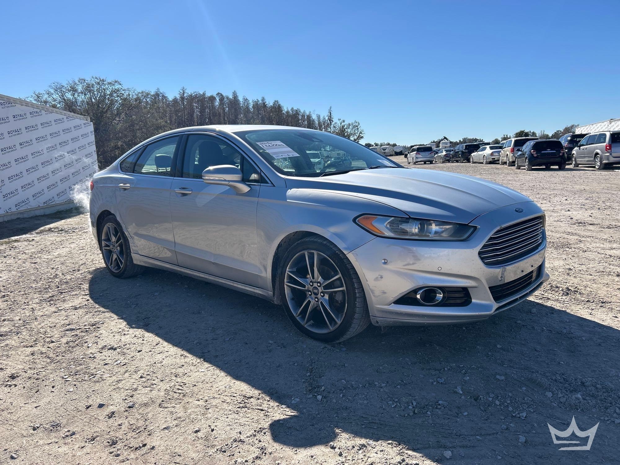

I'm guessing this screen is there to help aerodynamics? but don't know that. It certainly is NOT structural, it's pretty thin and very flimsy. Only four, possibly six "quick turn" screws hold it in place. It's very easy to get to..... if you have the car on ramps or a lift.
This seems to be standard on new cars (at least Fords) for aerodynamics. I have these on both my Fusion and F-150. They are some kind of composite fiberboard. It's a pain on the Fusion because the only exposed place to put jack stands is also the only place you can get a jack under it. So I have to jack it up and put a block under the tires, so I can get the jack under the front suspension to raise it high enough to put the jack stands under it. Once they are jacked up and the shield is removed everything is great because it's as clean as it came from the factory. The F-150 has a drain valve instead of a plug. I was initially skeptical but I really like it. Secure and easy. Drain plugs are old school.
