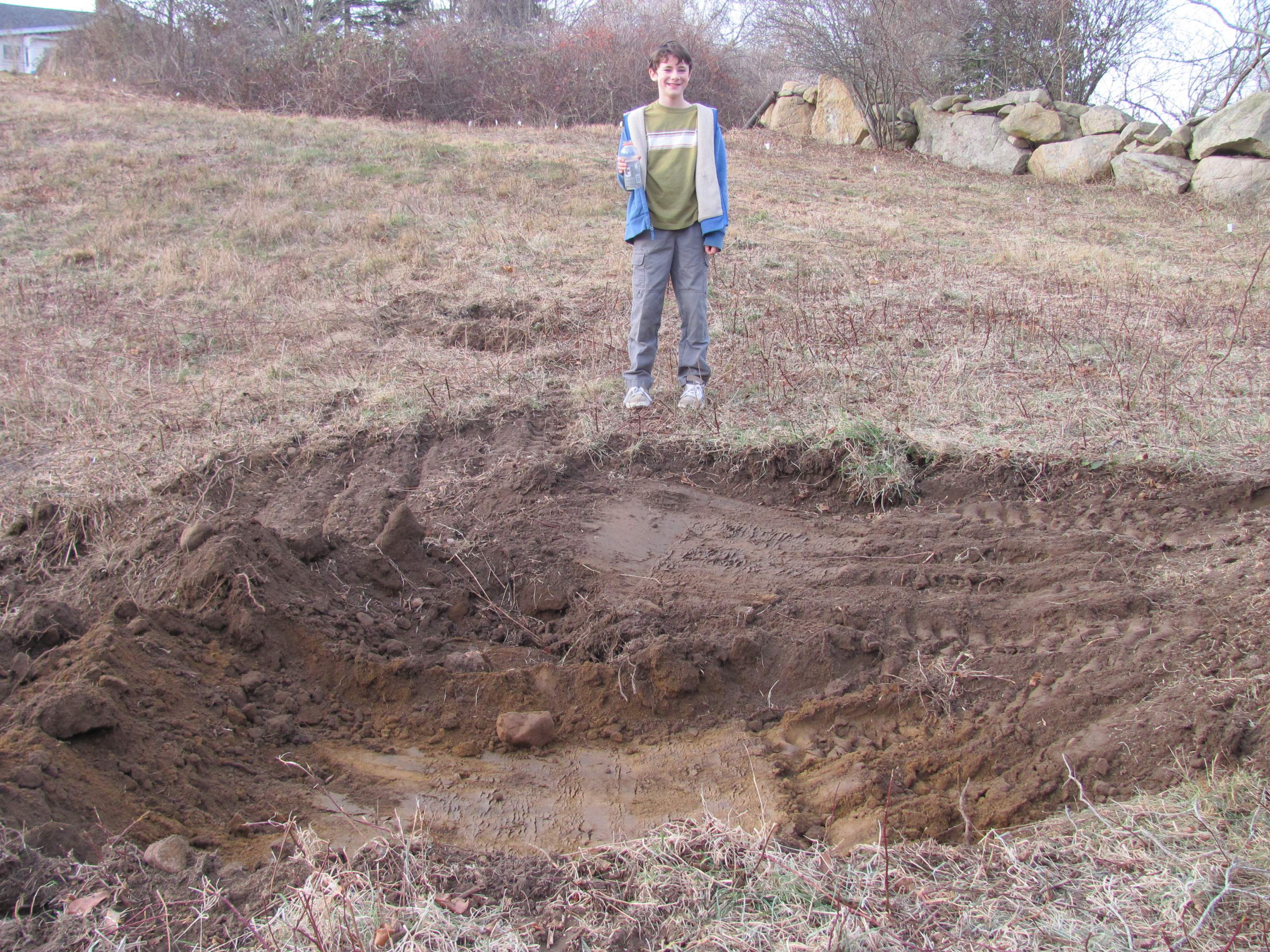

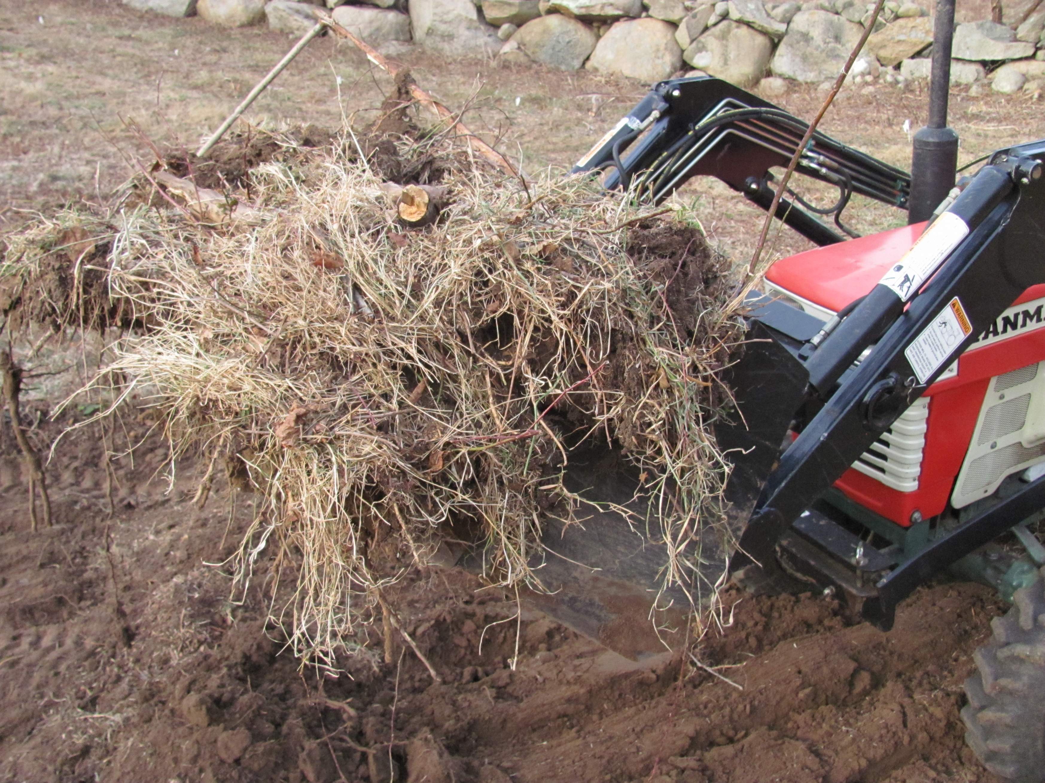

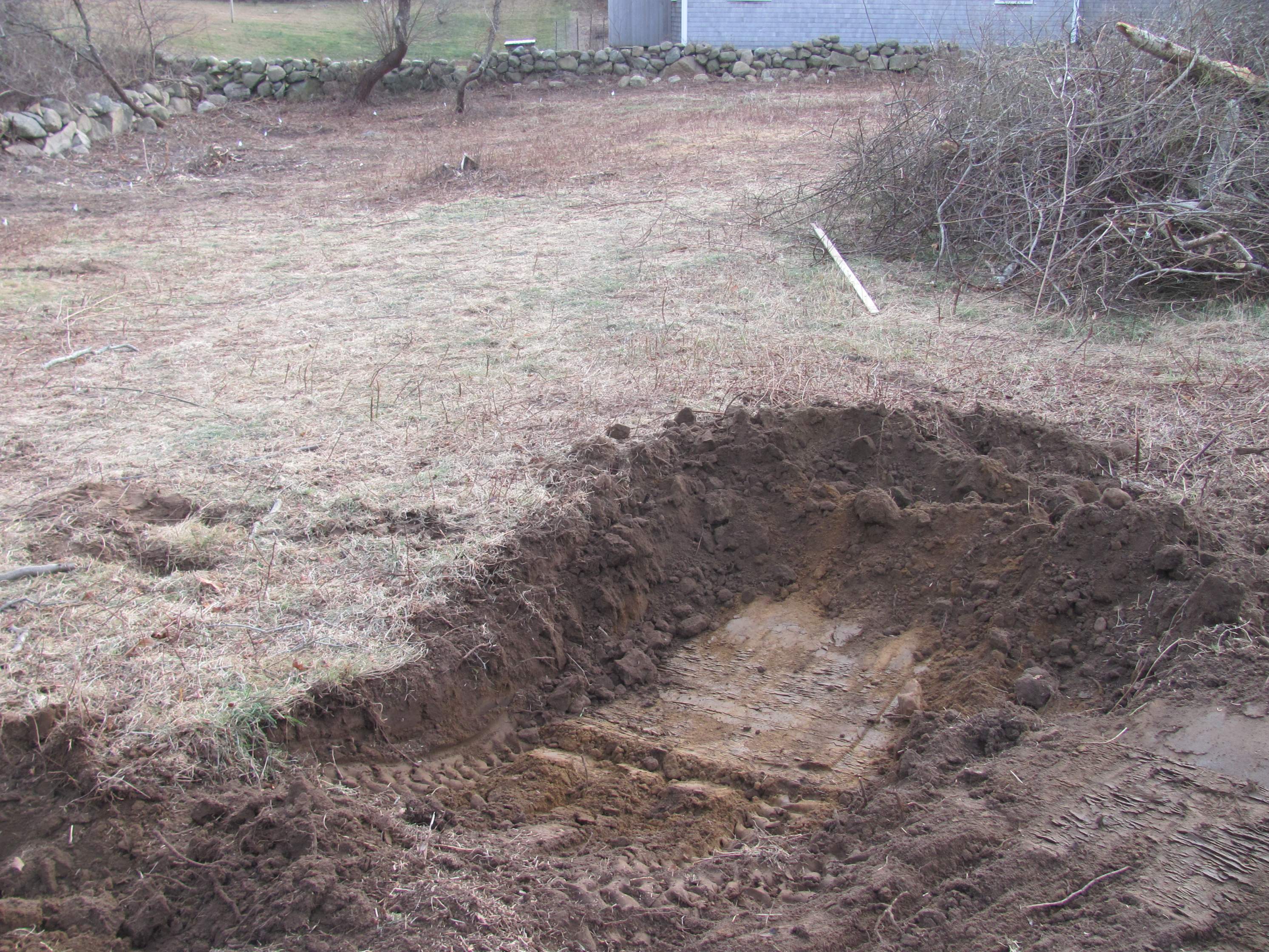

Mounted the tooth bar; started digging a pit to burn all the brush we cleared and piled w/the grapple. The next best thing to heavy equipment!! and only 26 hp!! I was very surprised and gratified that I was able to get a full bucket of dirt with every pass, the thing worked better than I expected. Very useful.....I love it!!
The bad news? My engine is definitely overheating. I "shot" the cylinder head with an infra red thermometer and got 190 (!) So....back to the drawing board.
It seems worse than before. Someone recommended flushing the radiator, maybe I'll try that first. Otherwise, is there any way to rule out the water pump, or otherwise test it?
BTW, my eleven year old son, Andre, got his first seat time. Taught him how to operate, as I walked alongside to make sure there were no mishaps. He loved it.....nice!!!!
