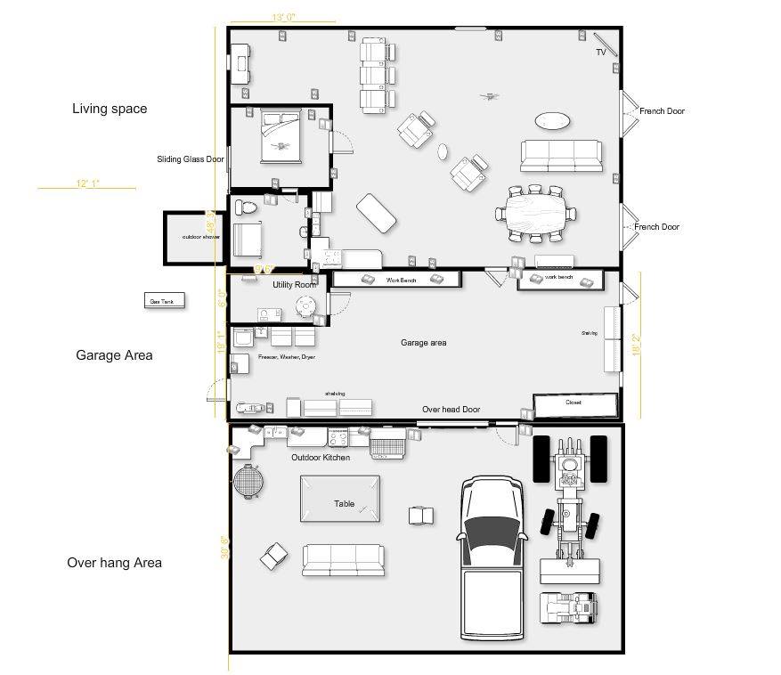

here is my floor plan layout
My living space will be 26 by 48. I am only planning one bedroom and one bathroom
with over 1,200 square feet of living space, I would seriously reconsider your floor plan. The amount of wasted space that you have in your drawing, along with so many odd sitting areas, doesn't make any sense. If this was just drawn for reference and doesn't have any relationship to what you are actually doing, ignore my comments, but as a builder/remodeler, you could create a very functional, livable home with that much space. I would have two bedrooms and two bathrooms for sure. A laundry room and tons of closets. That would be my priority, then a kitchen with plenty of storage and counter space.
My home was 1,000 square feet and I have 3 bedrooms and two bathrooms with my laundry in the hallway. I added on 240 square feet to create a massive master bathroom and walk in closet with the laundry in the master closet. At 1,200 square feet, I now have 3 bathrooms.
I also paid cash for my home and work on it when I have the time and money. I moved into it with one bedroom and bathroom done. I ate out of a microwave and a refrigerator in the garage.

I want a big open area tired of having smaller rooms. Not worried about resale value tired of paying taxes for a bedroom that someone might use once a year. I want a big sitting area.
   / Took Down Pole barn 48 by 90, Move it and rebuild to 48 by 88 for $1 SQ FT #24
It appears the drawing isn't even close to accurate. For example, it indicates the bedroom is 13ft from the walk in door to the back wall? The house is 26ft. So the bedroom door is actually in the middle of the house? So the sitting area isn't proportionately as big as it appears? If so, the space at the top of the drawing, to the left, is deeper than it appears? Will be hard to utilize that deep, narrow cavity.
I'm all about the concept. Something similar to this is what I would have built had I been single.
Maybe take your drawing to a local builder that you know and ask what he thinks? Maybe go to the local Lumber Yard and have them look at it. I got a lot of very good advice from the owner of my Lumber Yard.
Anxiously following this project. Kudos for having the fortitude to take on this project!!!!

I have modified the printed version but could not save it so had to redo whole thing and I got tired of that. the wall will go 26 feet.
the bathroom will be 9 by 12, the bedroom will be 14 by 12, and then the last space 3 by 12 will a wall to wall closet. will use barn doors
on rollers to give me access to most the room in closet. I have not poured concrete yet so have plenty of time to modify. another thing I think I want
is a v or l shaped island bigger then the drawing. It will have two surface heights one to eat on and a work space for me. I want that people can sit there
and eat off the back side with stools. At the ends I thinking about having like pine or cedar posts up to ceiling not sure yet. But once we pour concrete
it more defined. But for now I can change my mind. The two doors on the one side of building will be for my living room dinning room. the sliding door let
in so much light and opens to just my land when I look out.
My contractor is Amish and he has great suggestions and knows what I like the new place is 21 miles away so it is not a hard ship
to meet him there in the morning we change plans when something happens, thus far no big deals. Or he will call me and hey it is easier to space 4 windows
on the wall then 3.

In regards to the Island. When you get that decided don't forget to run electrical under the concrete. Plumbing and Drain also if that's needed.
Our Island is straight, 6ft long with Cooktop in center, no plumbing. Island has overhead light with switch in one end of Island. Duplex electrical in other end.

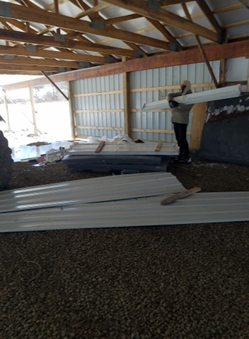

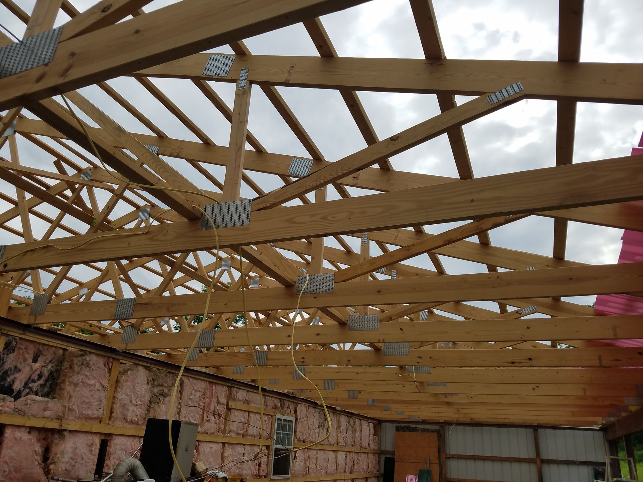

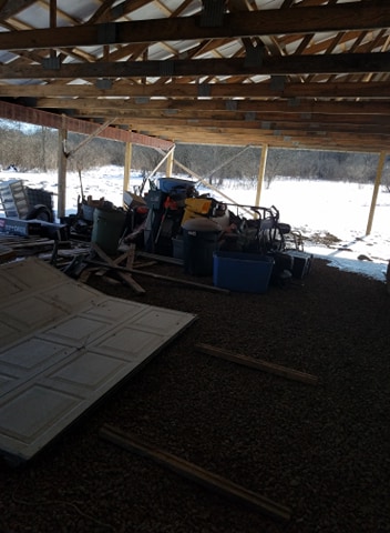

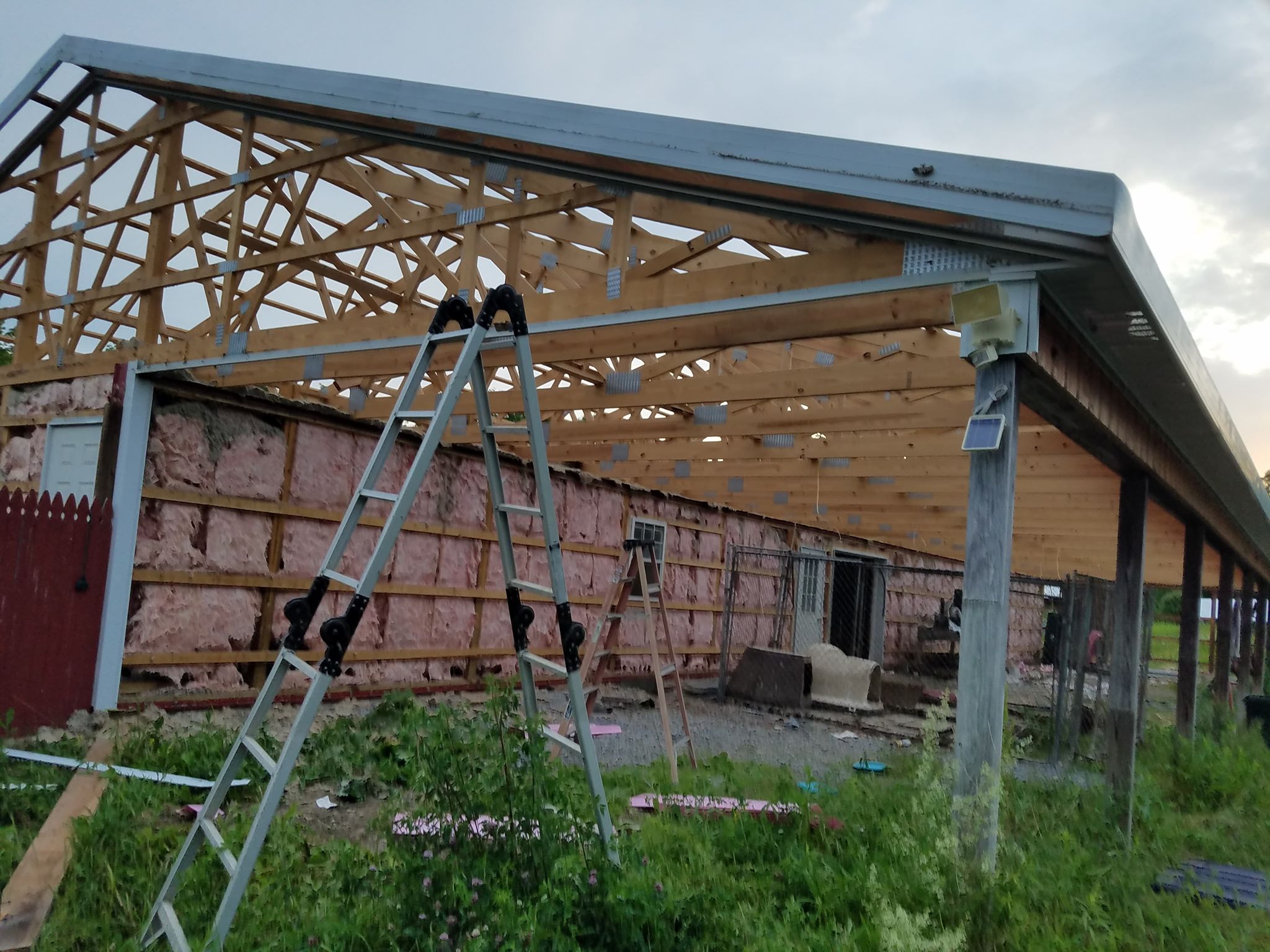

One thing I can say now that I have experience is this was well worth doing my costs to get barn down and moved was about $6000.
So long as the new barn follows the same rules about purling's with spacing it was not much of issue to use the same holds in roof and sides.
Even the metal that had cut outs for outdoor electric we will just put outdoor electric plugs there. With our snow load the trusses alone would
of cost that. Plus we moved about 3 to 4 ton of metal. Saved many of the posts and headers. Windows,, doors,, etc.
The only thing I can say is who ever takes it down should be the crew to put it back up again. That is what I did. I have no regrets.
Poles barns are easier to break down then a house as most of them in this area the truss are 4 foot on center, the purling's are always spaced the
same. Also the barn I took down was a good quality barn the Amish guy that did mine said it was a very well built barn much better
then the Morton pole barns they have worked on.
We even saved some money by reclaiming the 2 by 4 to reuse to brace the poles I bought a pneumatic nail gun remover. Air Locker nail kicker removing 9mm stick nails & 16 gauge brads. - YouTube We put a 5 gallon pail out to catch the nails in most cases it shot it clear thru the wood and into the pail.
but the over the nail and shoots it out the other end. Even removed the spiral nails that tool is the Cat Butt. It cost about $40 bucks on amazon
was well worth the money the Amish guy wants me to find battery operated one for him.

You might want to talk to your insurance company about your design. They may have requirements regarding the separation of your living quarters and garage?? Not sure about that. Our insurance agent asks us about the joining wall's construction. He also commented positively about the floor design.
I would suggest that you construct as if you are going to spend the Winters there. We never know what the future holds. You might find yourself unable to make the trip South each Winter.

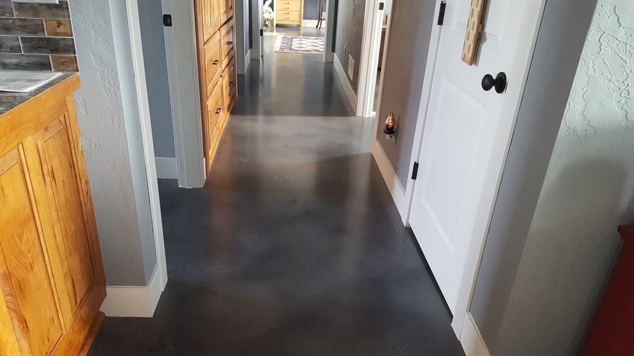

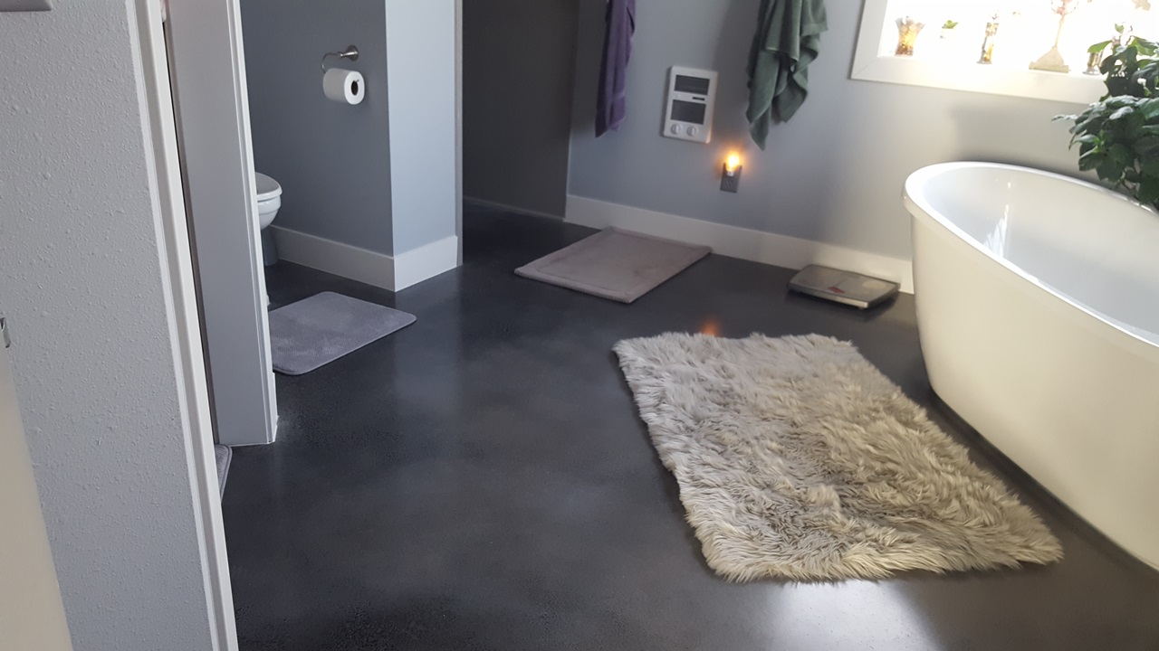

Wow I love your floors. that is exactly what I am talking about. I had floor in in my old barn but don't want to bother in new one.
My truck will not go in garage just underneath my overhang so long as the sun and weather don't hit it that is all I care about.
Yes I will insulate fully and have the systems to deal harsh winters and staying warm.
I had done the same thing in part of my old barn
Excellent point, in many cases they will require a fire-rated door and fire rated sheetrock with all penetrations sealed with the red calk.
If you're going to be there in the winter, I would strongly recommend that you look into putting in radiant heat in the slab. It makes for amazingly comfortable heat in a living area.

I agree. If you already intend to insulate the concrete the additional cost of PEX is minimal. Insulation is pricey though I spent $480 for the PEX under my house floor. Originally didn't intend to use it. But couldn't pour the concrete without installing the PEX. I was insulating either way.

We also have stained and honed concrete floors. We like them, sort of. The problem has to do with the quality of the concrete and the ability of the applicator. When the applicator has to come back to do a touch up, it won't be the same color. Also, if they don't prep the floor properly and use an angle grinder to "smooth it up" it's not going to turn out well. We are putting in an epoxy floor, we're expecting it to be completed next week. We have high hopes for it, we'll see.

3Ts, our concrete guys were great. The floors were properly poured, prepped, stained and sealed. So far we haven't had any issues.
As to the step at the door. Our concrete porch is poured 1/2" lower than our slab. Then it is gently sloped up to the entrance door. You don't even notice the rise and no step.
When you get your floor redone I'd be interested in hearing about it.

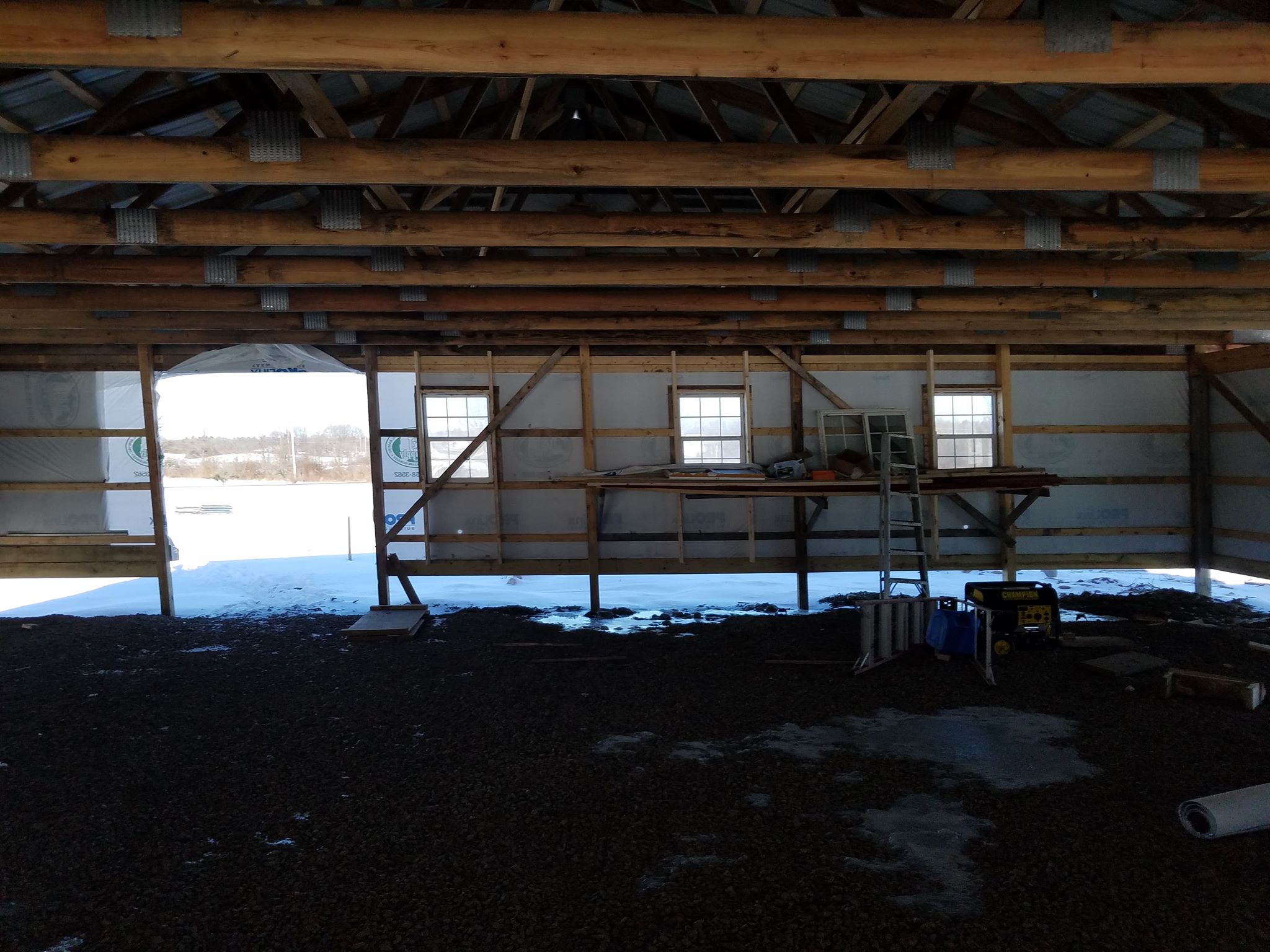

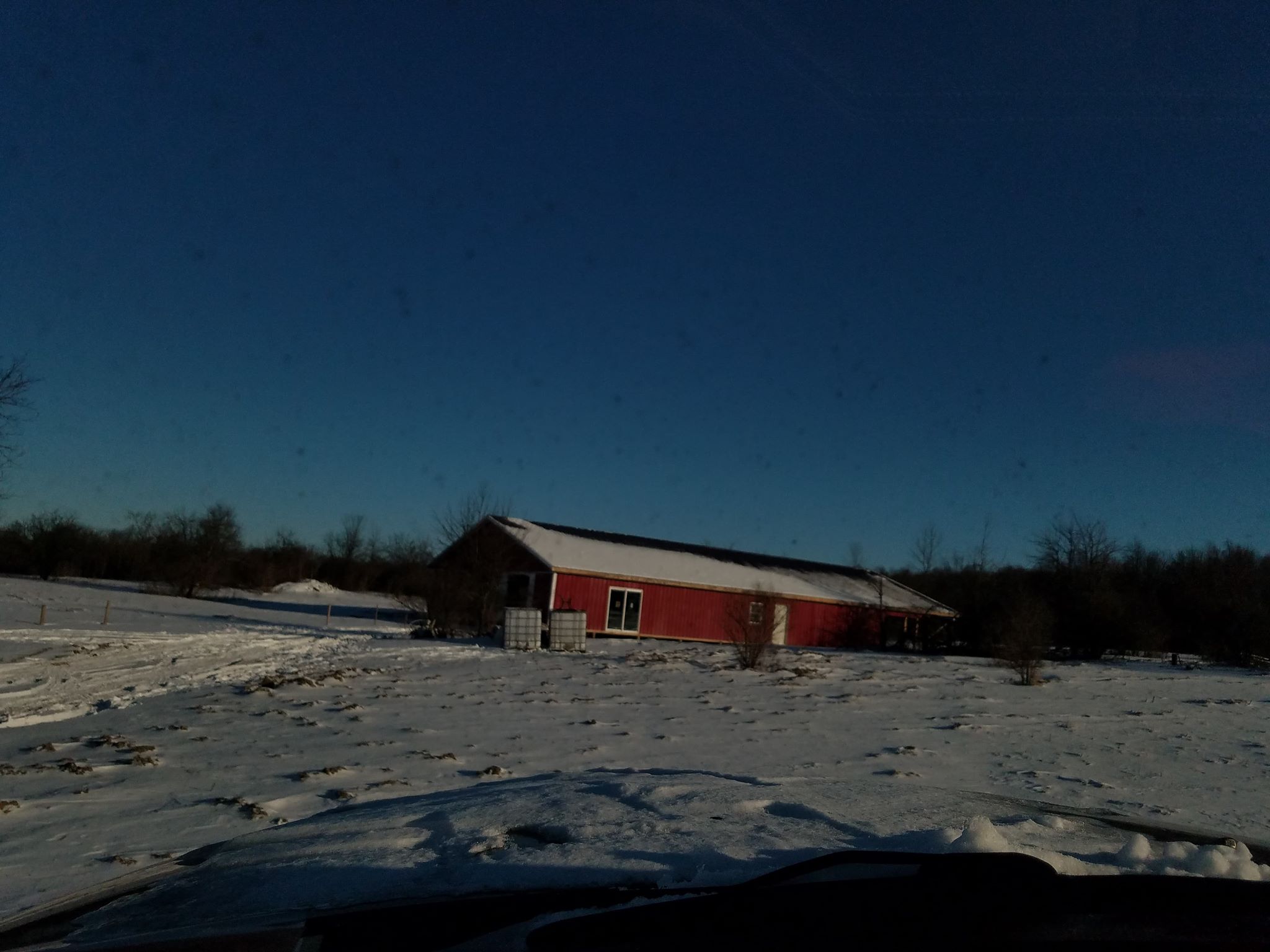

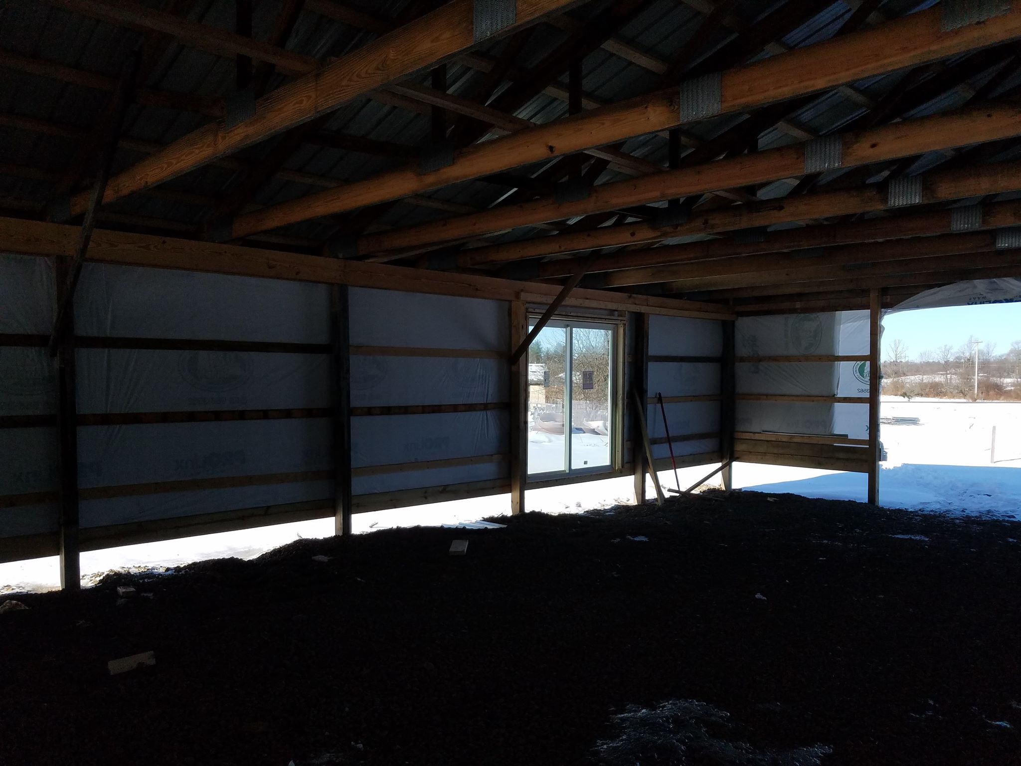

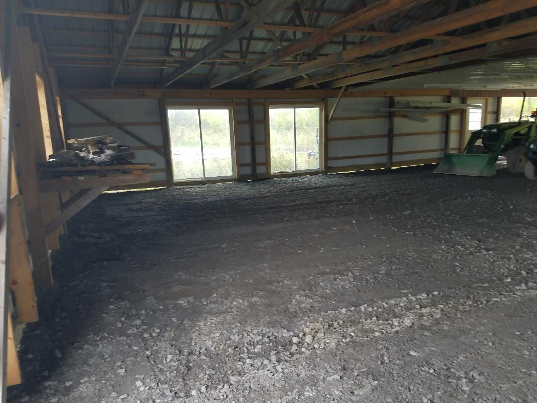

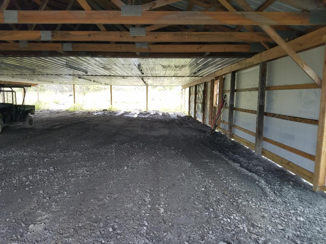

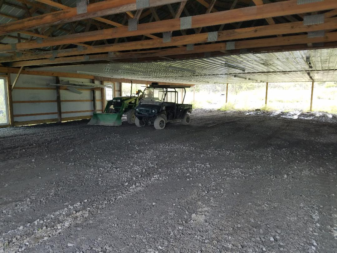

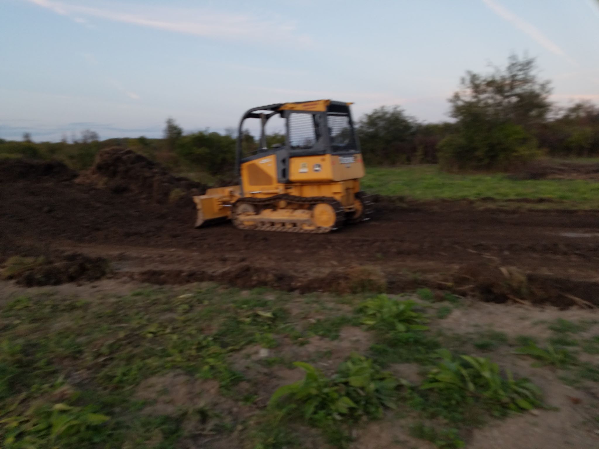

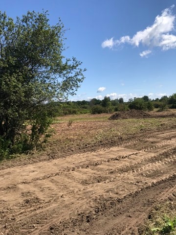

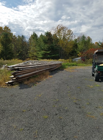

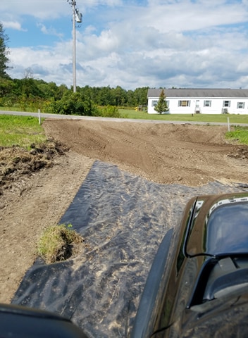

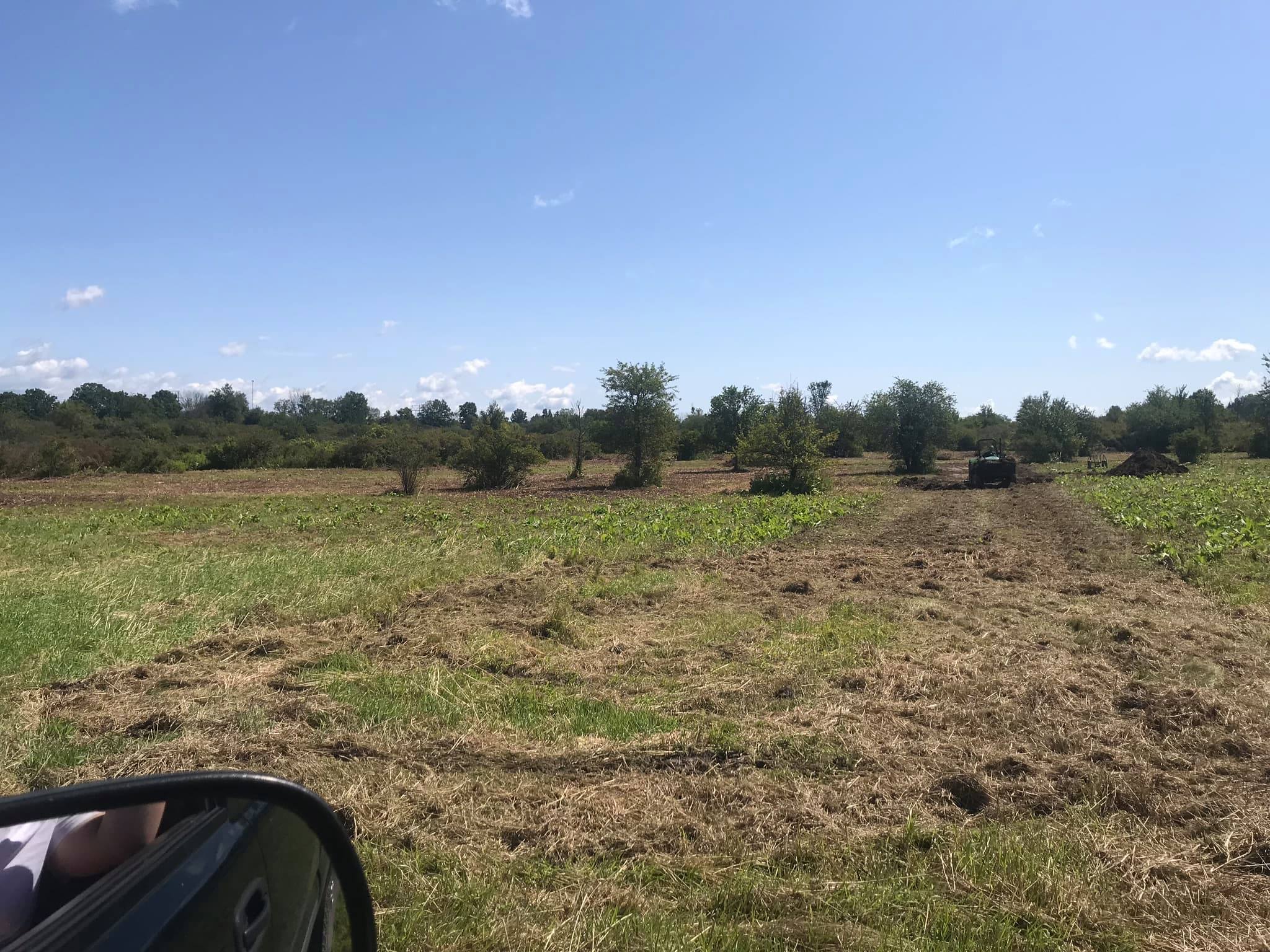

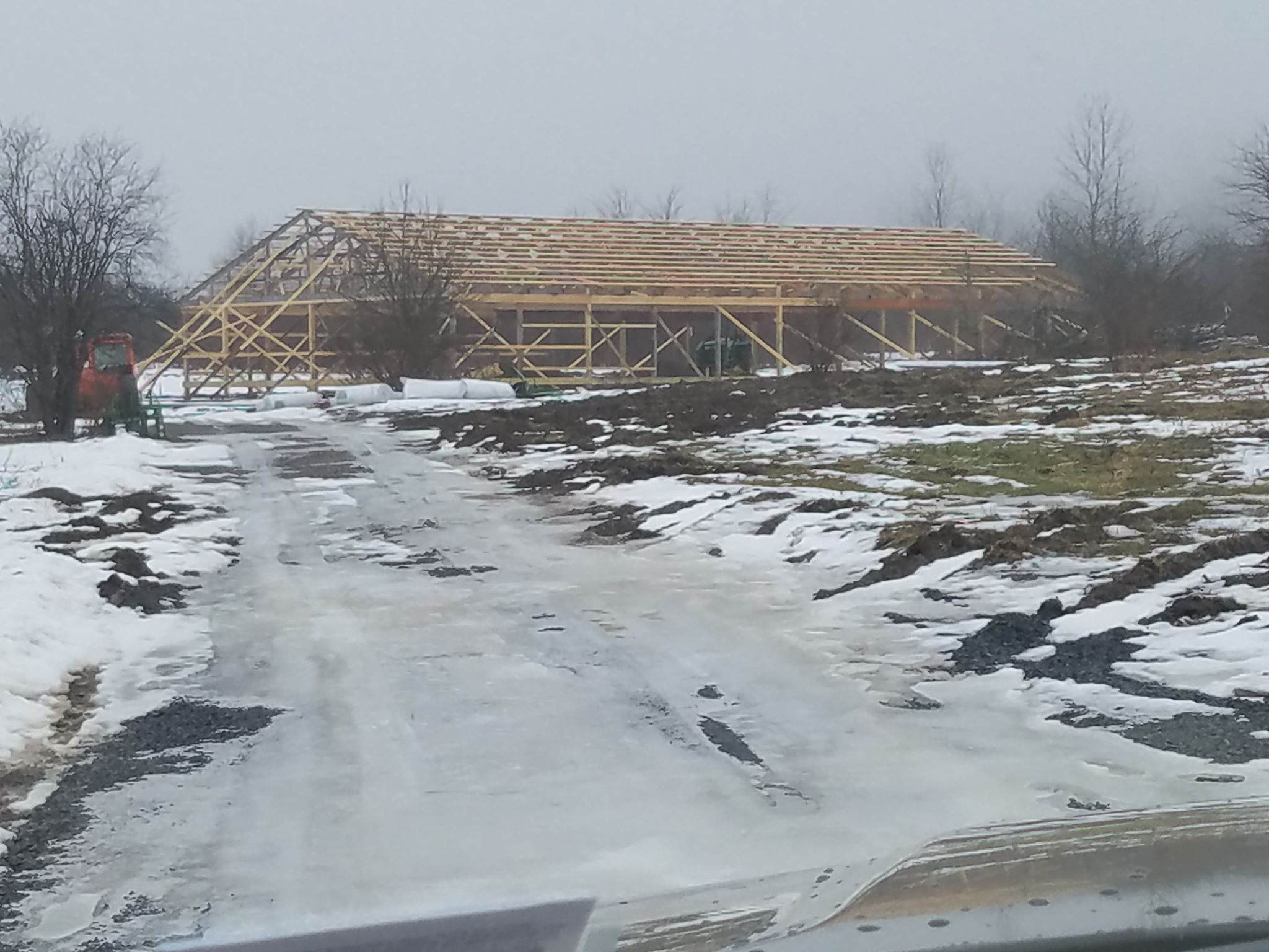

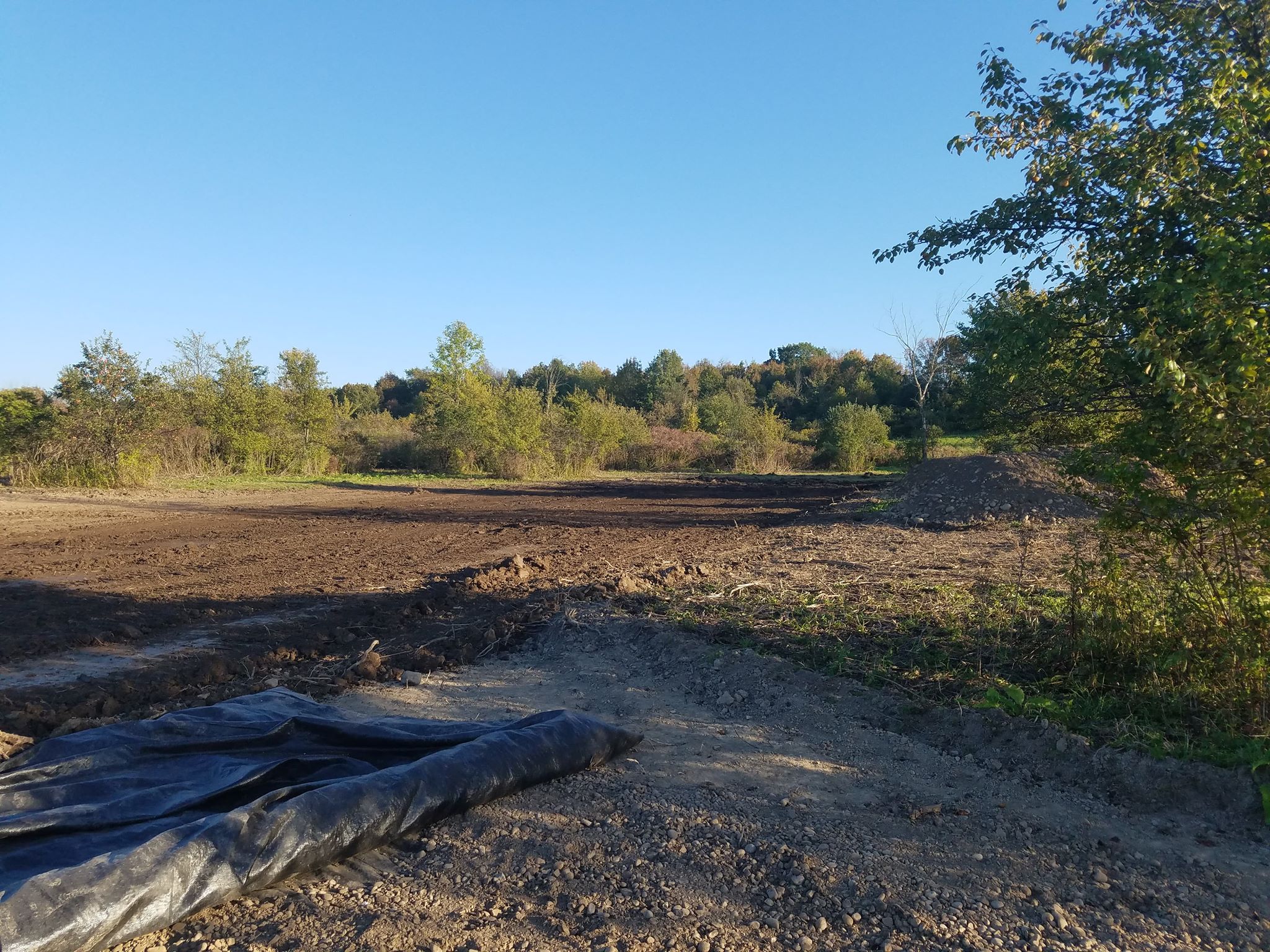

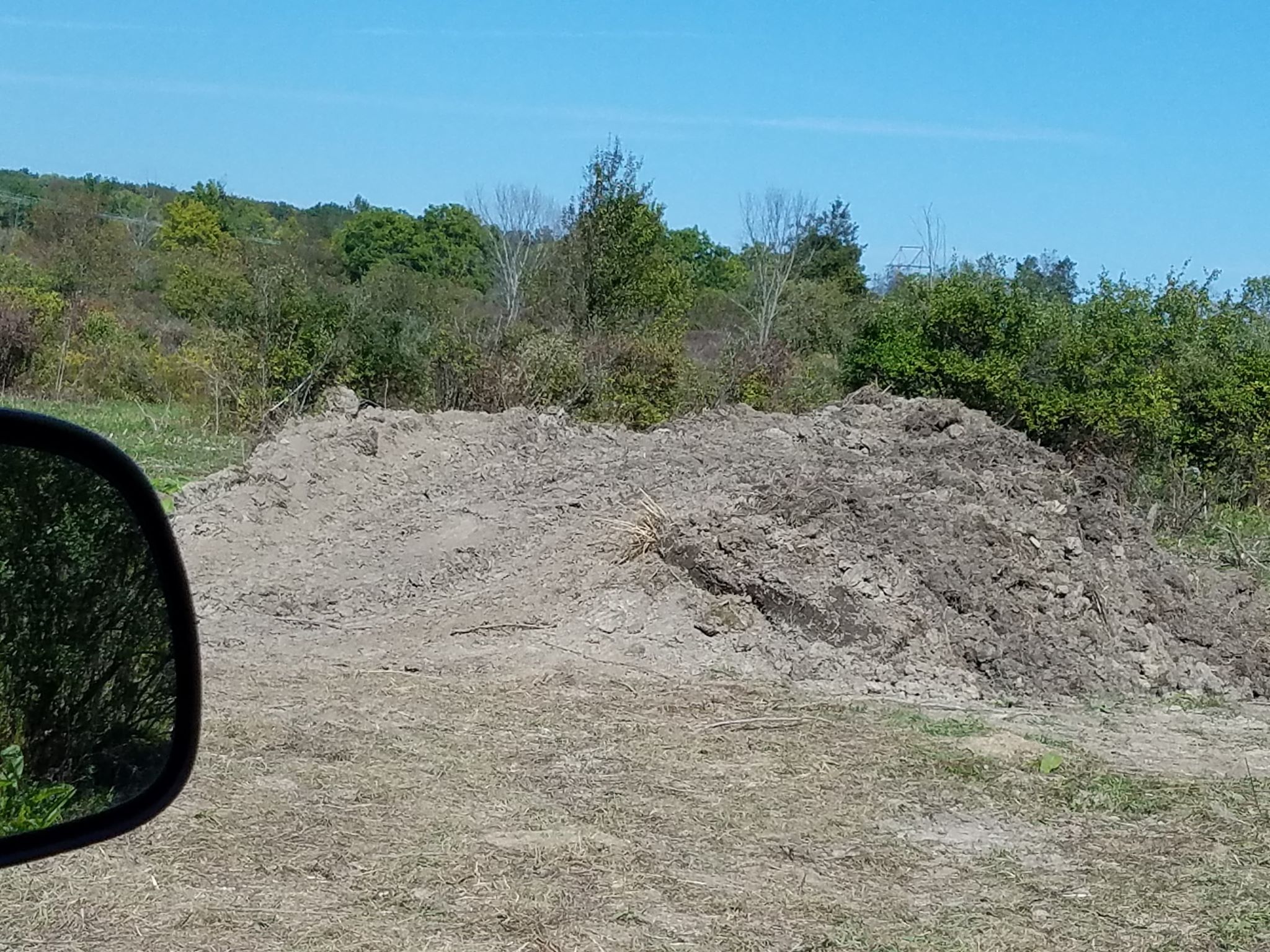

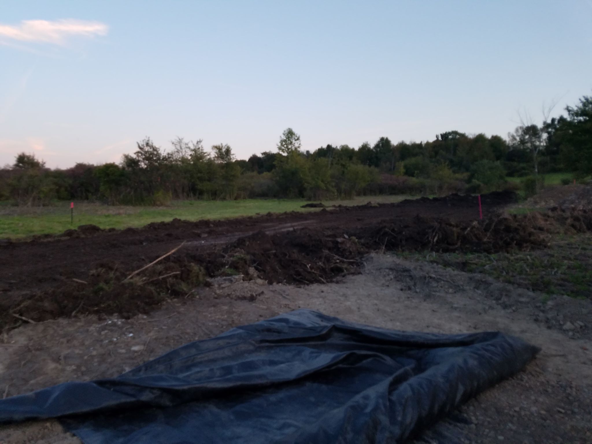

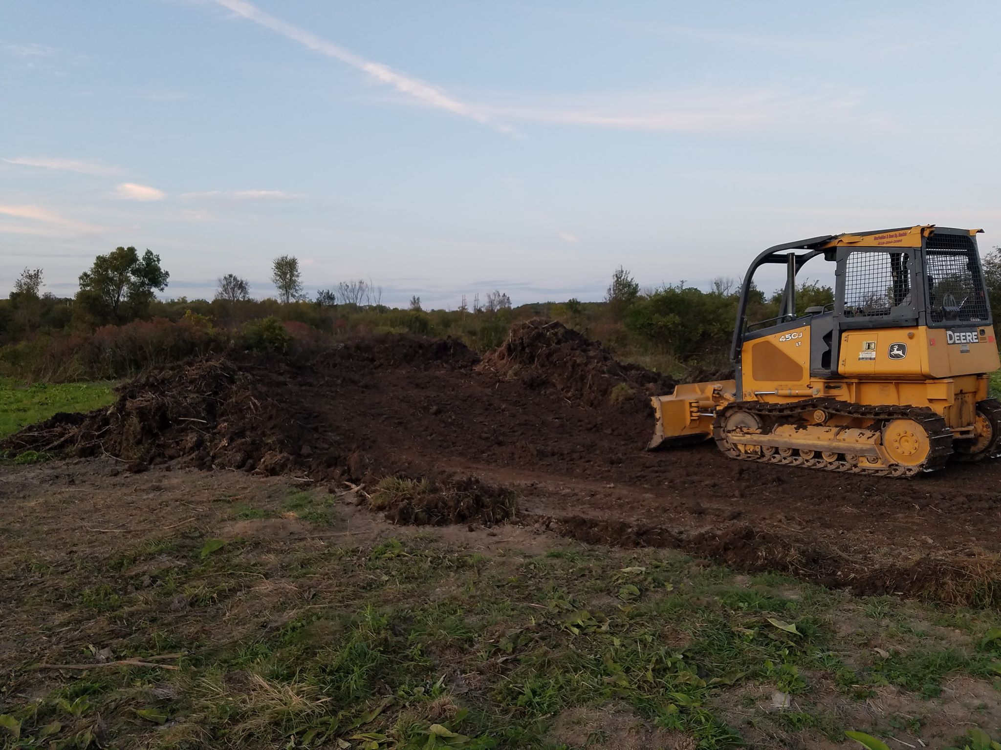

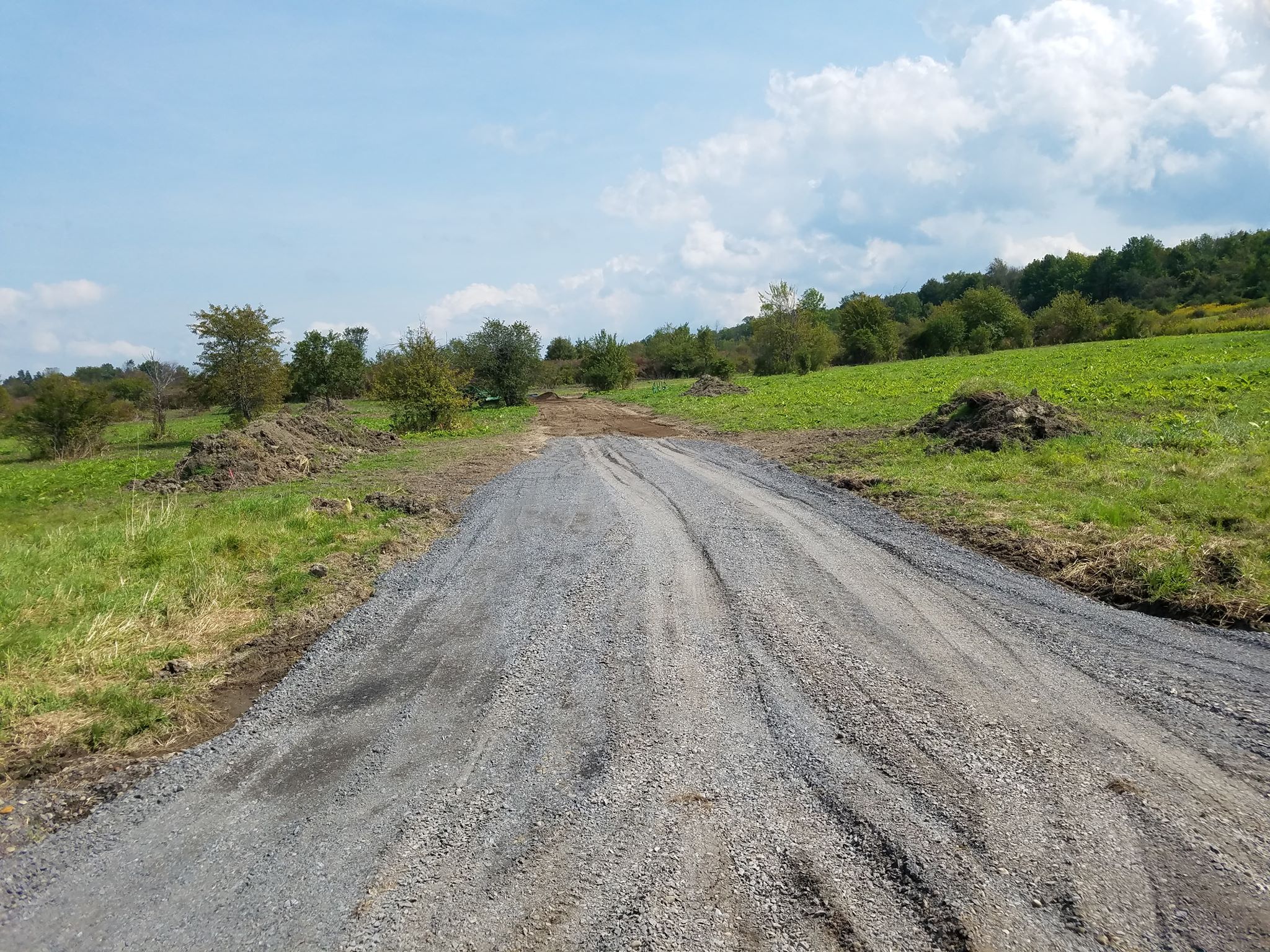

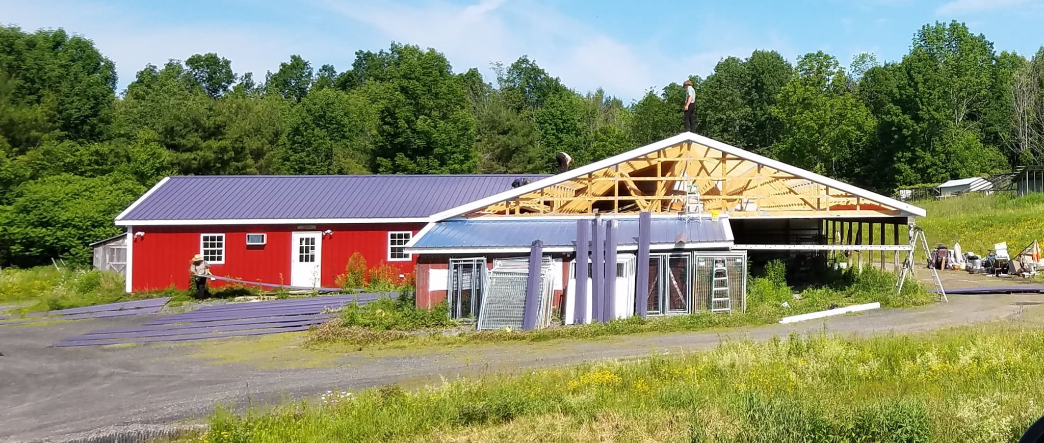

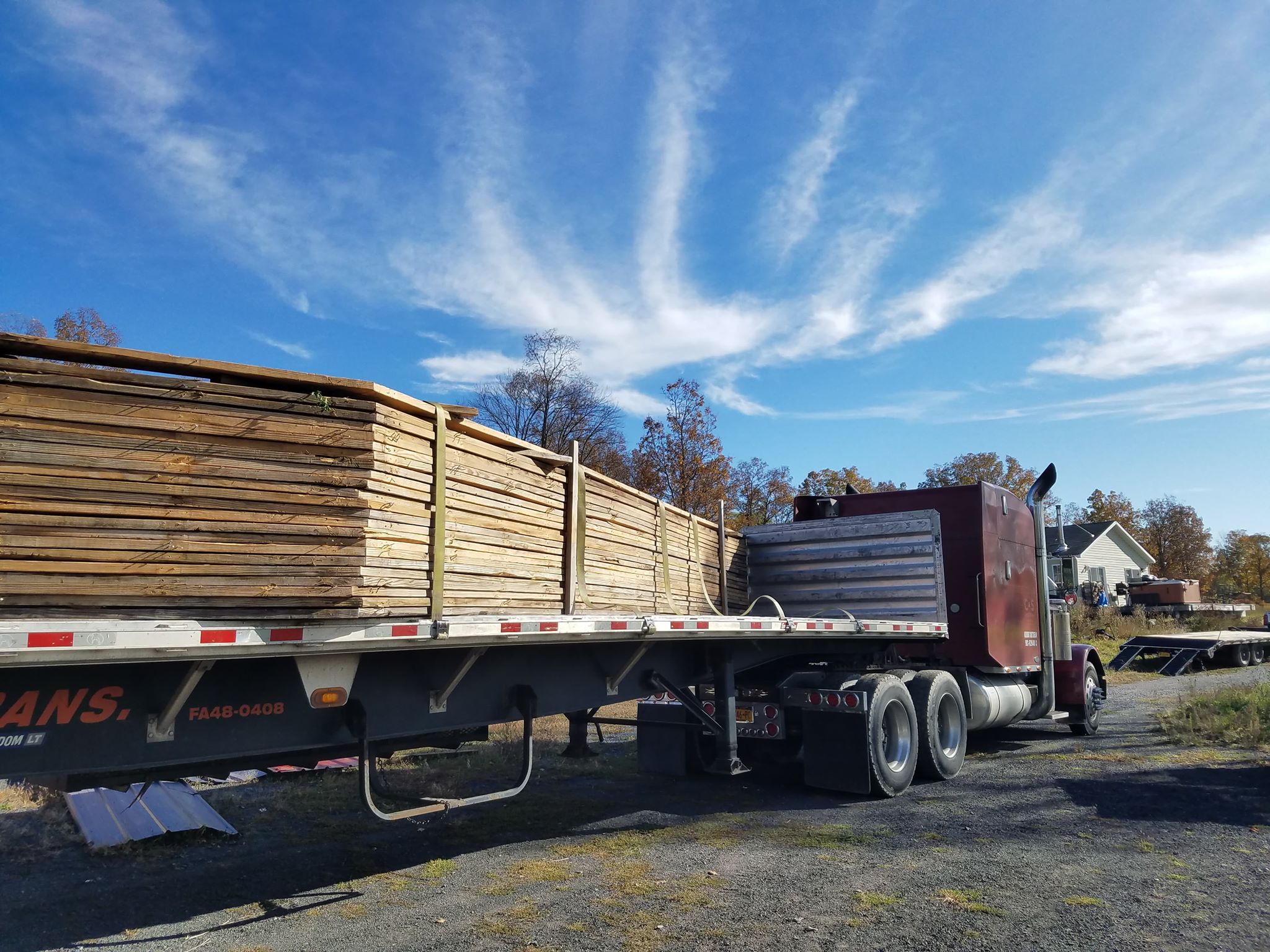

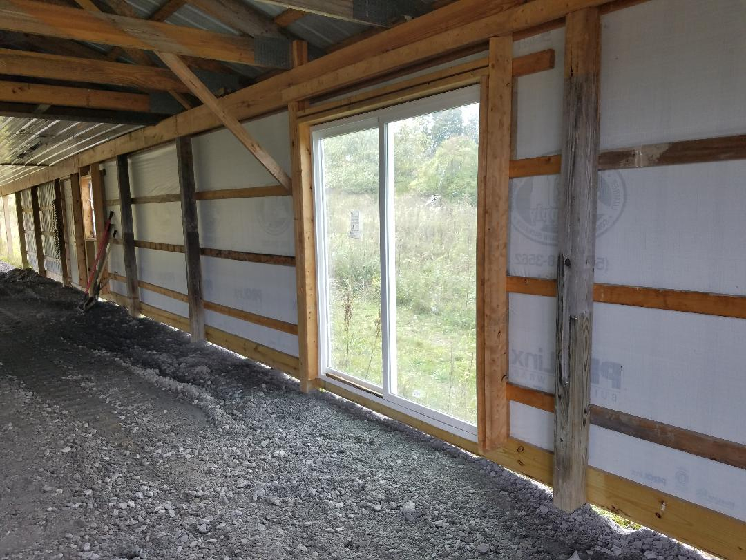

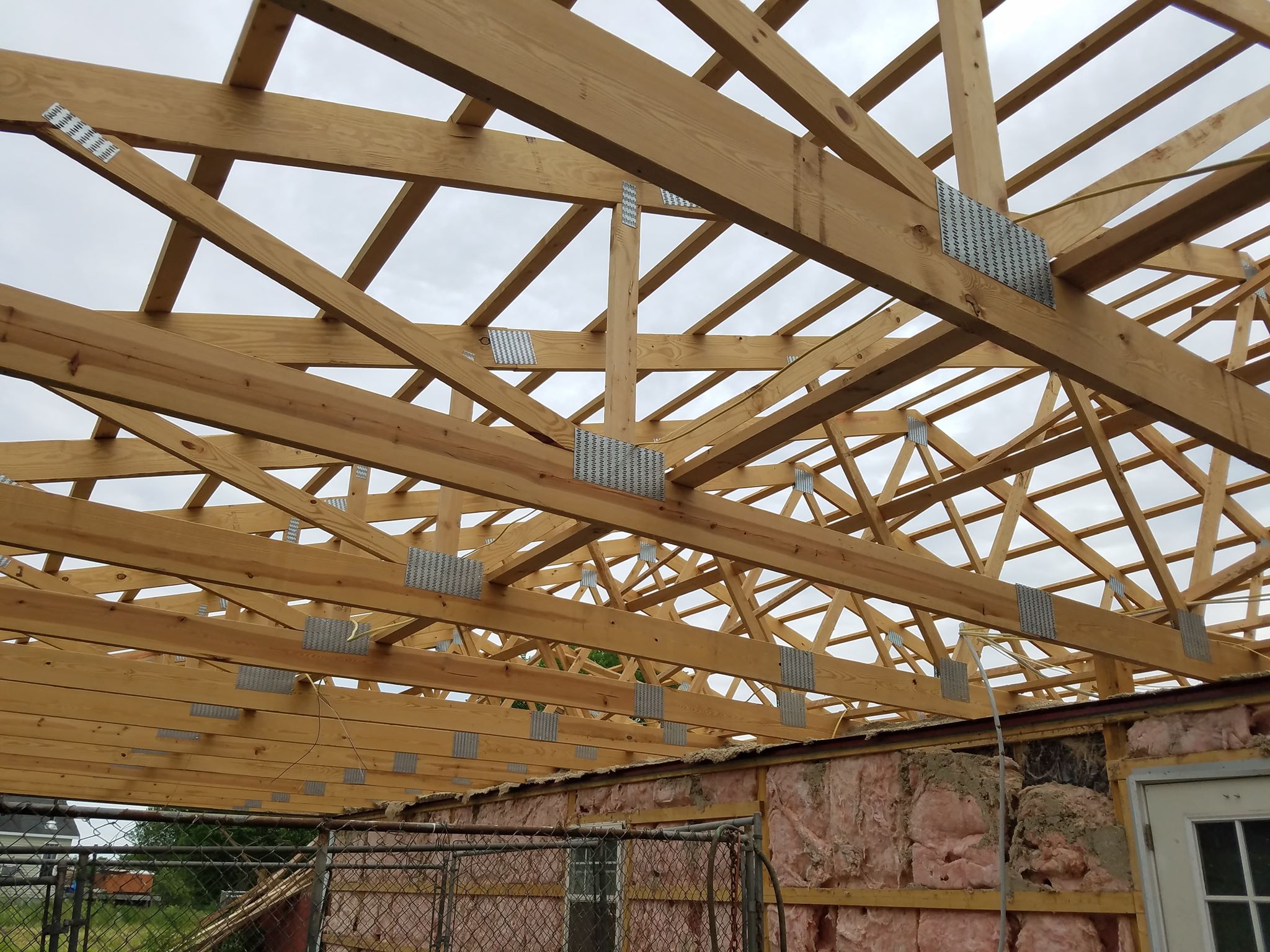

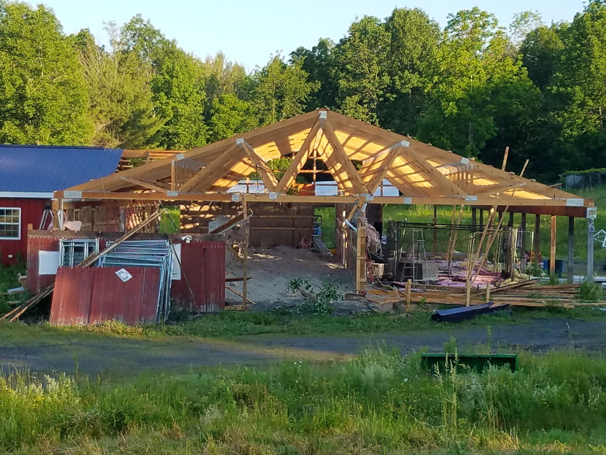

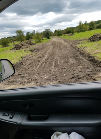

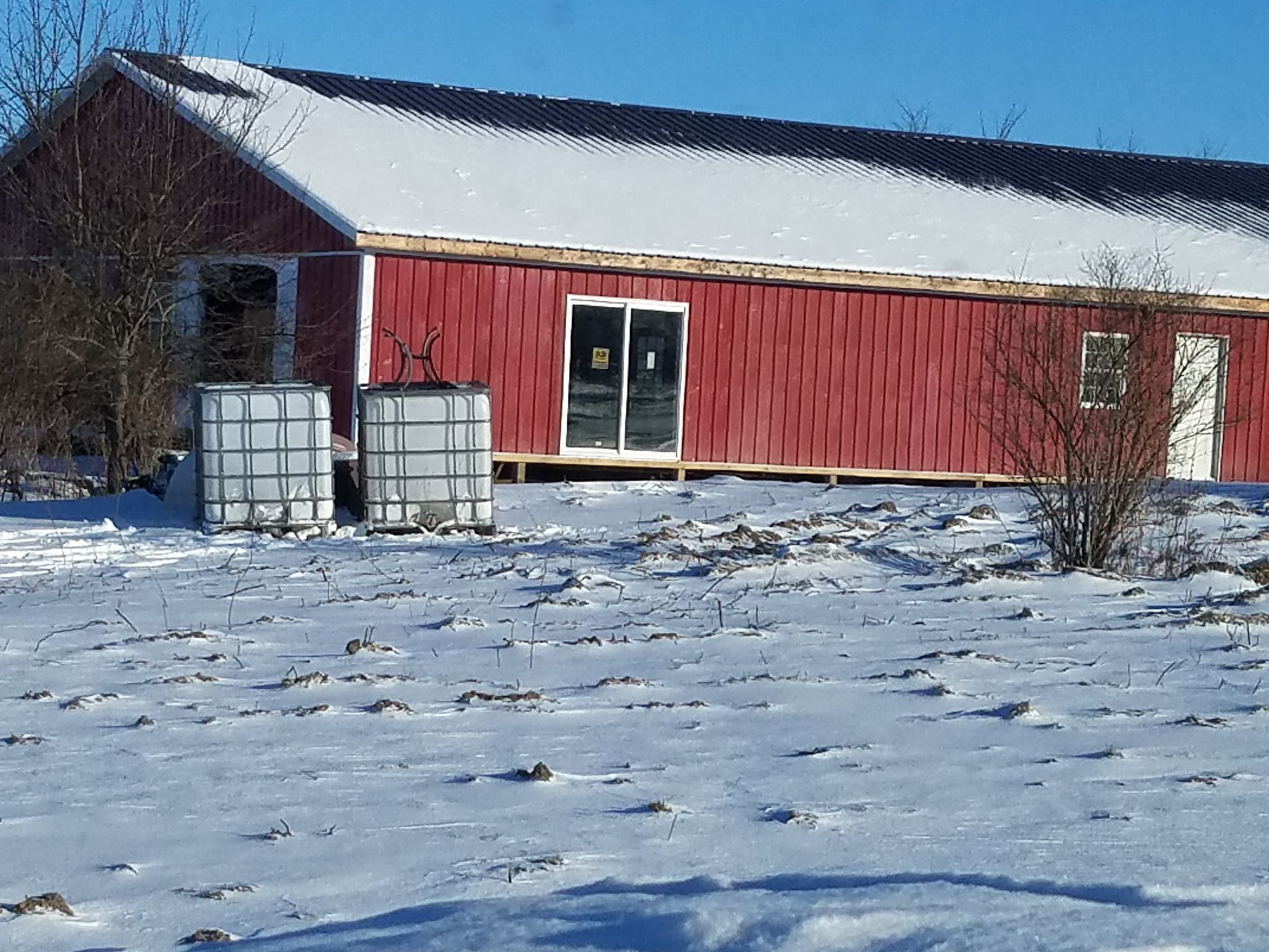

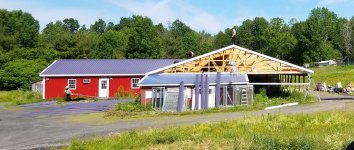

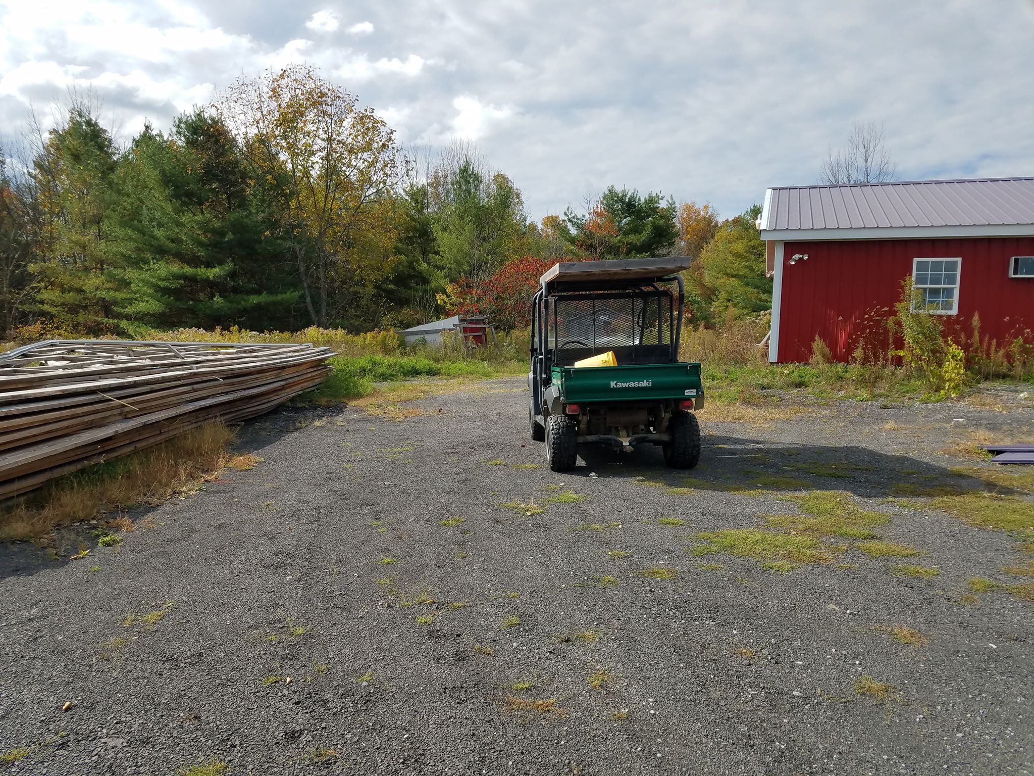

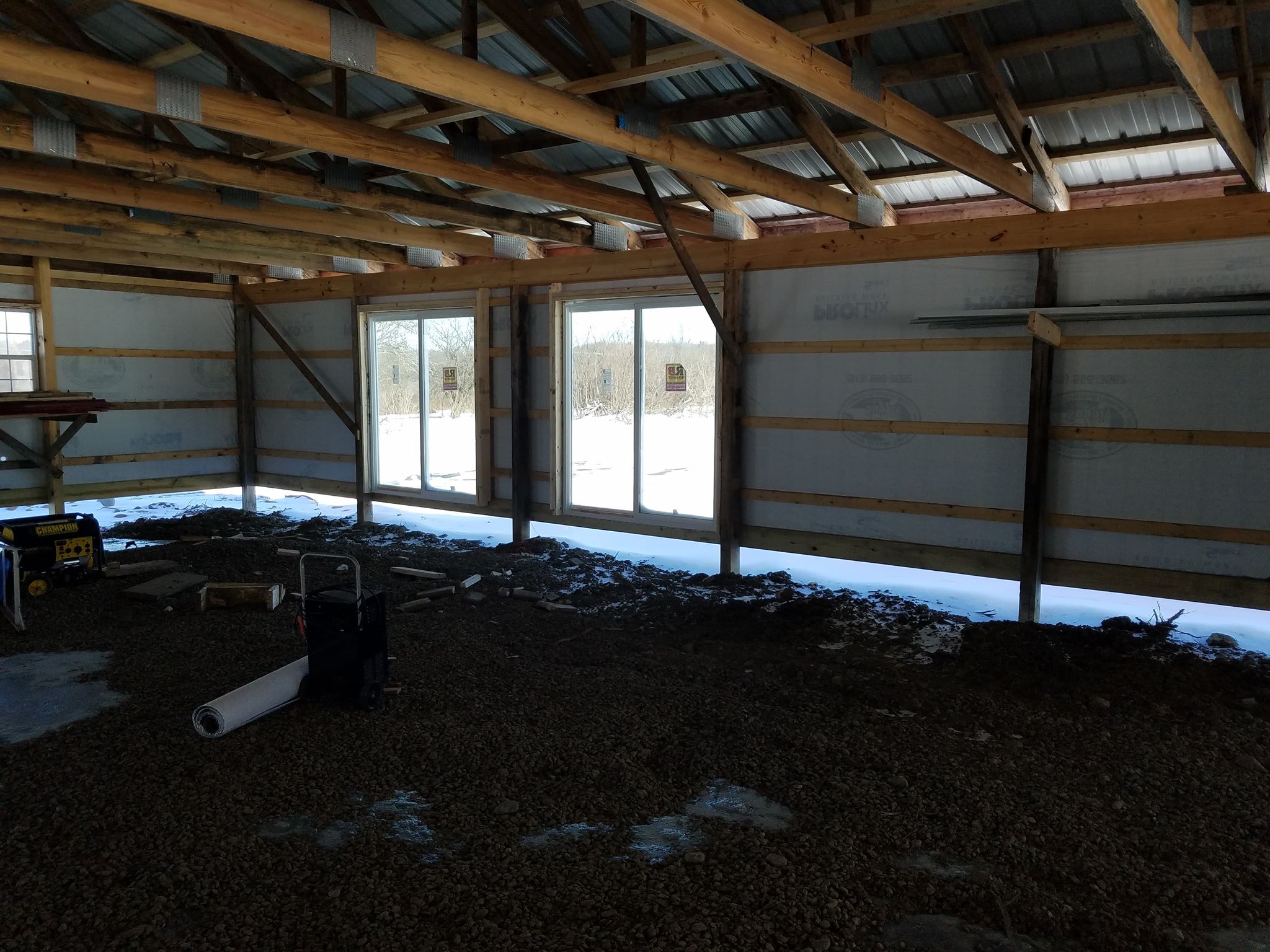

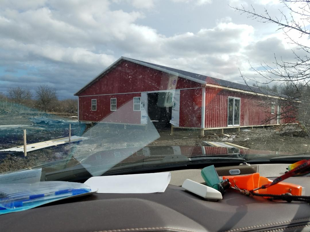

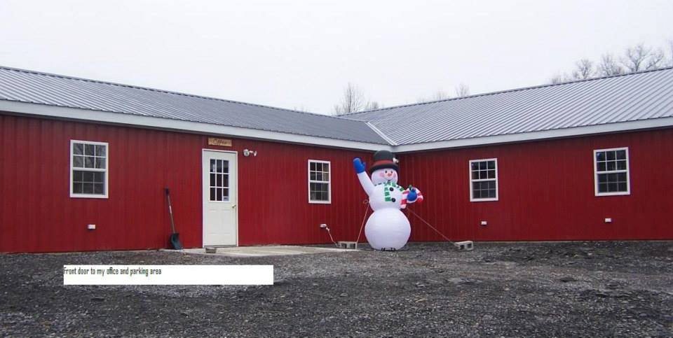

Updated project pictures have 200 ton of crusher run before the concrete pour. By the time I took barn down and transported it and put it back up again if has cost me $1 a square foot. barn is 48 by 88 4224 square feet. The picture is not clear as I took it thru truck windshield.
I could not predicted how much building materials were going to go up when I started this project pre COVID back in 2019. I did buy the 3 sliding glass door as it lets more light in the door and I prefer to frame in 1 door as opposed to doing 3 windows. But when we took all the metal for the ceilings and I can use in my garage area man am I glade I did this. We still have at least 3 to 4 tons of metal still left over so I can use on other projects. Want to build a shed roof for me new toy hauler to park under I will live on the the toy hauler in summer until barn is completed. My plan is I work from home as an IT project manager I plan to spend winter in Texas and summers up here.
When the Amish took barn down they saved all the electric outlets, all the pex fittings, all the lights, fans, doors, windows, they even saved the light bulbs from the shop lighting in the barn.
The apartment will be 28 by 48. The garage will be 18 by 48, The over hang space which will have 3 sides eventually only gable end open will be 40 by 48. Everything under one roof, clean off my truck in the winter, no carrying stuff up steps. Have not had a attached garage in 14 years will nice to walk into garage for something i need instead of going out to barn. not far but 150 feet is a pain in the neck when winter time.
But will building materials being so much I think this is good alternate route if you have Amish close and a friend with a tractor trailer to move trusses 18 miles away. Many people when I first posted this thought it was not worth doing.
