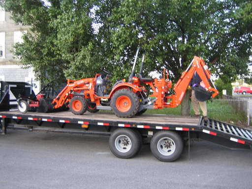

Another thought is using a stump bucket for the brush and small stumps. I bought one and it works real well on Autumn Olive. I don't know how the root structure is on the Manzanita, but it should work and is much faster than a backhoe.
The stump buckets run around $325-$375. Also very useful for tree transplanting/planting. And for getting rocks that are partly buried.
I'll add a link to a couple of manufacturers.
Mid-State Attachments: http://24.199.170.181:82
Unlimited Fabrication, LLC: http://www.rootgrapple.com
