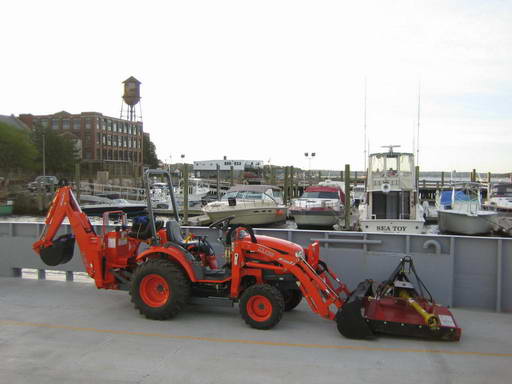

Miles 2 go,
As I am on an island, even if there was a dealer on the mainland ferry docking site it would still be a hassle to transport the tractor to a dealer. There are at least three dealers within 90 miles of where I would land the tractor so that does not seem to be a huge issue. I have not had to even call my dealer about service issues yet but know that he is very responsive generally so I'm not concerned. As part of the internet age, there is also the possibility of getting parts etc from TBN savvy dealers.
To expand on this point, it is obvious that Kubota and JD have much larger dealer networks. Additionally, those dealers tend to be much larger than the typical Kioti dealer. There are some large Kioti dealers but I think it is true generally that at this point in history the Kioti dealerships are often small. There are advantages and disadvantages associated with that which should be taken into account. I think it matters most to determine what your comfort level is with a particular dealer. Dealer quality may well not correlate directly with size. My dealer was happy to arrange to deliver my tractor to the ferry dock (wee hours of the morning) so he could go over operation with me and still allow me to get on a 6:30am ferry). I have faith that he'll figure out some way to help if I do need service even though I am isolated.
Now, on to ground clearance and stability:
Ground clearance on the CK20 without BH is about the same as the Kubota 7510 or 12inches roughly. The KB2365 hoe subframe does lower that by about 4-5 inches along the longitdinal rails (not everywhere). I have never hit anything with the subframe and I work in a hilly area with lots of stumps. If I did hit something, it would be only the subframe (fairly massive) that hit, not a plastic oil cooler cover or filter etc. The angle of departure seems perfectly adequate too. I have attached a photo of the tractor with BH on a trailer. You can see the subframe (grey) and the angle of the ramp. No problem on or off.
The tractor seems stable to me and is certainly not tippy. Wheel base (by this I mean outside of tire to outside of tire) with my R4s is just shy of the 54 inch FEL. I am careful on general principles regarding slopes but I haven't experienced "pucker factor" any more than I did with my Sears riding mower on the same slopes. I would assume that the BX series is more stable generally as it is lower but I think the BX is exceptional in this sense and the CK20 is a typical CUT stabilitywise.
