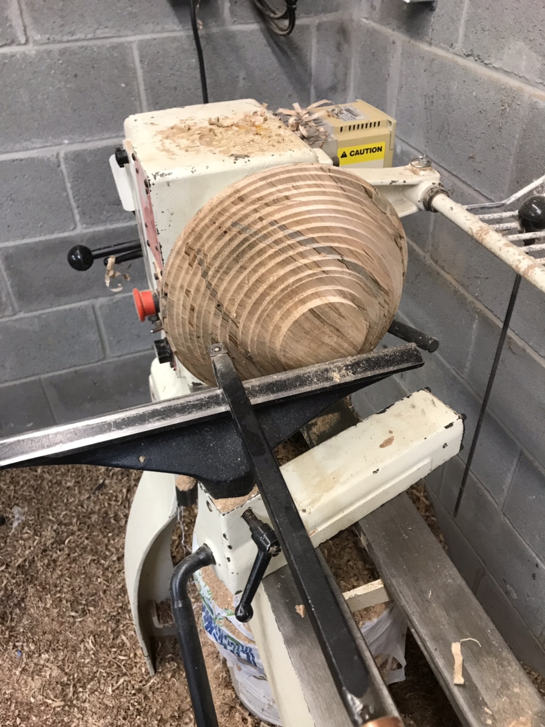

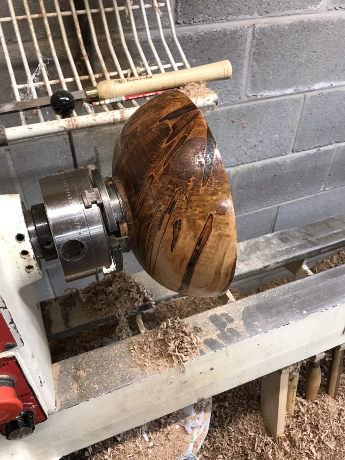

I helped my brother turn a bowl today. I’m not a huge fan of carbide tools, I can get a much better finish with HSS tools but the carbide scraper sure does rough out a bowl fast. And the last picture is some stuff I made a couple years ago. IMG_8556.JPGIMG_8557.JPGIMG_8574.JPGIMG_8562.JPG
   / Todays shop time. #962
A relative novice speaking here, but I'm becoming more a fan of carbide edges. Yeah I use and sharpen HSS gouges frequently, and remove a lot of material with them, but the little carbide inserts have yet to fail me for intricate work or for hybrid material turning.

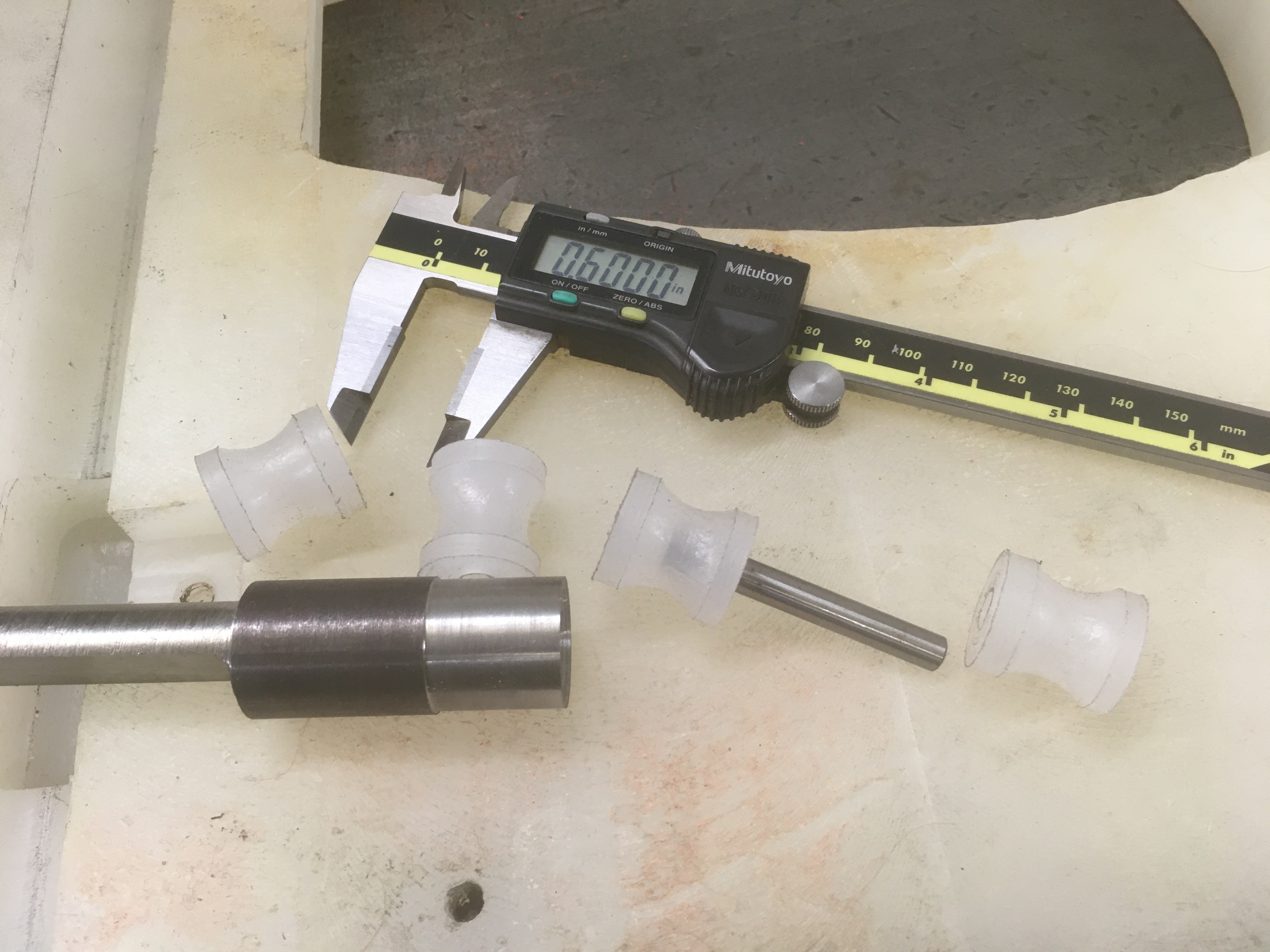

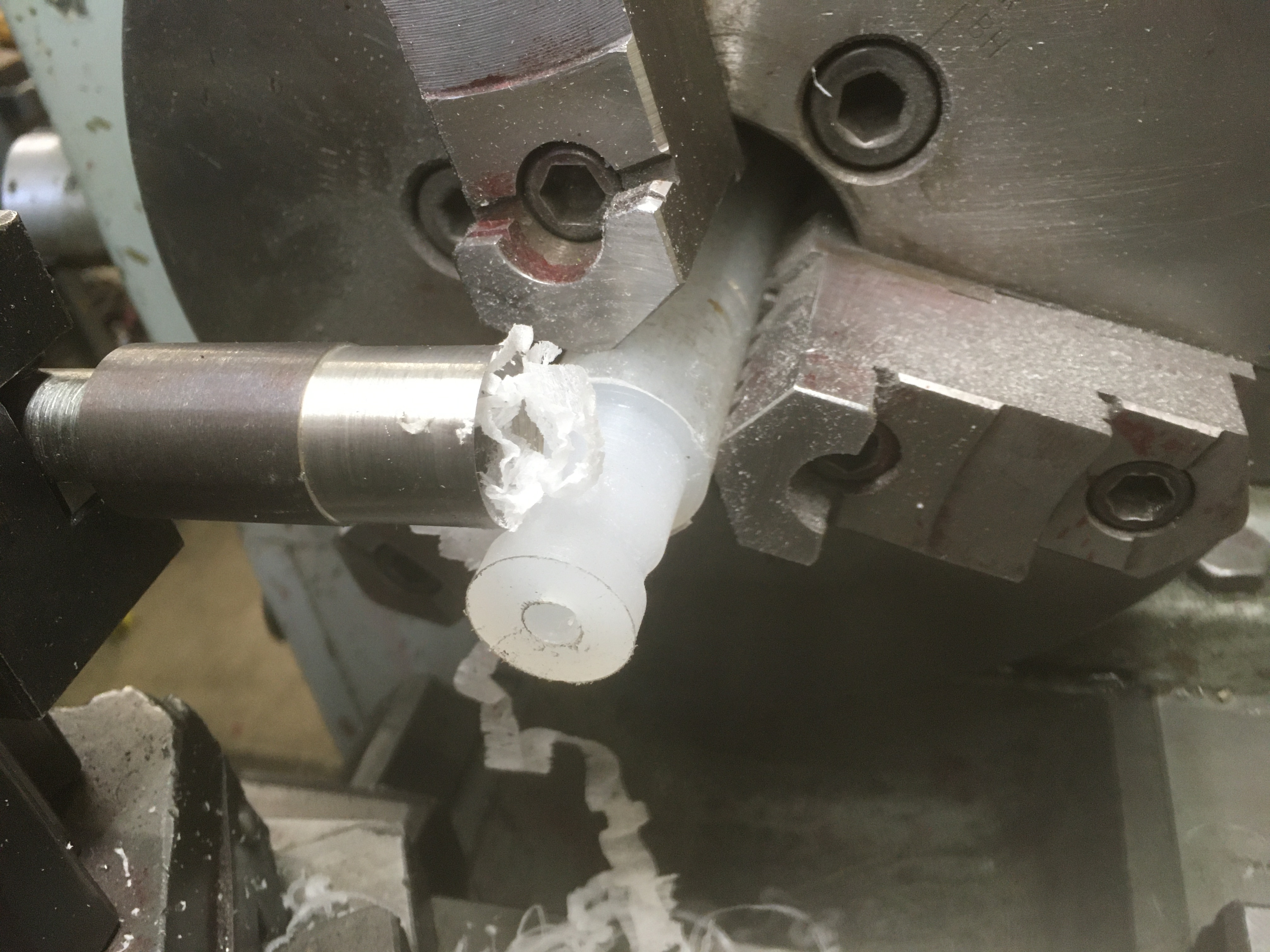

Simple project compared to some of the other projects I see done on here. I needed some rollers for a transfer chair. I took the chair apart a couple years ago and couldn't find the original ones so I made some new ones. But, I did find the skiving tool I used 25 to 30 years ago to make the original ones so that saved me some time.
It took 2-1/2 hrs to do the layout, figure out the process and finish the first one, then 45 minutes to make the other 3. No tight tolerances (+/-.005) were needed on these so it was pretty quick to do. Naturally, I made these last Saturday afternoon and found the others Sunday morning. Oh well, it was good practice. Skiving tools are a great way to cut in special shapes when needed.
   / Todays shop time. #965
Very nice and clever way of cutting a radius! :thumbsup:

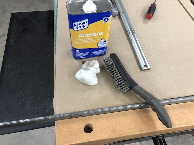

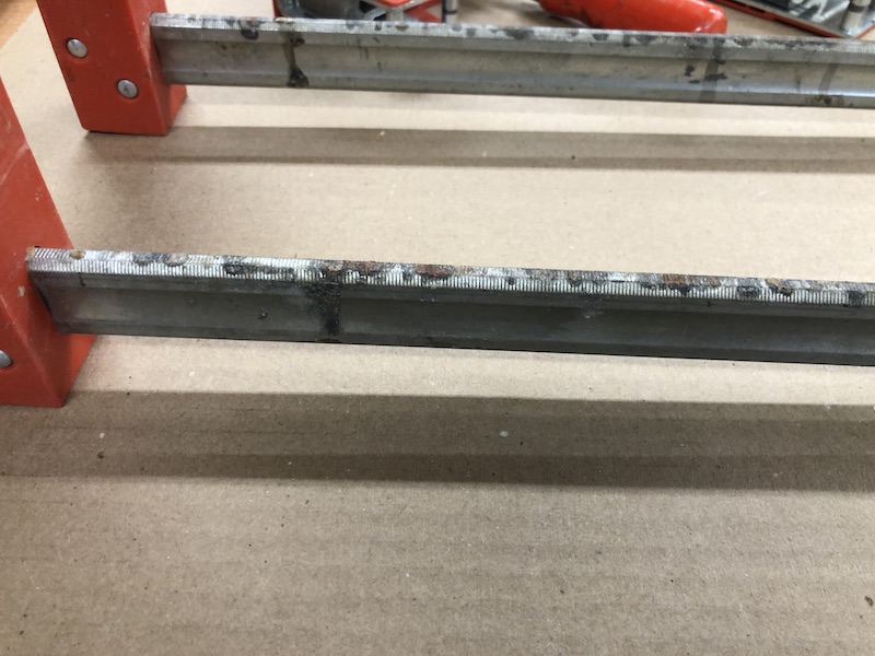

Maintenance time this evening. Getting tired of my parallel clamps hanging up because of the glue residue on the slide rails. Finally decided to deal with the worst offenders.
A chisel (that isn't my best), some Acetone, a wire brush, beeswax, paste wax, spray lubricant, and some elbow grease. I disassembled and clamped the clamp bar and got on it. Cleaned up and waxed the rails and the acme threads in the heads and re-assembled.
Wow... now these slide better than new... no kidding. Takes about 10min per clamp and SO worth it!
