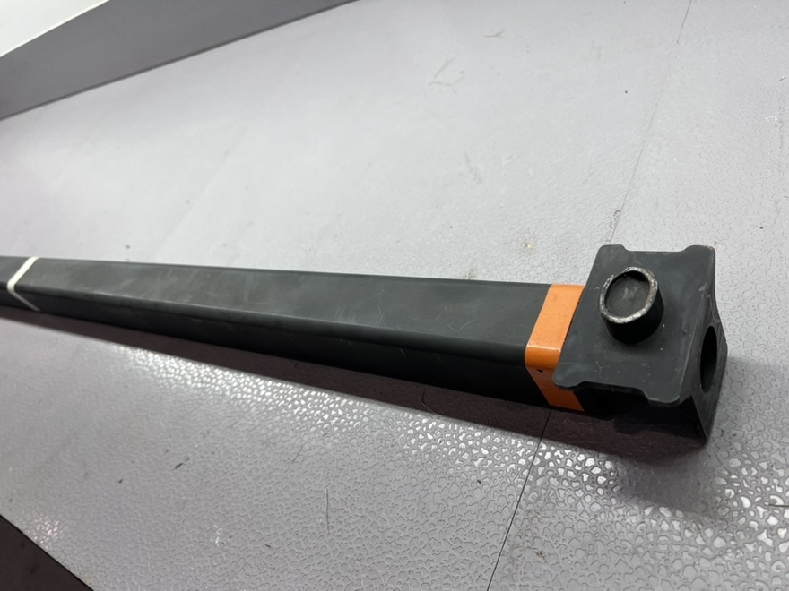

Hi, all - been lurking for a bit as I'm helping an older friend of mine with a tractor project and been getting info we need. However, I'm trying to figure out how best to accomplish something and would like materials advice.
Recently, I came into possession of a mid-rise lift. Specifically this one:
While it has the weight capacity for the vehicles I want to lift with it, the lifting surfaces are too short for a couple vehicles to be lifted safely. Specifically, the lift deck is 53 inches long, while the car has jacking hardpoints that are 77 inches apart and there are no other closer points at which it can be lifted or supported without damaging it. These hard points have hard pads with locating pins that stick down below the rest of the vehicle; the pins are such that they will fit in a 1" hole. The car weighs about 4500 pounds.
What I want to do is make a pair of bars from square tube to place under the car longitudinally, such that the car can be safely lifted by the hoist's lifting surfaces. Something similar to these, which are made by liftbars.com for Porsches (they won't make custom stuff):
I propose to make them out of 2"x2" or 2"x3" (longer side parallel to the lifting surface) square steel tubing, but I'm uncertain what wall thickness to use to safely support the weight of the car without coming into contact outside of the four hardpoints. I have had some people tell me 1/4" wall tube is best, but I have had some people tell me 1/8" wall tube will work just fine in this application. Any opinions would be appreciated.

1/8" wall is not enough. Do you plan on using these lifting bars with that lift you pictured?
Balancing 77" on top of a 53" support distance does not sound very safe. I'd be looking for 5/16-3/8 wall and if you can scrounge up some 2x3 tube, orient the 3" dimension in a vertical direction.
   / Lifting Bars - What Gauge/Thickness? #5
With those porsche lifting bars, they are lifting one side of the vehicle with a single jack in the center, and you can see the bar flex (note that with no load, the bars appear to be designed with a dip in them to accommodate that flexure).
In your case, using your 53" lift under the 77" bars, presumably you would be lifting the whole vehicle at once, with 12" of overhang off each end between your lift and the lifting points on the vehicle (here assuming the vehicle's balance point is centered between those lifting points).
At 4500 pounds, that means each or your extension bars is cantilevering about 1125 pounds that 12" out from your lift. I think you will want a thicker wall tube than 1/8"....

Another item I forgot to mention - when the vehicle is sitting on top of the fully-collapsed lift, there's only enough space to fit a 4x4 between the lift top and the car's jack points and even that is barely possible. I had also had the idea of possibly being able to also able to use the bars without the lift, just as the Porsche-intended product is.
I'm somewhat sure that the balance point is more forward biased, to the point where I was half-suspecting the safest way to use the bars would be to put the end under the front jack points onto the lifting surface so that the overhang would only be off one end.
A quick check of one local welding steel provider shows that the thickest 2x2 they offer is 5/16, 2.5x2.5 goes up to 3/8. Would either of these work?

looking at the Porsche units, they deflect until they hit the floor pan of the vehicle. If yours will do the same and actually transfer load to the floor pan seam, then the 1/8th wall tube would probably work just fine. I'm traveling, and don't have access to the books I would need to refresh my memory to give a solid answer. recommend buying actual steel shapes over using a fence post. The steel in such things is always suspect in my mind.

Tubes are not efficient in bending. I would recommend a W5 grade 50 steel beam. Yooper Dave
   / Lifting Bars - What Gauge/Thickness? #13
I have a set of those lift bars for my Porsche, the walls are 6mm thick. They do flex when lifting one side of the car.
