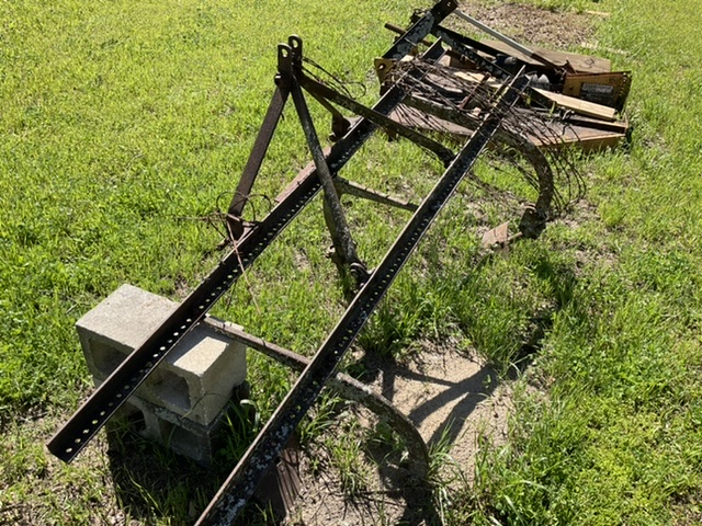

In your original post, it's the 4th picture down. Date in the corner is Mar 7 2012. The picture shows the beta version when I was playing with the idea. A piece of 2" square is temporarily sandwiched between the upright, and the pipe to hold the cultivator shank. There are 2 nuts welded to the pipe to grip the shank.
The ground where our gardens are slope towards a swale. We use tote tanks to haul water in from the river. Open the valve and let it flow seems to be just the right rate to allow water to flow and soak in the rows. Typically, we get plenty of rain early on, till about June for the first crops (potatoes, green beans, cauliflower,etc). Only have to water the blackberries, raspberries, pumpkins, indian corn etc.
For your lower pins of your 3-pt hitch - it's 4" x 4" angle that you used for the pins?

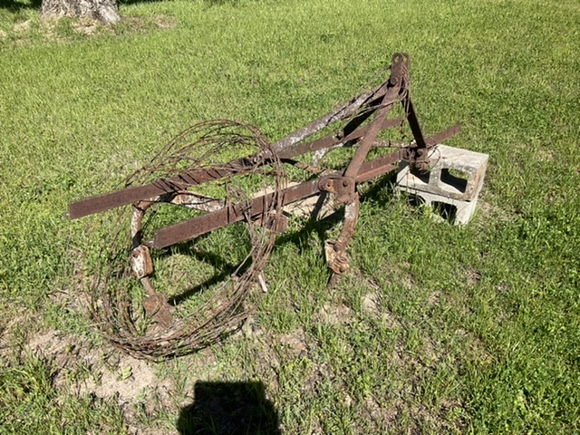

Before toolbars came along cultivator frames were used by farmers. I have a couple of six footers. They can be found around here in scrap piles, fence lines, or junk yards pretty cheap. Holes are at 1 inch spacings. View attachment 738362View attachment 738363

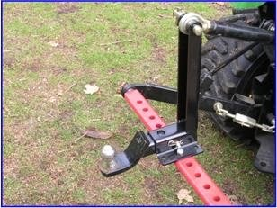

When the neighbors Toro Zero-Turn died, I got the ROPS, but we couldn't find the hinge plates. The ROPS were of no use for him, so after he bought the Toro, he took them off immediately.
My plan was to make a DIY hiller from these Toro parts shown below. The width of the ROPS loop fits within the rear tire pattern of my machine.
Then using the bolt on hiller discs it's almost ready. I just have to be keen on the 3PT attachment

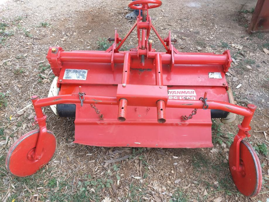

On many of the Japan made PTO tillers, the hiller could be manually put into place and angled as needed. It's rare to find these tillers with the hiller discs in North America.

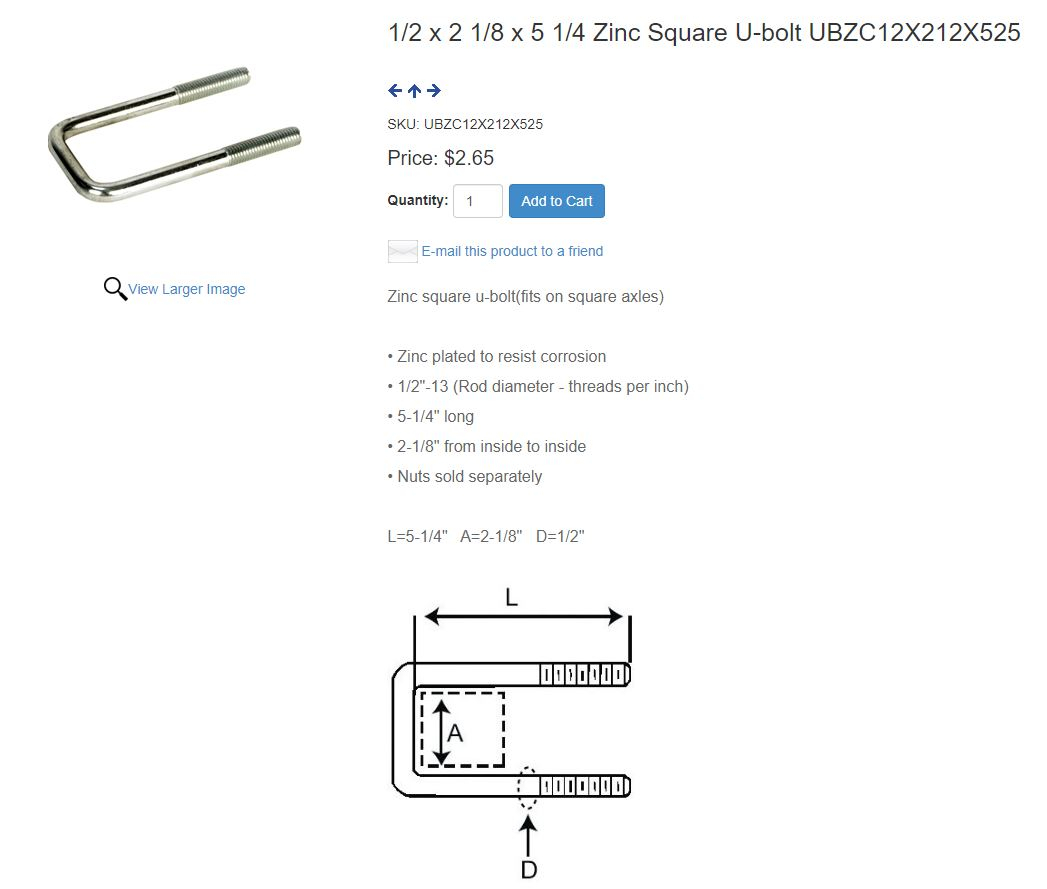

The 2"x2" bar - U-bolts for connection plates - were you able to use a 2" U-bolt (2" inside the legs) or did you have to go up to 2-1/16" or 2-1/8" between the legs? I'm afraid the 2" u-bolts won't clear the 2"x2" bar. What's your experience?
Two options I've found, if I have to go more than 2" - I'm thinking the Galvanized 2-1/16" between the legs would work best - any thoughts on that?

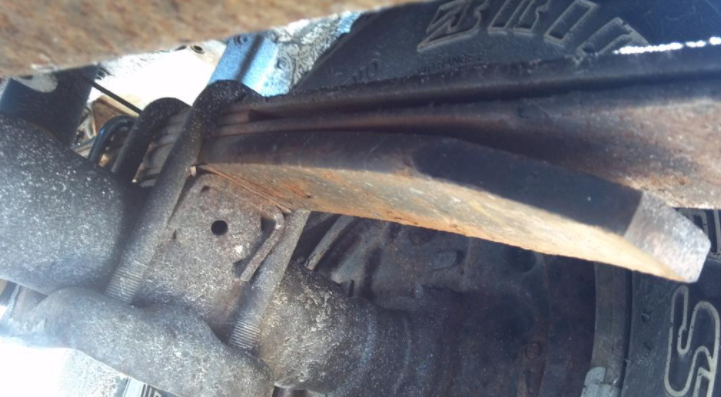

For the price, those look like Grade-2 strength exhaust U-bolt hanger types. Wimpy overall.
Grade-8 for the application is needed. Some are listed as 8.8. These are heat treated and coated.

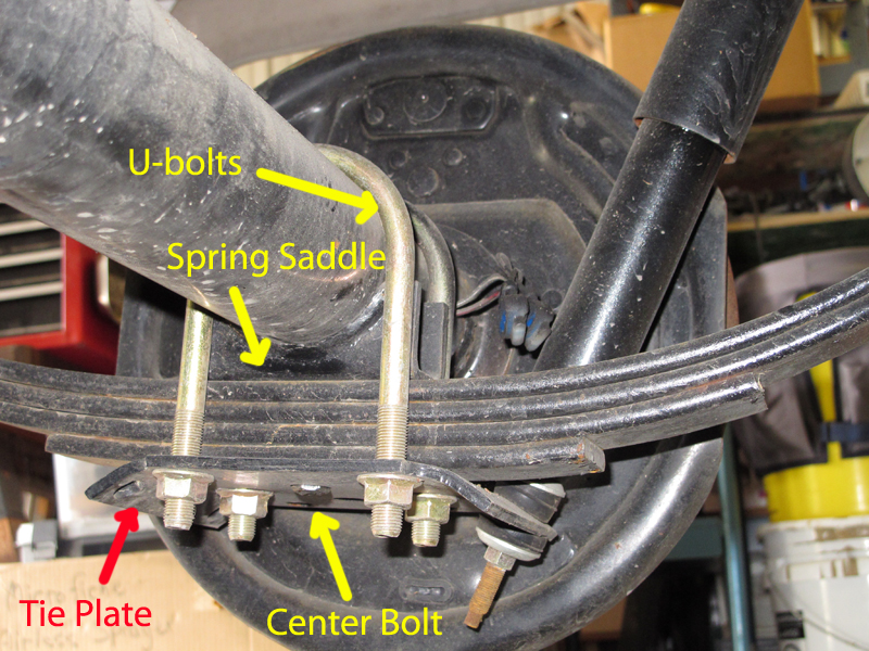

These types of U-Bolts are the automotive grade to clasp down leaf springs. These would run about $10 to $18 each.
Even enclosed cargo trailers would use the higher strength Grade-8
Boat trailers uses stainless.
Ford F-150 uses the 2.25 wide sq U-bolts if you need wider.

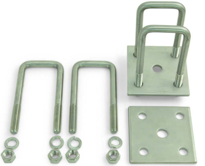

I went with these 1/2" diameter galvanized ones, which are the same ones used on my boat trailer with a 2x2 square axle. Should be more than ample strength with 1/2" diameter.

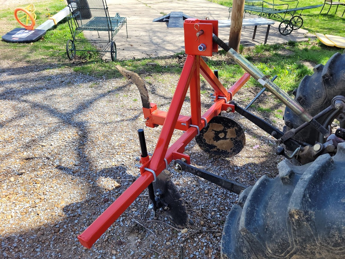

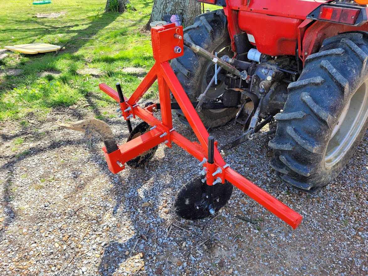

Yeah, you can use grade 8 or whatever you think you need. I just made what was needed using some grade whoknows 1/2" bolts and some scrap pieces of 1/4" diamond plate to make the brackets. It's what I had in the shop, and is plenty tough enough. Welded the pipe to a 3"x5" piece of plate, and cut 4 pieces of the plate into
1 1/2"x5" straps. Maybe this picture shows the brackets better. I did use u-bolts similar to what you show for the cultivator shank mounted on the 3 point upright. Again, more than strong enough for the application. Hope this helps.
Edit: I need to correct some dimensions from my earlier post. The hiller crossbar was fabbed to 44" to fit inside the 48" footprint of my old 50 8N. I now have a 66 1020. It has a 5' center tread to center tread width. In both instances, the width of the hiller to tread width allows for cultivating the rows. Important for weed control, and in potatoes hilling or laying up in the rows. You're driving on an established tire track which is easier to keep 3 point tools on track and not digging up crops.

How tall is that mast (the vertical 2x2 going from the bar to the toplink)?
   / Homemade Tool Bar for Garden Bedder aka Disc Hiller #32
25". With the lower pins located an inch below, or centered on the cross beam, this put the top link attachment at 26". IIRC that's a typical category 1 3 point standard. Sorry, I meant to put that measurement in the last post. Hope this helps.

If you can't easily find the right U-bolts, just us a flat plate with 2 or 4 holes, and common hex bolts.
Bruce

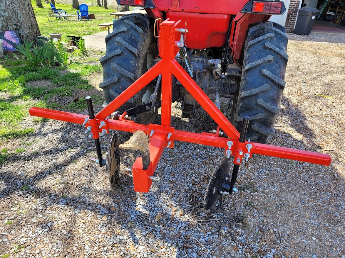

Got it made! I've already used it to hill up my mounds in the garden, and planted potatoes with it. The ripper shank makes a nice little furrow, might add a small sweep onto it to get a little wider, and I can just flip it over out of the way when I make a pass to cover up the potatoes. Ripper shank also makes a nice support to keep it standing up when not in use. Very very handy thing to have! I think I may get some clamp-on S-tines and use it as a cultivator as well this summer on sunflower fields.
Steel - $200
U-bolts and pins - $40
Hiller disks, 2 ea - $130
2"x2" square tube is 1/4" thick
Plates/flats are 1/2" (probably overkill)
Angle for lower pins is 1/2"
U-bolts are all 1/2" diameter

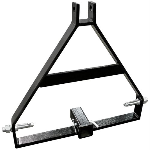

Your setup is over $500 for the hiller set up. Would it helped to just buy a 3PT bar and mount the hiller discs?
It's hard to beat a $325+shipping price over DIY.
Garden Line Row Builder
Looking at the present prices of post-C19, the 3PT bars are now insane. That link above is golden. It's not price spiked like things have gotten.
A simple 3PT bar from TSC is now above $260 on up.
