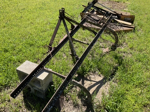

A number of years ago I built two 3pt tool holder frames.. And a number of attachments for the frames.. It worked well..
First... At the location where you want the hole, drill a small hole first.. A hole about the size of the center tip of the drill.. A pilot hole, 1/8 or 3/16" will make it easier to drill the full size hole on location and to size easier..
Use drills the size of the hole you need.. For instance, for a 3/4 " hole, use a 3/4" drill.. It will usually be big enough to let a pin through..
The trick is in lining up the holes to get the pin through 2 tabs..
You were right on the money about the holes, like for a 3/4" hole you use a 3/4" drill bit. You were also right about lining up 2 tabs - I had the pin in the holes when I welded the tabs on, the pin helped with alignment but even then it made for an extremely tight fit as it still was off on alignment by just the slightest amount making it hard to pull the pin in and out; I ended up drilling those two holes out by an added 1/16" and it made a world of difference, the holes on the tabs were the only holes where I went up a size. The "Silver And Deming Drill Bit Set, 8 Pc." for $32 with coupon at Harbor Freight was well worth the price, the kit had bits from 9/16" to 1", using those with a drill press on a slow speed and applying lots of cutting oil made quick work of drilling holes in 1/2" thick metal.
I really like those 3 pt frames you made, I can think of lots of uses with those!
With many years in the tool and die trade holes, threads tapped and turned and the like were some what my specialty...
I found to use a 3/4 " drill for the holes in the tabs.. Bolt a bushing between the tabs tight then tack in place and weld with the bushing in place.. When hand cool, all would come apart and a pin would go nicely.. It doesn't take much use for the holes to accept a pin freely..
