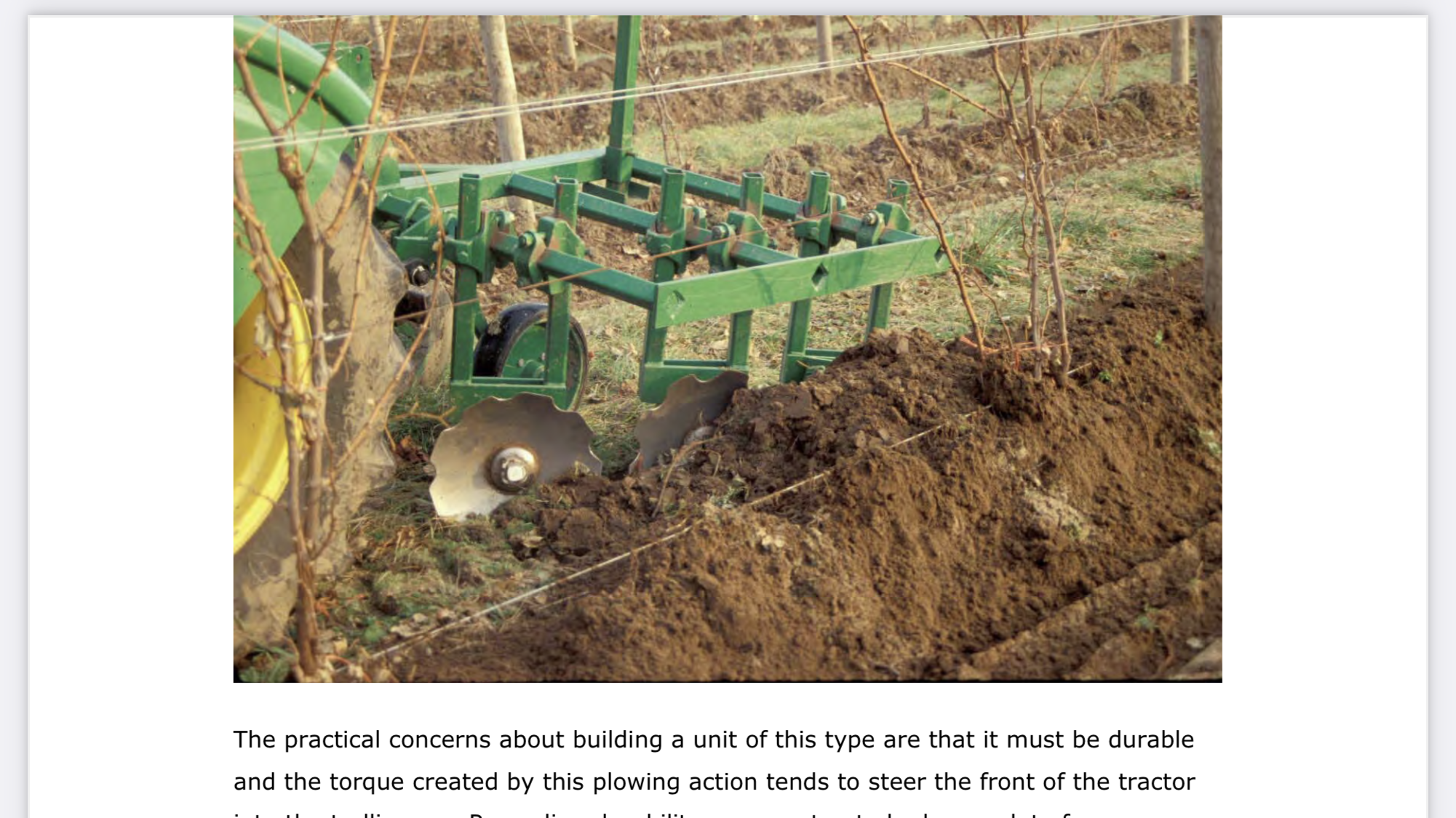

I’ll post a build thread (if it works) but I’m building a 3 point toolbar hiller to mound up soil around my vineyard rows to protect vines from winter injury. I have most of it built, but I’m stumped on this bit
There are dual hillers on the right side of the tractor because the rows arent uniform enough to do both sides of a row at once without wiping out the vines on the other side. I knew going in that the tractor tends to steer into the row from the drag of the hillers on just the right side
The design I stole calls for a coulter to run on the centerline of the 3 pt to reduce the torque on the tractor. It’s supposed to dig into the soil and counteract the torque
But I’m having trouble figuring out how to buy or fab the coulter without spending a ton of $.
I thought of buying a 1 3/16” blanton hub and putting a coulter on it, but the bolt circles dont match. And ArgiSupply, etc dont seem to sell just the hiller shaft and hub. Could buy a complete hiller/shaft/hub and throw away the hiller disc, but the cost goes up. Before I kludge something up, I thought I’d ask if anybody has any ideas
The coulter doesnt need to be angled so I could just weld an axle onto 2” square tubing, but I’d need to get a hub. Any ideas how to do this on the cheap?

For the OPs situation; would a old spair tire wheel, possibly with a spring, putting down pressure, work? I would think that would resist the torque better, ans I'm sure you can find a wheel bearing, couple pieces of steel tube, and a donut rim, probably on the side of the road.

Great idea! I have some old rims lying around. Maybe even a wheelbarrow rim with a Grade 8 bolt as an axle. When I tried it out today it skewed pretty badly. I’m thinking that I’d need a couple hundred pound counterweight over the rim/coulter to drive it into the soil. I have about 150 lb of 2” heavy wall tube in the tool bar frame and another 50 lb in the 3 pt 2” receiver hitch, so more weight would help. Wish I had a hydraulic top link, but that’s another project. The rim would also act as a gauge wheel better than the coulter. Must sketch

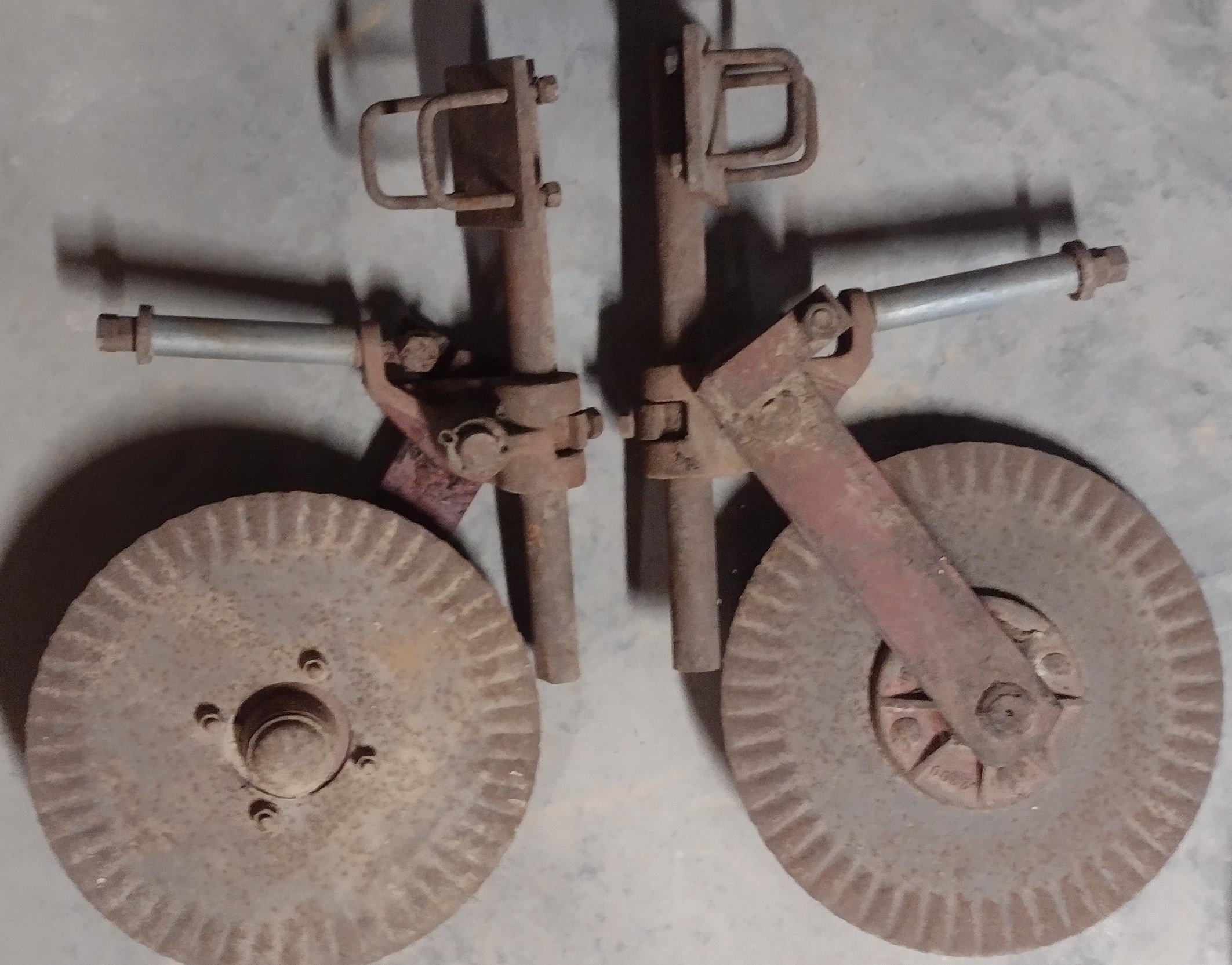

Those look like they rotate some so would not work well fir this application.
Rotate is probably ok so it will roll over rocks?

Do you think this might work? Front wheel drive cars often have a hub assembly that bolts to the McPherson strut. Many cheep chinese knockoffs on ebay
