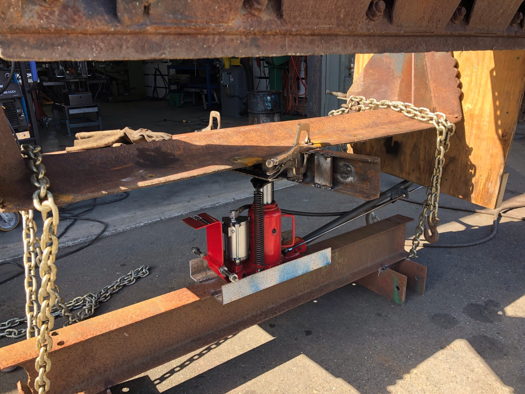

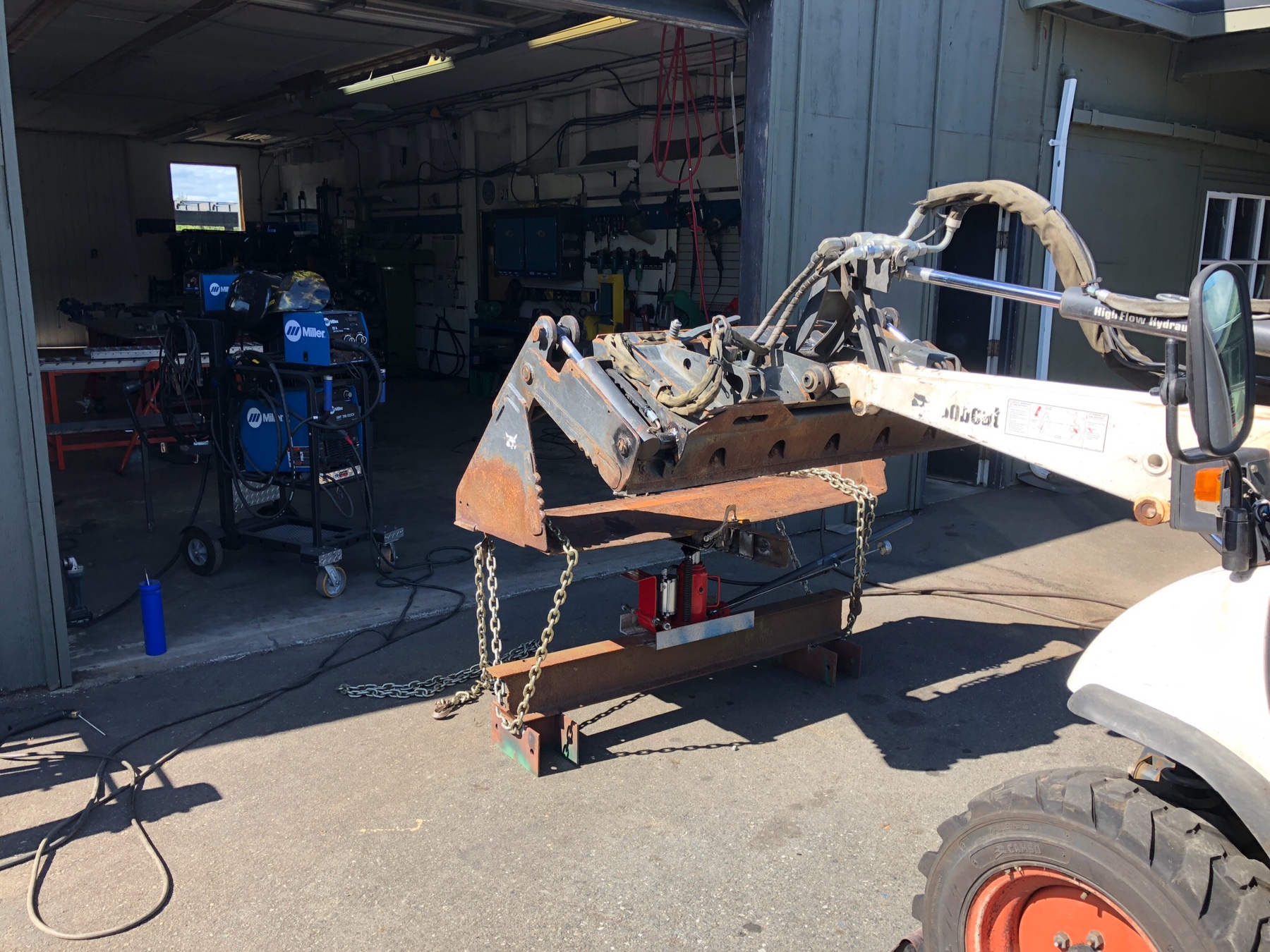

This week I straightened out the bottom of a 4in1 bucket on a machine I picked up at auction. Couldn't really tell if it was smiling at me or SMIRKING because of my purchase.
I removed the two cutting edges and used the old "I beam, chains and hydraulic jack" method. Probably could have used the machine's hydraulics but figuring out chain placement geometry seemed a little too taxing for my overheated brain.
Anyhow I got'er done

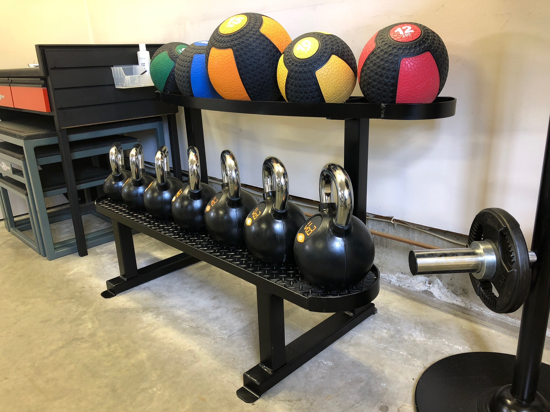

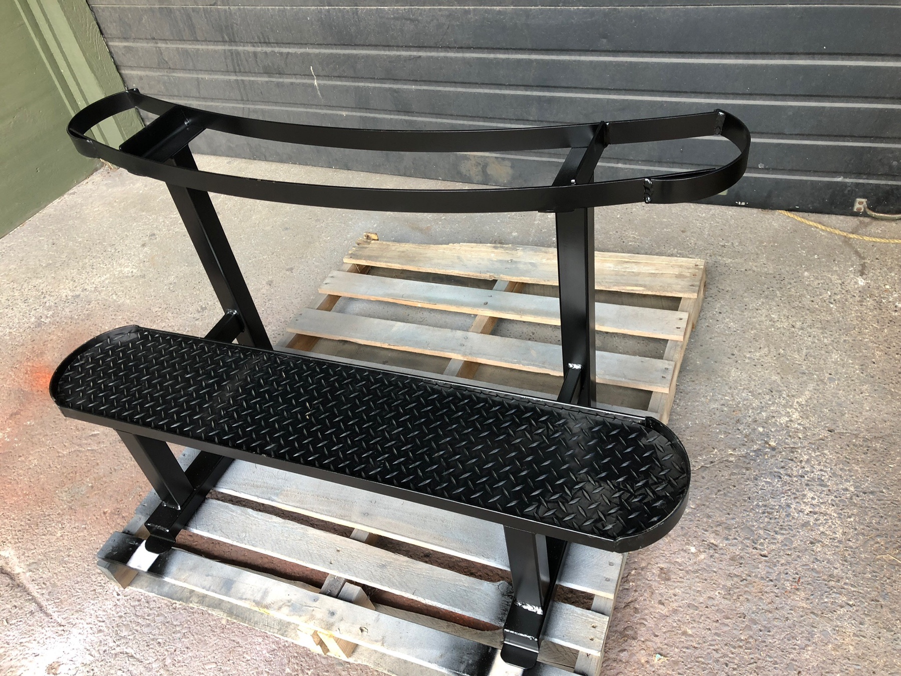

Also had to make this rack for medicine ball and kettle bell storage.

Nice job on both! Thanks for sharing the jacking set up. I was thinking about it in my mind while reading then saw the photos and realized I could relax and not stress my brain any more. :laughing:
The rack actually spurred me to think about an 'industrial' design to support and disguise the music speakers next to our flatscreen. Was thinking a wood design but for some reason that rack got me thinking a properly finished metal design. Problem is... I am not much of an artist.

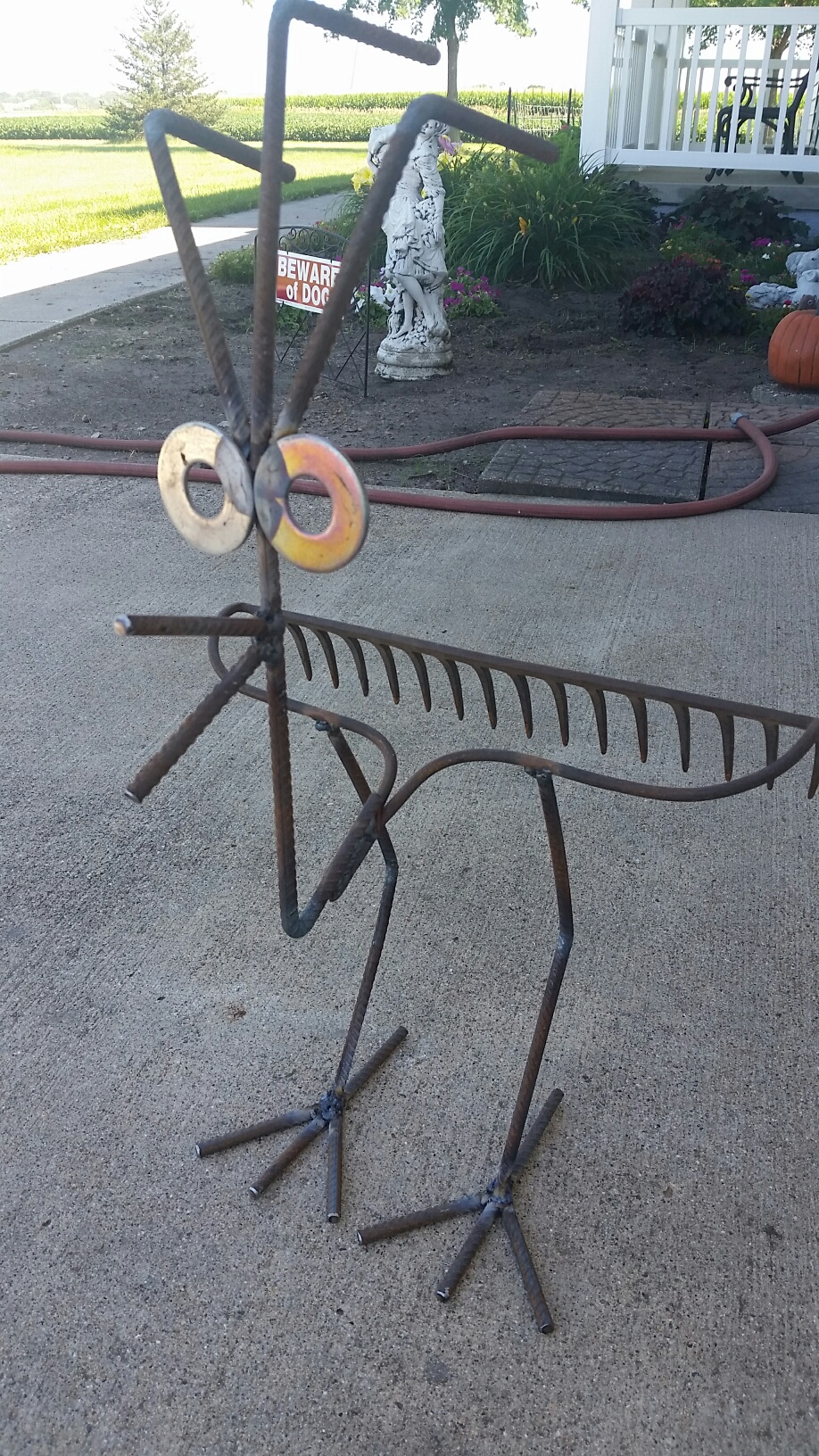

I spent a couple hours Saturday and Sunday making this bird. The weather cooled a bit and the humidity dropped way down, so it was very enjoyable. One of you guys gave me the idea ans I have been saving the broken rake for this project for a long time - thanks who ever you are.

I LIKE it, bigtiller!
